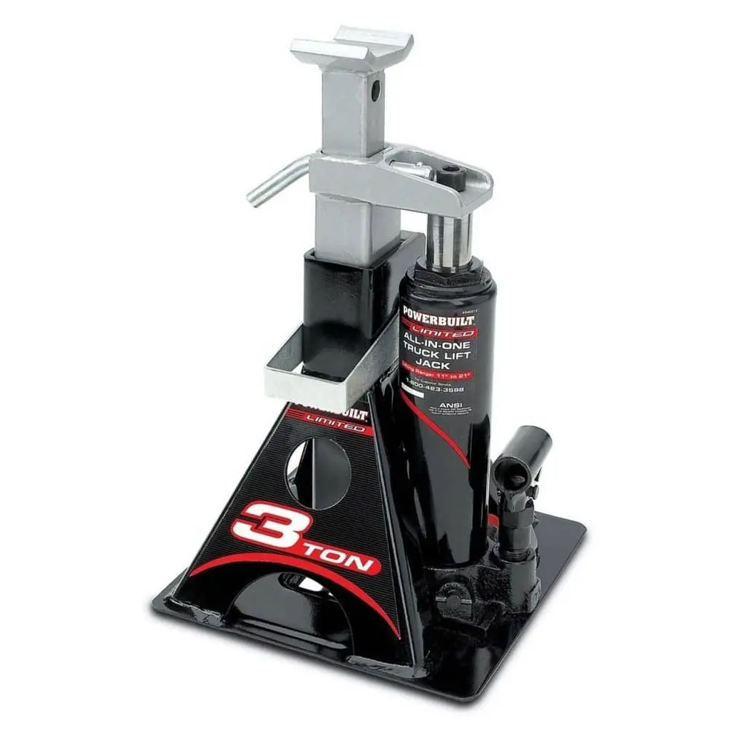

Since we are on the topic of turbos, this might be a good time to mention the best set of jack-stands that I've found to date:
(click for larger image)
How cool is that????
That is a nice jack stand lol. So, back to the 331 with kenne bell?!
