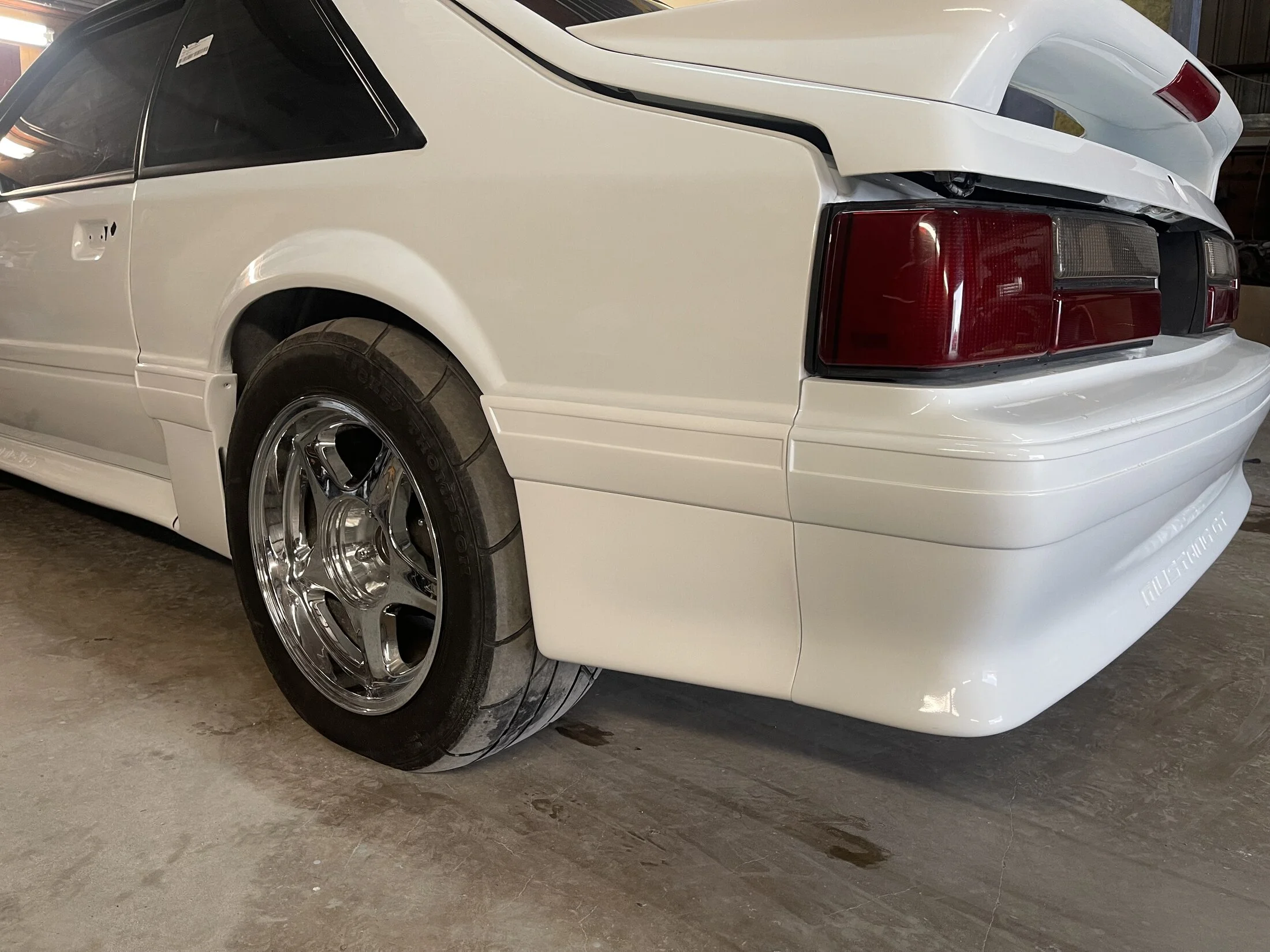

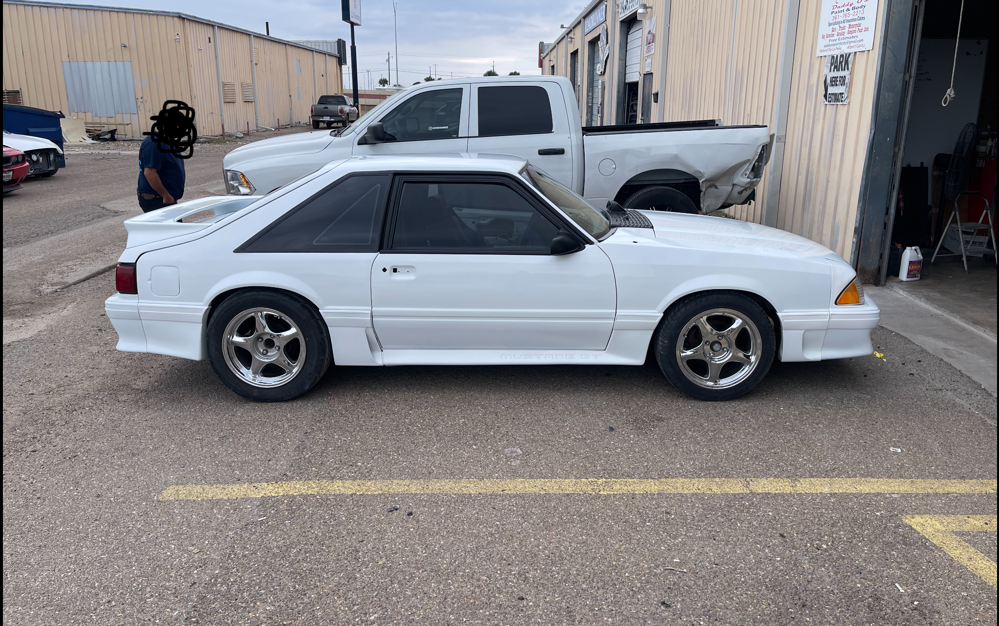

I stopped by to check on my car and I’m not happy with how certain parts of the car don’t match in color. Passenger side front bumper to fender doesn’t match and the rear corner of bumper doesn’t match fender. It looks like they didn’t spray enough white in certain areas. How do you fix it without repainting the whole damn thing. So damn pissed right now.

He tried painting the rear quarter ground effect using the same gallon of paint with same reducer/thinner and it still didn’t match. Looked like a brighter white. Have no idea how they plan on fixing it to where it all looks the same.

It looks like mostly the urethane parts don’t match, like the nose and bumpers. I would say they were either sprayed at different times where the conditions like humidity were different, or they primed them differently. If it’s just the plastic pieces it could also be that they added a flex additive to the paint for those pieces and it may have changed the color a bit.
As for the fix, he says:
“Just a respray would fix it. Don’t have to strip anything so for a body shop not a huge deal”.
Therefore don’t panic. Maybe they can fix this without to much trouble as he says it’s not a huge deal for a shop.

Yes I would say the entire car to be safe unless they know for sure what the problem was and they can correct it.
If it were me I would hit the entire car with two more coats of white then clear.

Gotcha. I highly doubt they will want to respray the whole car. They had it all torn down to paint it. I have a feeling they will just try to get the color as close as possible and paint those areas while trying to blend the color.

I've seen a lot of bumper covers that don't match the body panel paint. Even factory color after a few years. Many factors in play. Could try a respray on the areas and blend, depending on how good the painter is.
I'm not 100% sure, but maybe they can blend those areas to correct it? @95steedamustang any advice for him on how the shop should/could fix it?
Should have painted all the pieces on the same day at the same time. You have to be a top-notch painter to paint a color like that on different days. And get the same result. To fix it, they need to try their best to mimic the same conditions, whatever primer or ground coat was under they need to start there and start laying the color, same air pressure, same temperature, etc. and see if they can’t match the parts that don’t match. But if you shot that color to begin with and 15 psi in the second time, you shot it at 14 psi, it’s gonna be different. Laying more color on top of the existing color is only gonna make it match less.
Thanks fellas, I have no idea how they will correct but pretty sure they will just try getting it to match as close as possible and just blend it all in to give the illusion of being the same color. I do wish it was all painted at the same time.
