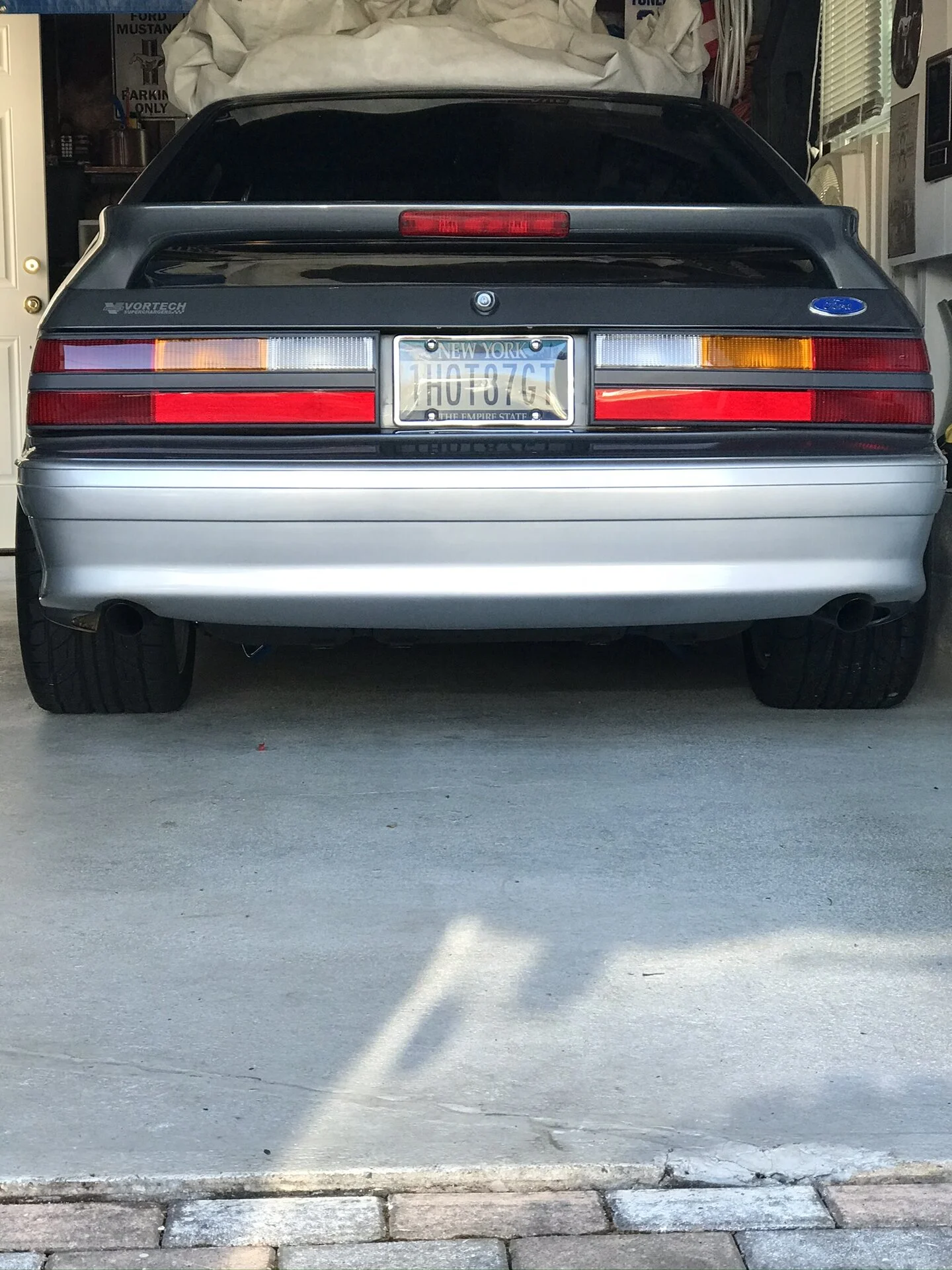

I did the same thing as Blakeus. New lenses with original housings. Same reason too, love the look of the amber turn signal. Just looks right. My opinion. Top edge is really rounded where the graters and LX taillights are more square so I could see people saying they sit ‘in’ a little further but I love the look.

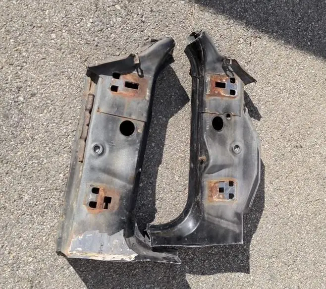

We went over everything I wanted done including some rust repair which included cutting it out and welding in some new rust free panels I had removed from a parts car. Well yesterday when I was dropping off those parts he was already gone so was talking to the owner and I guess he wasn't aware about the deal I was getting so told me, that rust repair can't be included in the $4200 price I got because his complete paint jobs start at $4500. Told me he didn't think my buddies cousin was aware of the rust. I told him yes he was and that I had showed him the rust and what I wanted done. He went on to say that it's a lot of work having to cut out and weld in making it all look like factory and blah blah blah.

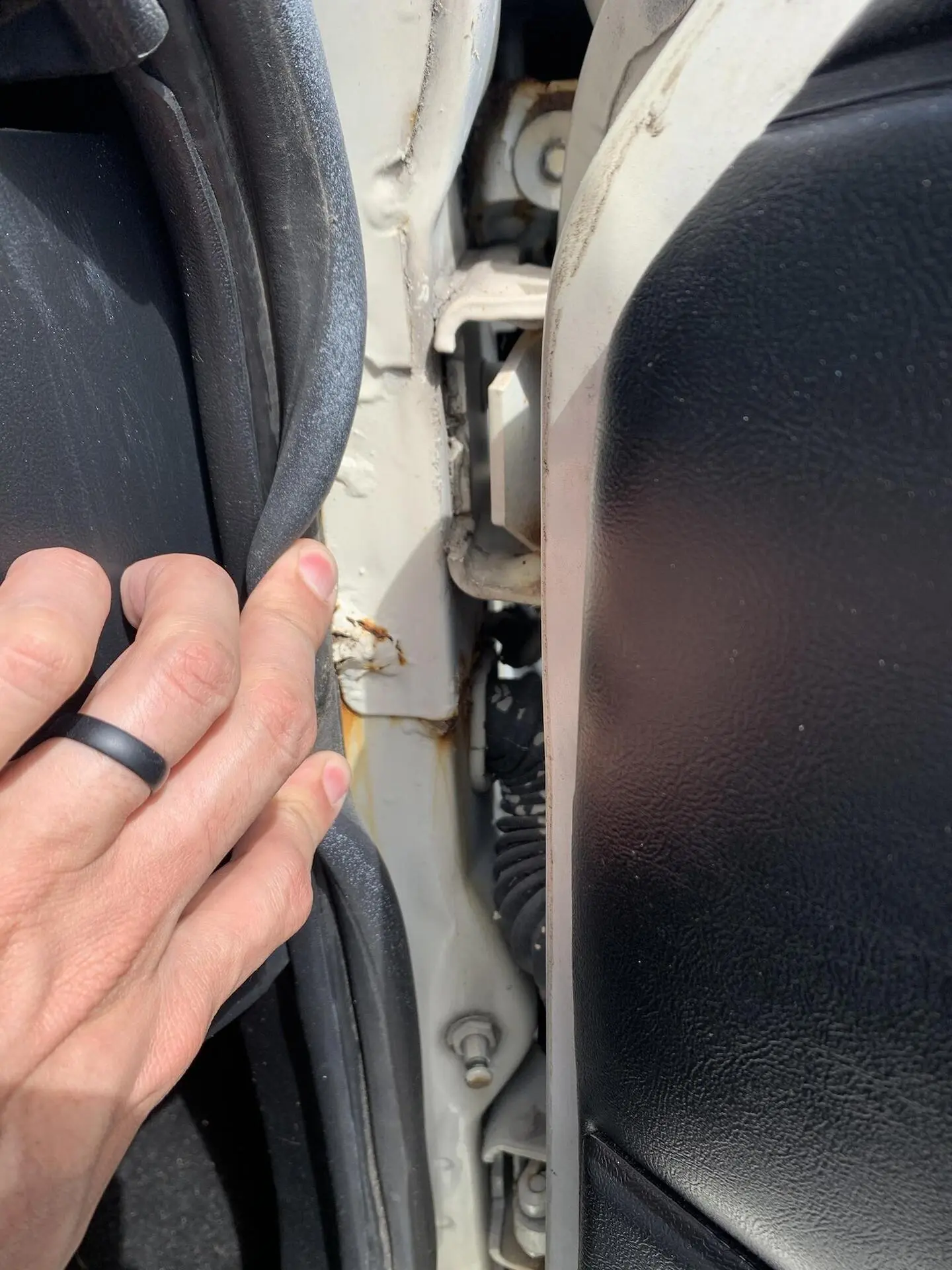

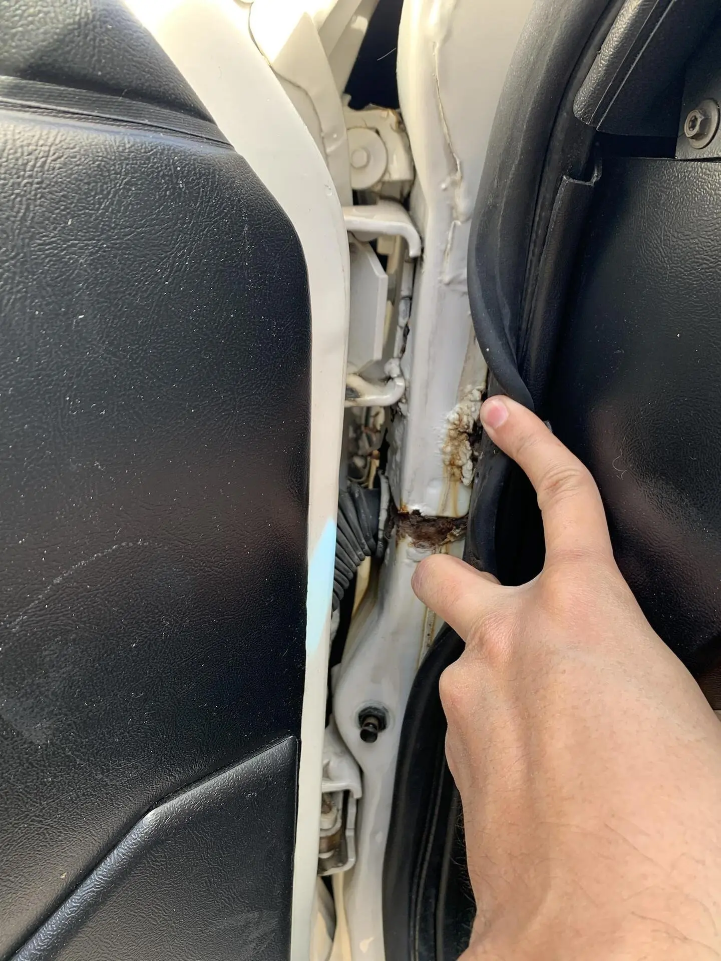

Here is the rust that needs to be cut out and repaired with the ones I got off the parts car.
Those repairs & a complete paint job (done right) for $5500 is still a pretty damn good deal. Sounds like othe guy talked out of his ass.

I get that you want them to honor a verbal quote, but if you don't have that in writing that includes rust repair that'll be tough to live up to. And that's the thing about paint/body... it's hard to know how ugly it gets underneath until you get there and things come up that will change the overall price. Also I would bet that there is more rust hiding than just the door jambs.

I agree with above comments. I’ve worked in paint and body shops since 1997. After cars are taken apart there could be other issues that arise. I had a 1990 Notch with rust like that in the door jamb in that area, turned out the aprons, (inner fender structures) were totally rusted out, along with the frame rails.
When I was an estimator, I always stressed that the costs could go up after the cars are taken apart. Wether it be a restoration type deal or collision.
I think the fenders on your car need to be removed to see what maybe hiding under them before you proceed. Hopefully there isn’t anything.
Reactions: Fri Guy
I'd be willing to bet that just replacing those pieces properly would be in the 3k dollar range, to do it right you need to pull the windshield, upper cowel, doors, fenders, wiring that is in the area and more,
The amount of work you do tearing it apart can effect the price, if they can do that repair and paint for that price would be a swing'n deal.

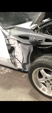

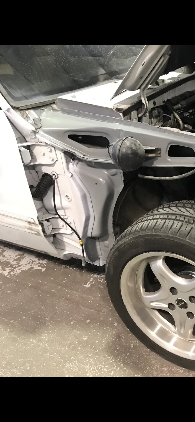

This is the area I’m talking about @Fri Guy. This wasn’t my Notch, this is my current car. I cleaned these areas up when I did my car a few years back.
