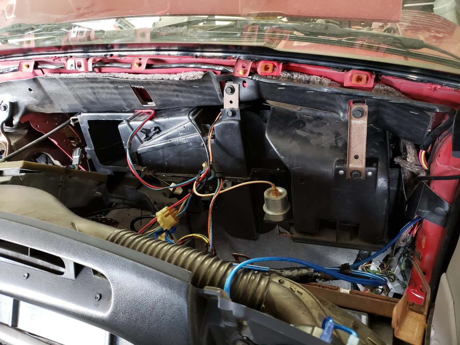

You should be able to look up at the heater box from the passenger side and see a silver vacuum module on the side of the box. I dont think its to hard to get to with everything in place.
This is a pic of mine. You should be able to get it off with out much trouble.
Now if the defrost quits.... well then you have to get to this one.
As you can see from the location it would be very difficult to get to without dropping the dash. Thinking back on it now I should have replaced both when I had the box out of the car. :doh:

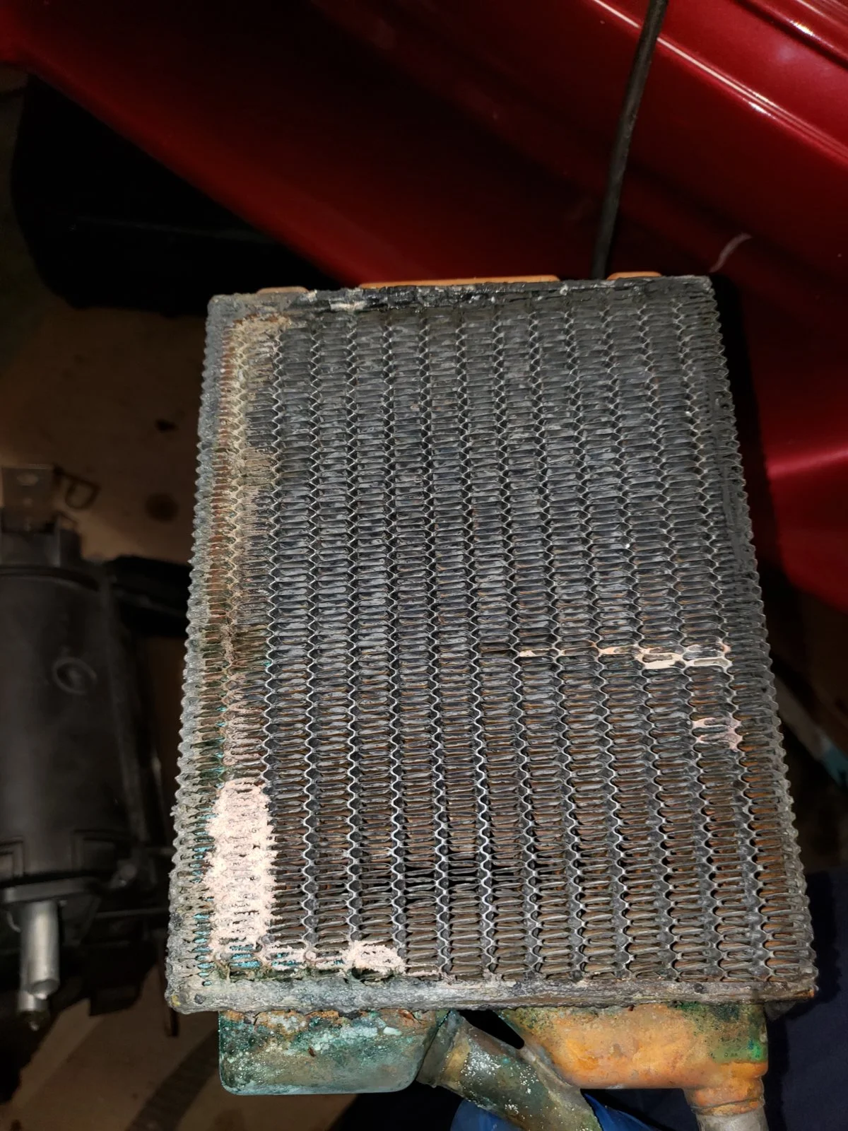

Heater cores on these cars are notorious for going out. Especially if it still has the factory unit in it. This is a pic of my old core. It was not leaking, but I was changing the AC evaporator and went ahead and ordered a new one. I'm glad I did.

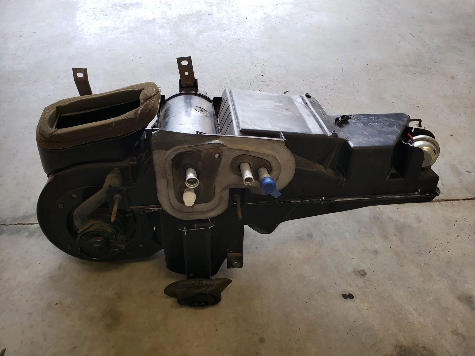

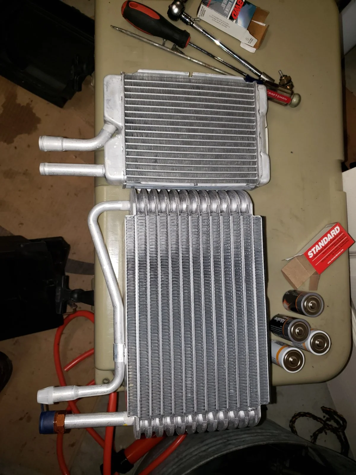

For goodness sake, if you get a heater core get the Motorcraft one. I pulled the dash and put an LMR one in and it leaked a month later. Got another one...pulled the dash a second time and installed it (dummy) and it leaked the second it had fluid in it. So this time I did what I should have done to start with and got a Motorcraft one. I so wish I would have taken a pic of the two side by side. Think Shaq standing beside Spud Webb. No kidding, it doesn't even look like the same part. It hasn't leaked since. And just pull the whole thing out and do it right. Don't cut the box. Many people have done it i know and no offense Nick.
Since I was doing it a third time I took the opportunity to also replace the A/C evap. I also removed everything down to the firewall and cleaned and painted the metal dash frame. I also cleaned all the factory goop off the wiring that had been slowly falling in my floor for years. I rewrapped all the wiring and zip tied them in place. Hopefully, it's done for years to come.
No offense taken! Cutting out the top of the box was the only way that I knew to replace the heater core with out removing the entire box from the car. Someone had already taken the box out of my car at some point and pulled the two halves apart. It's now secured with screws. Made it a lot easier to change the core and evaporator.
I didn't know that about the LMR heater cores. I bought a kit to replace the entire AC system from www.Foxresto.com. I also brought the heater core from them. It's all aluminum. Definitely not as beefy as the one that I took out. Hopefully it doesn't start leaking anytime soon! If it does at least I know how to fix it.
