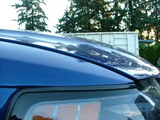

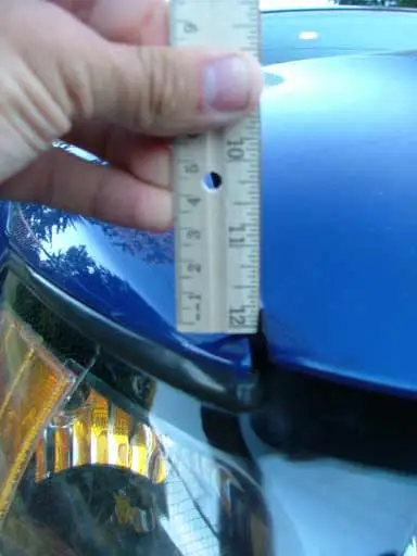

here are some pics for everyone:

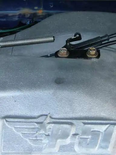

I guess you guys havent read the other P-51 thread I started. I did talk to the company (fox lake) who advertised that it would fit under a stock hood. When I talked to them, they told me that I would have to get an aftermarket hood or cut the stock one. If you want more info look for my other thread on the P-51.
is your hood latching properly now? that could actually become a safety issue. Don't fly down the freeway until you get this taken care of. I would hate for your hood to fly open on you.

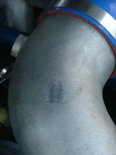

Why couldn't you cut a small piece from the hood. This is not intended on being a smartass comment. I installed Ford hoodscoop on my 2000 and had to cut several chunks out for it to work. It doesn't look like it will be noticable. What kind of inlet pipe are you using? Is there something hitting that too?
I am using a C&L inlet tube with a 80MM MAF. I may cut a chunk out of the hood. The whole point of this thread is not to ***** but to let other people know they they should expect when buying this product. I will take care of it somehow for myself but dont want to see others having the same issues. I dont know anyone (aside from 99.9% of MD) that would like this kind of thing and back it up. Im just trying to inform.
I do believe that the hood is latching properly, it is just pushed up on that side by the intake manifold.

Also, can the hood "bump stops" be (located by the headlights) adjusted to allow for a slight increase in hood clearance? Granted, doing this would make for an unsightly "gap" between where the hood meets the front fenders...

I did remove the blanket because the hood wouldnt even close with the blanket on. The hood is hitting both the inlet tube and the top of the intake manifold. If you read the other threads on this, some say that it is the engine mounts and that they can vary up to .5" and mine is sitting higher than some.
