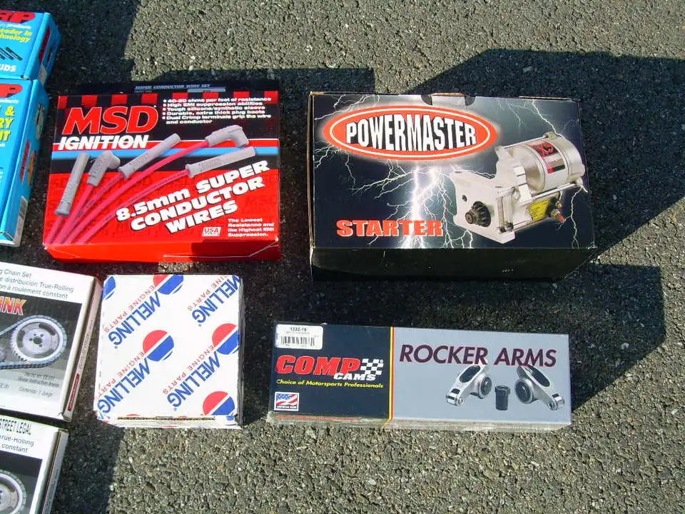

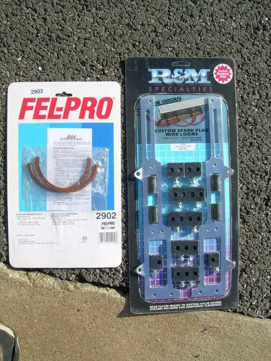

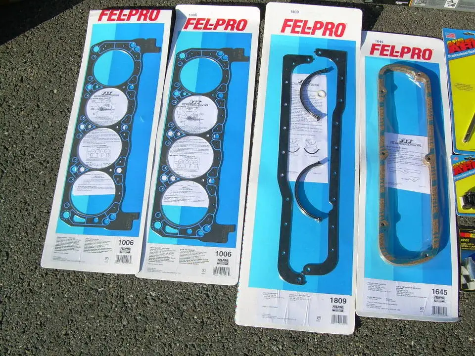

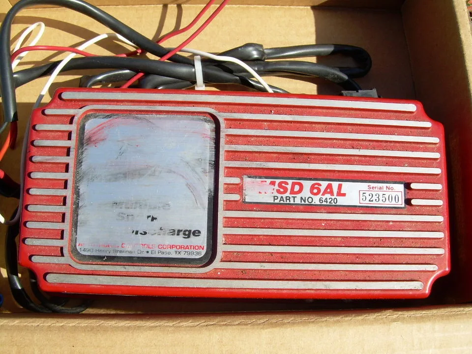

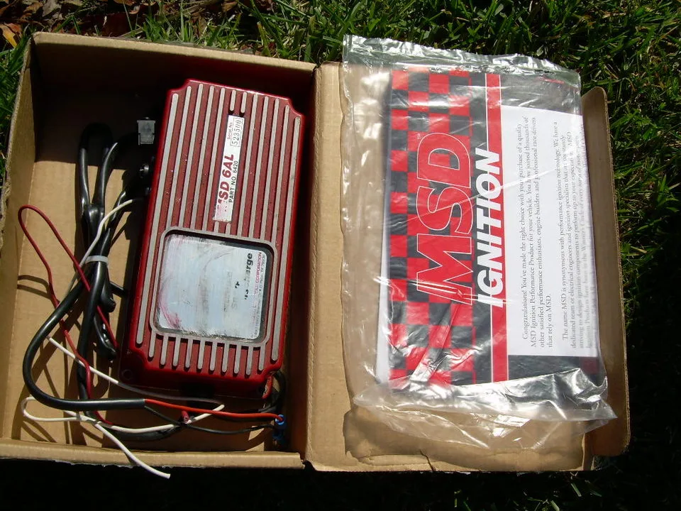

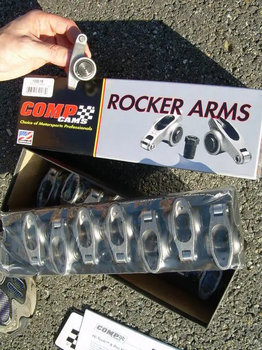

will do. i'll also be putting together a spreadsheed that has every single part i bought for the motor with and part numbers and prices. i'm not sure i will want to see the bottom line though :rolleyes:
and of course, there'll be more pics. 3 boxes from summit just came today, and i have a bunch more stuff on order ...
