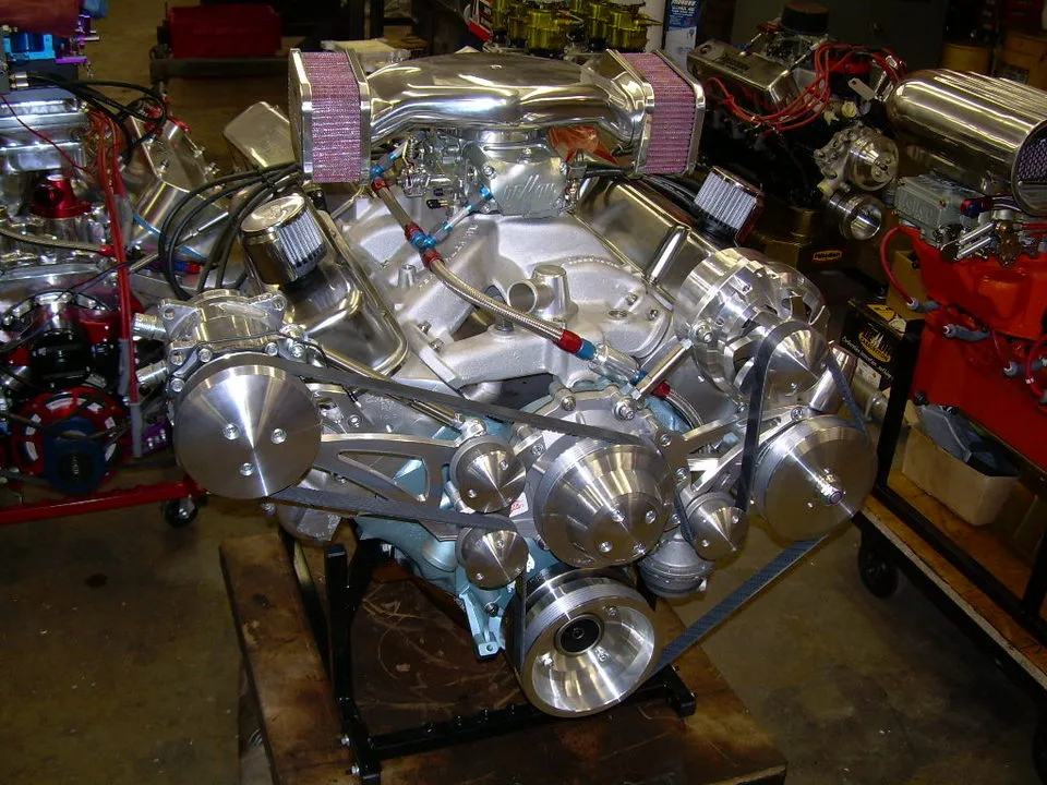

Pics of my 408 at the machine shop
a chevy motor with a march system and my a/c and alternator
