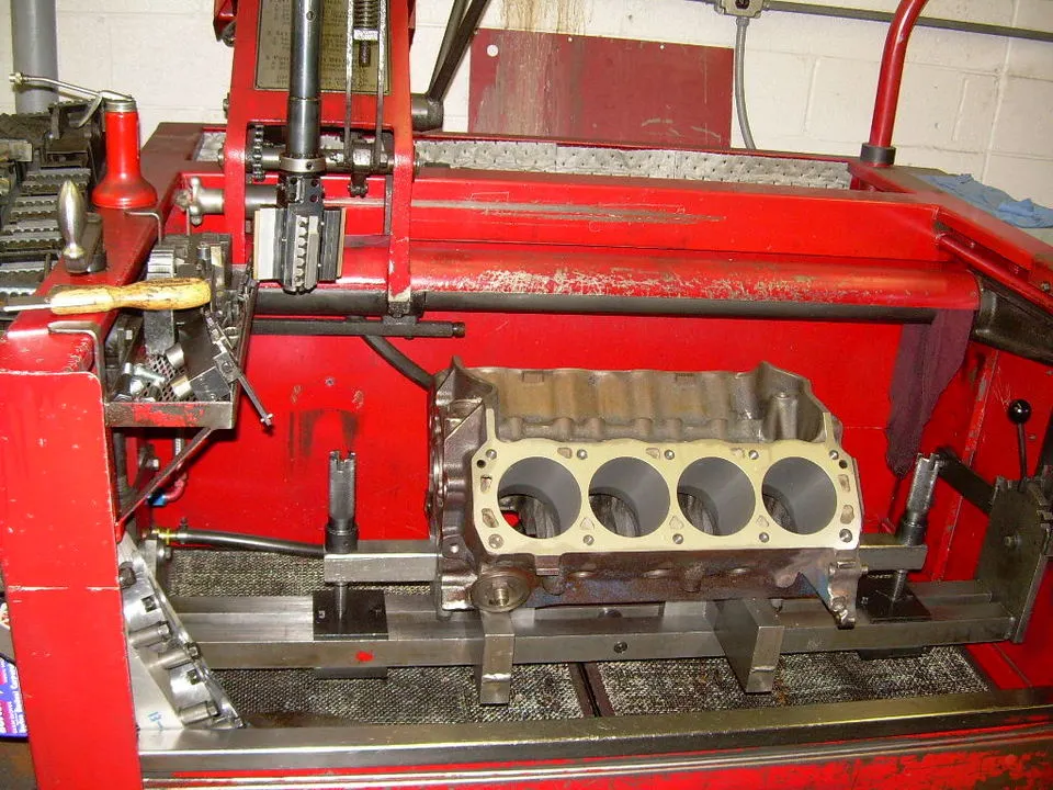

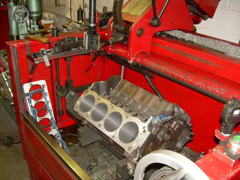

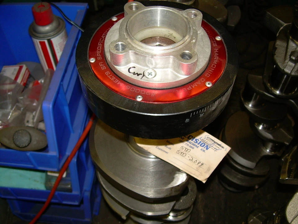

Pics of my 408 at the machine shop

my block on the honing machine ...

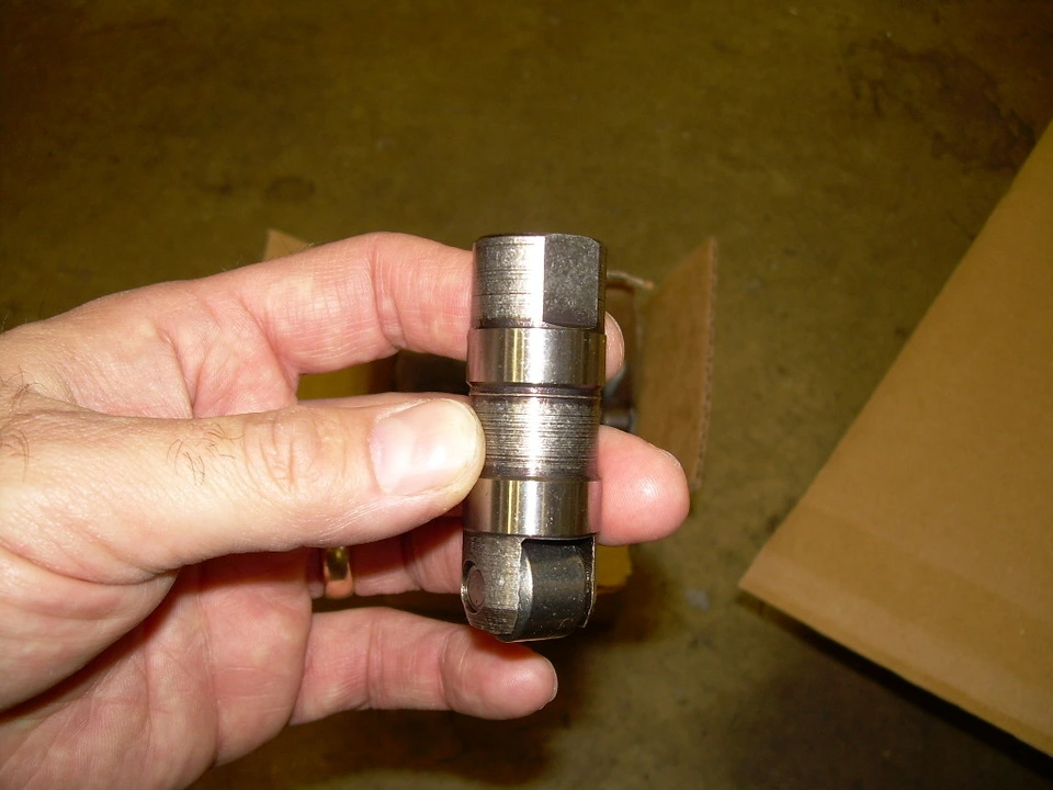

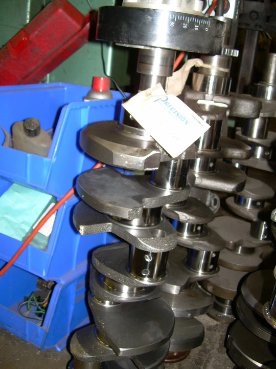

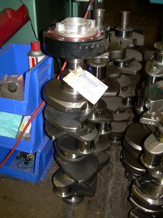

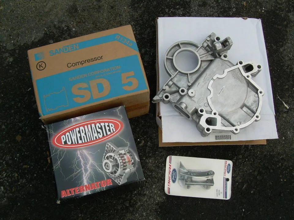

more stuff for my build ...
