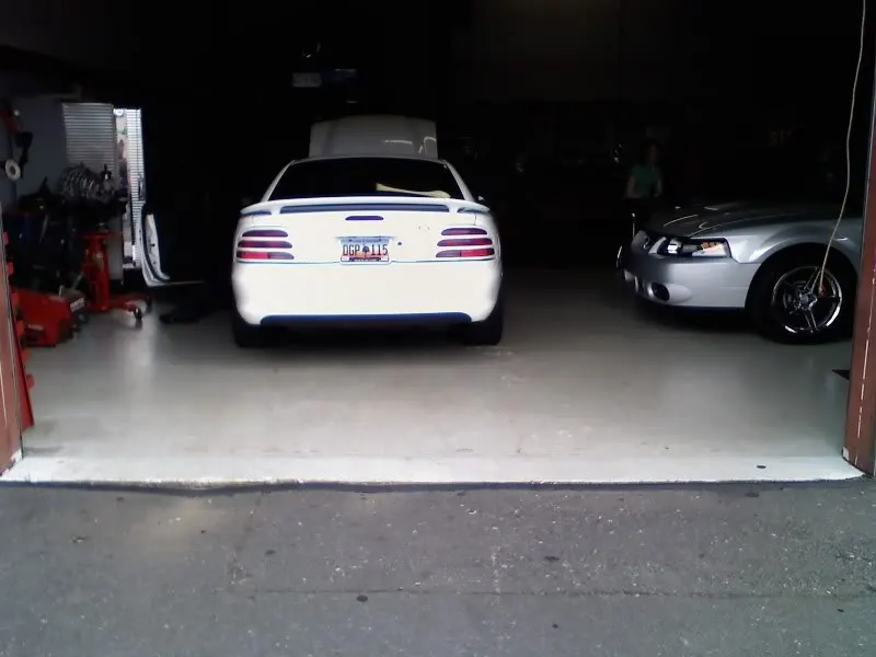

Heres a pic of it about to go on the dyno...

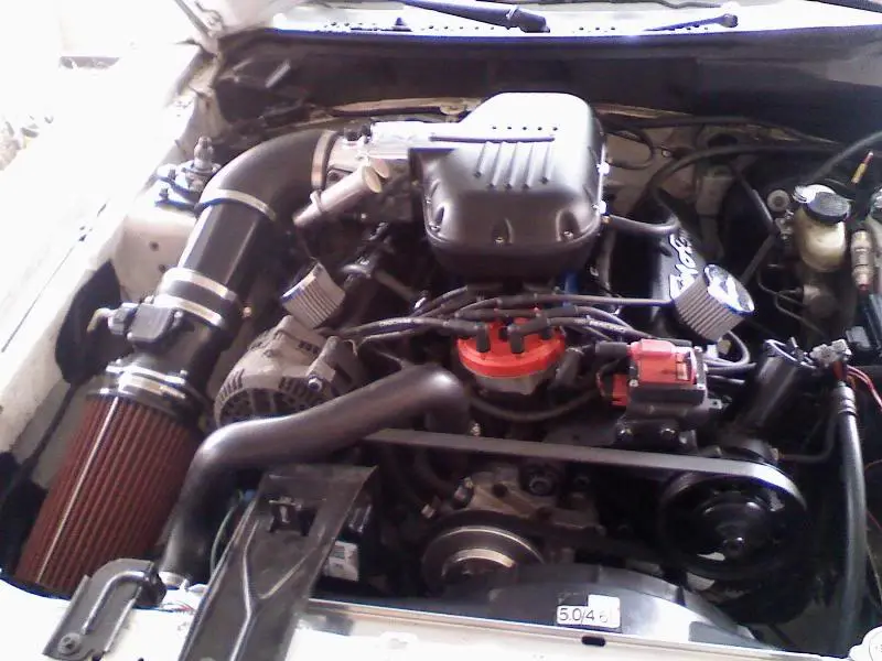

And here is a motor shot
I'll take a couple better pics tomorrow and maybe get a video of it with the exhaust on.
I would say yes based on the numbers you reached alone. You have gotten better results than anyone expected. On the trick flows- were they ported or anything? I had trick flows (170cc) and always wondered how they would perform on my big c.i. I sold them cuz I never thought they would flow enough.
