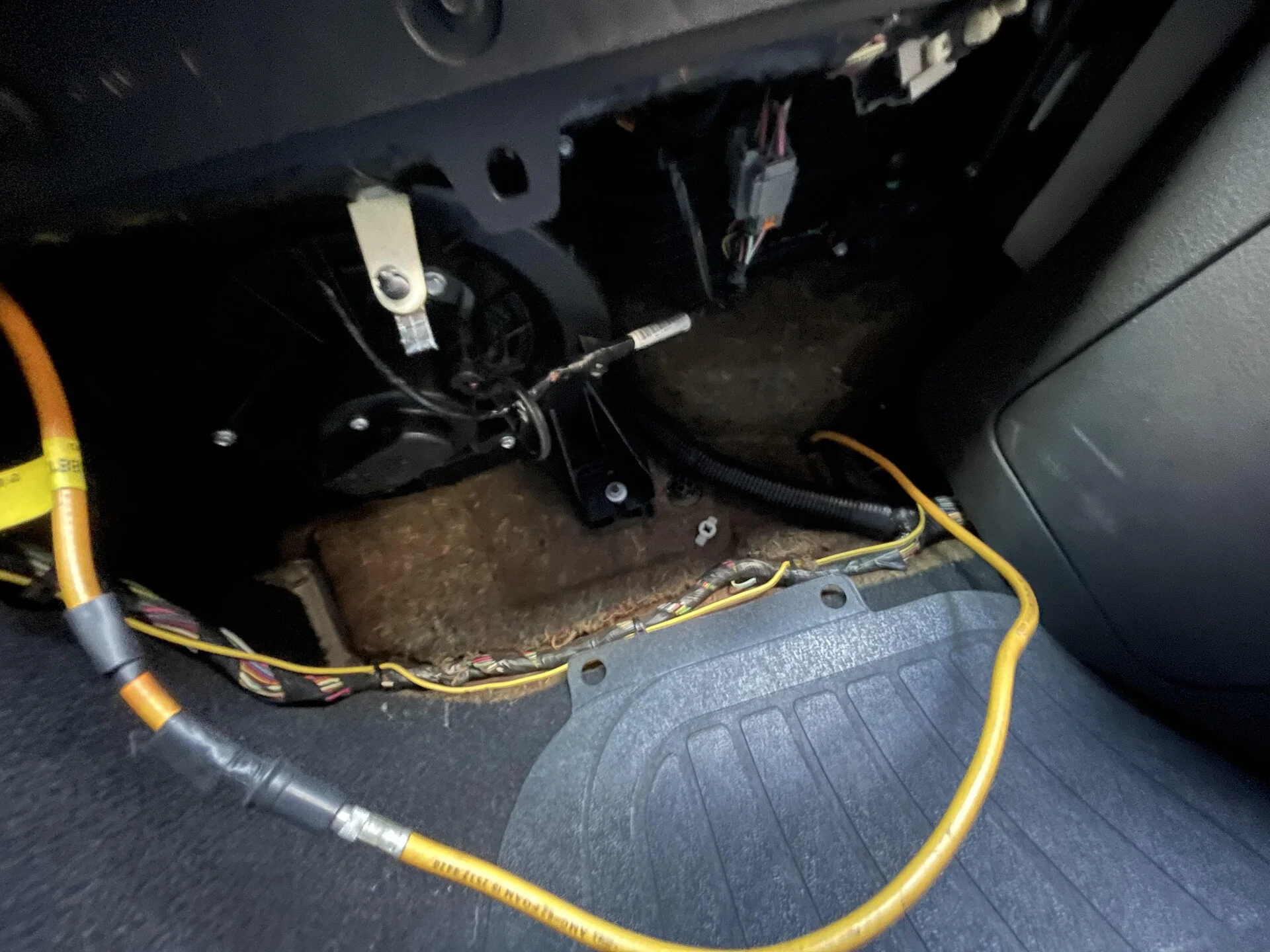

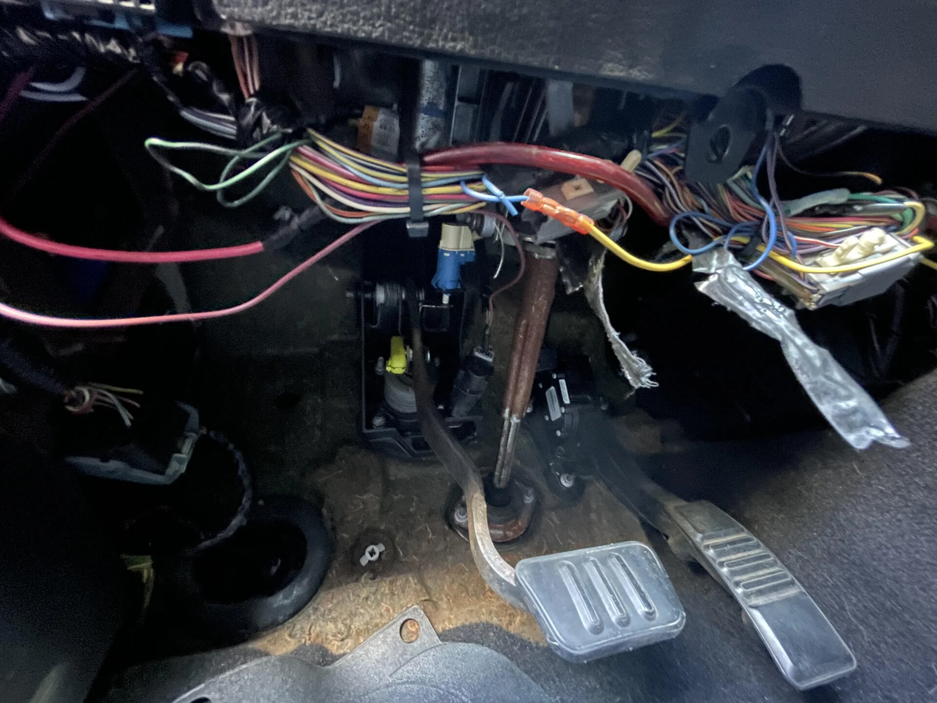

So I have a 2009 Mustang V6 4.0 and I am missing the plastic panel that goes under the knee bolster that would cover all the cables on the driver side and the plastic panel that goes under the glove compartment that covers all the cables on the passenger side and I am having a hard time figuring out what it is called so that I can find the part and buy it, please help. (I know its a V6 but I am a 16 year old and it is my first car and it is all my parents could afford and I am beyond grateful for it.)
Nothing missing on the passenger side, just tie up the antenna lead it's missing a clip. I would go to your local salvage yard and find the drivers side. lower valance.
www.car-part.com put in your information and you will see salvage yards in your area.
After looking at the pics again, your not missing anything. Somebody was in there and made a mess. Yellow antenna wire is missing a clip. Get some wire ties and clean up the driver side.
