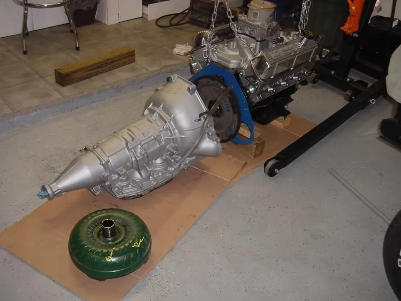

They said it would be better to take it back to the salvage yard and try another. So I got one from a '89 Cougar this time and it has the data tag to verify that. And it does have the recessed hex casting mark in the case previously mentioned. I did another clean-up and paint and installed it.
I had to do the linkage swap so the shift lever was up instead of down and while I had it off I replaced the seals and modified the arm one inch longer to match the throw of the old C-4 shift lever. I got the new filter & gasket on and sealed the pan.
Tommorow I'll add the fluid, fire it up and check the TV pressure and give it a try. If this one has issues, I think I'll remove it and have the transmission shop rebuild it. They said $650-700 depending on what it needs.
