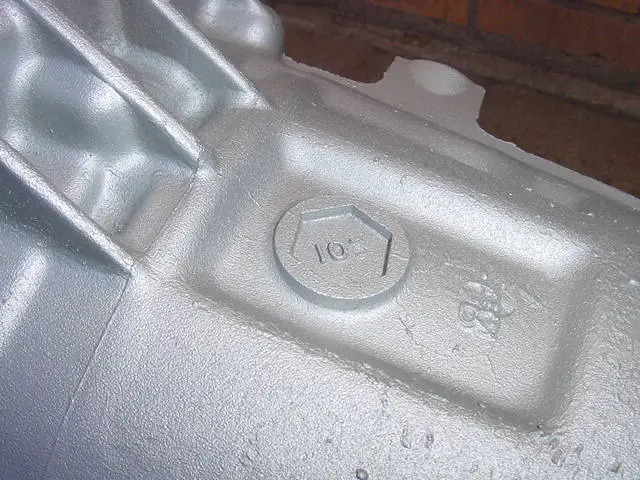

It's right on top where the bell meets the case:
Thanks Tim65GT. Now Igot the urge to go out to the garage and check, but the two inches of ice from the storm we're having will put an end to that real quick:mad: I knew I should've stayed in Florida.......
What type of paint did you use? That came out real nice.
