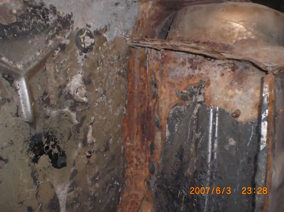

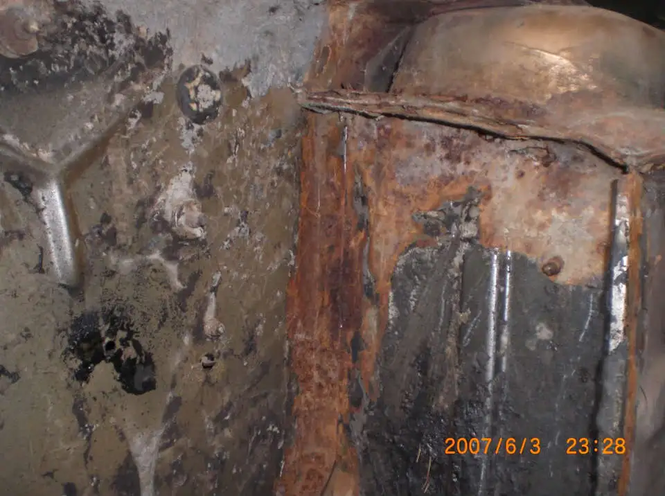

Let me ask you this, here's a pic of the inner fender, in the corner just rear of the drivers side hood hinge.
You can see where I scraped away the undercoating and seam sealer. The original overspray can be seen (antique bronze) around the hinge nuts, that metal is in great shape. To the right you can see the rust at the seam. Above that is the horizontal cowl joint, which is the biggest area of concern. My plan was to use a wire brush to clear away all the rust in the whole area, as well as the bits of undercoating still there, then clean, prep and por15 the whole area. What's your suggestion on what I should use and how I should do it?

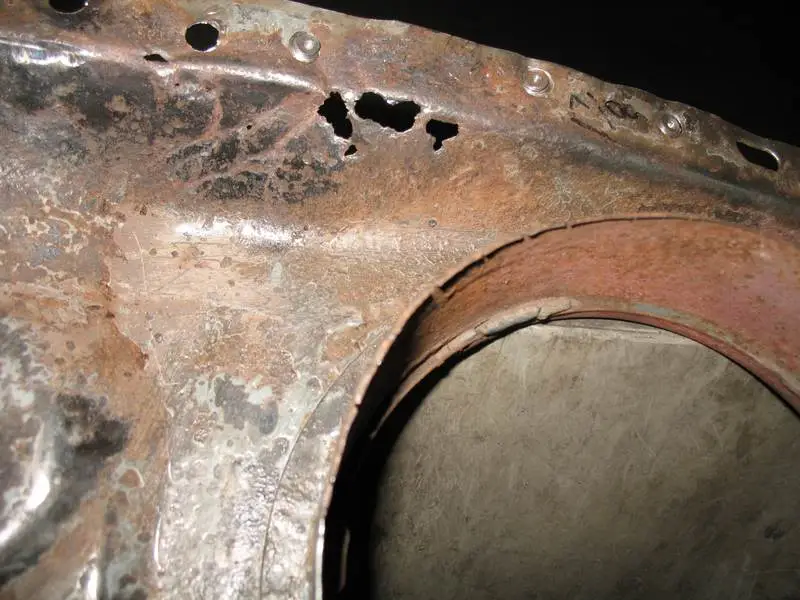

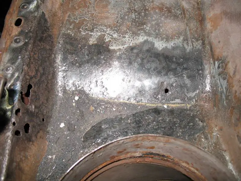

Be sure to check out the inside of that cowling, where the seam sealer meets the apron. Under the seam sealer is where I found the worst rusting on mine.
It gave me a hint of what to expect on the inside of the cowl, directly beneath:
I am really hoping it doesn't come to that. I can see one small hole from the top, and the seam is pretty rough in the one picture I have there, but looking up into the drain hole it looks pretty clean in there. I need to pull out the interior underdash to get a good look from underneath. How to treat the inside of the cowl with inhibitor without dismantling the cowl was going to be a future question topic. I really don't feel like drilling out all those spot welds.
