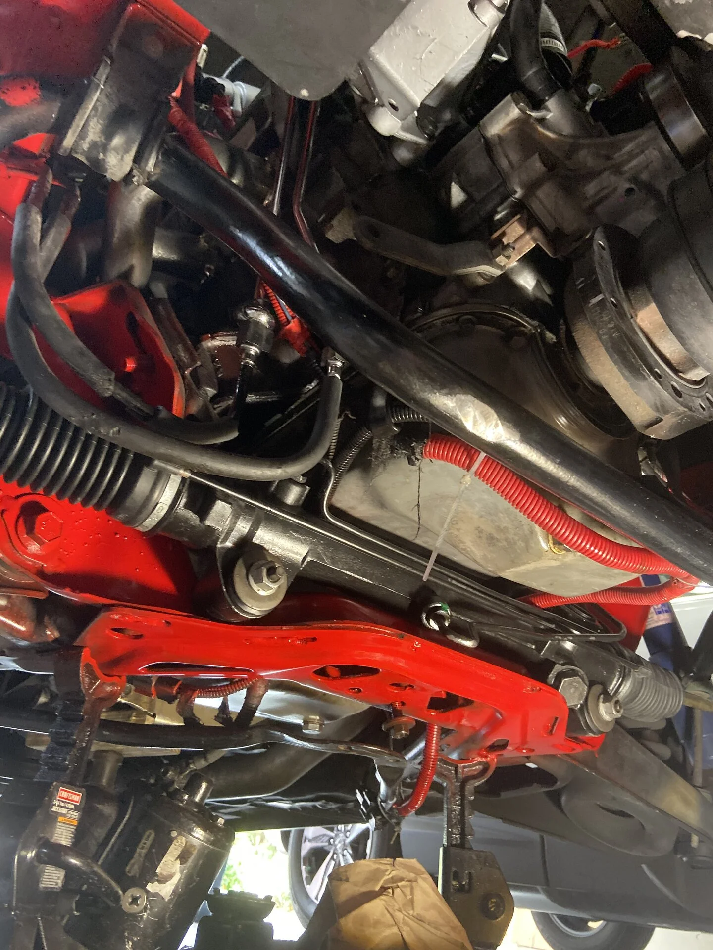

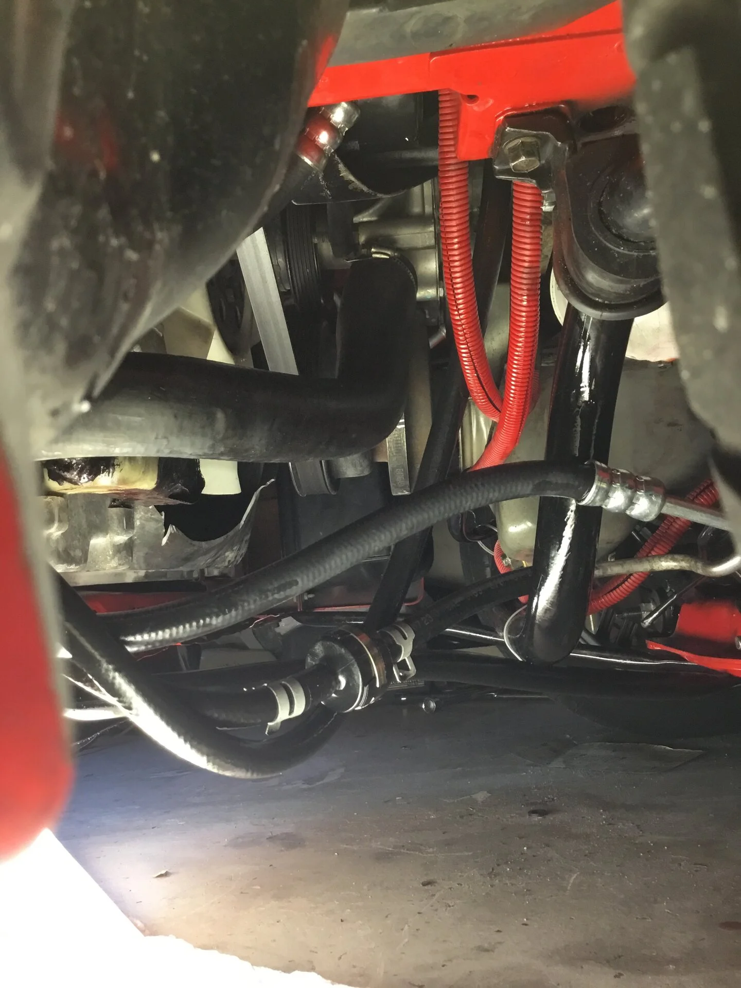

My re-manufactured everything on my cars steering made noise until I put a half bottle of Lucas. Now its real good. I also believe that it took a couple of months to work in. Also I put in a filter for the power steering. Changed the fluid three times
The Lucas stuff says it’s to stop leaks. Is that what you used? Also, what kind of filter did you use?
Twelve dollar in line from Advanced...I just used half bottle with the stop leak. I had it around from before. It stopped a massive steering rack leak for six months. I think its a fairly small ratio . Its a small bottle 12 oz maybe 8 oz.

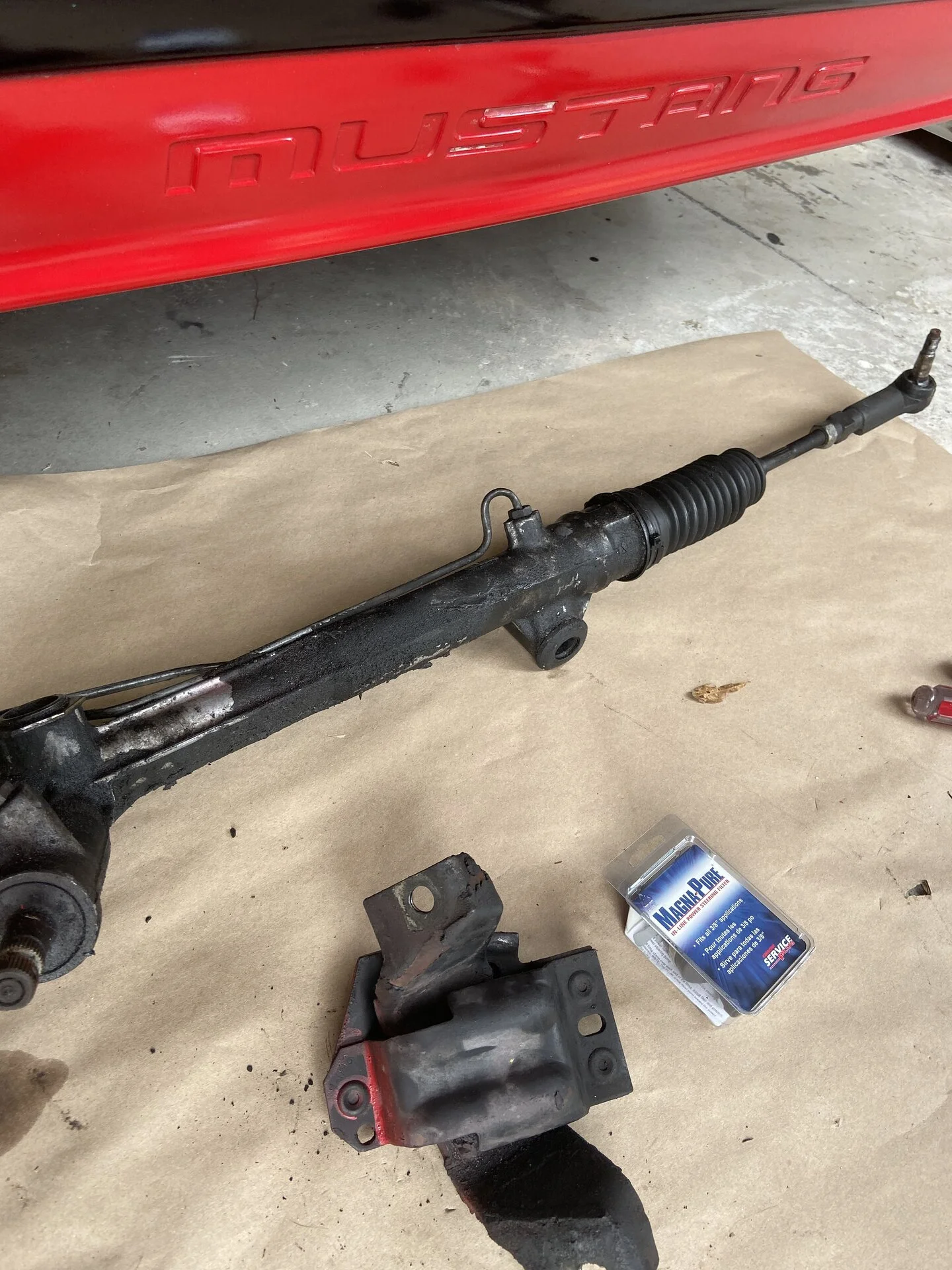

This old stock rack was replaced by the sport 2 1/2 turn Cardone reman. unit. less than ninety bucks. I was nervous about this because of the reviews , but so far real good. No warranty without a filter.

There are much worse remanufactures than Cardone. I think they have upgraded QC and are trying to be a premium line for shops. I do not know an insider, it is product observations and fewer returns that changed my rating.
$90 was a great deal, Pete.
