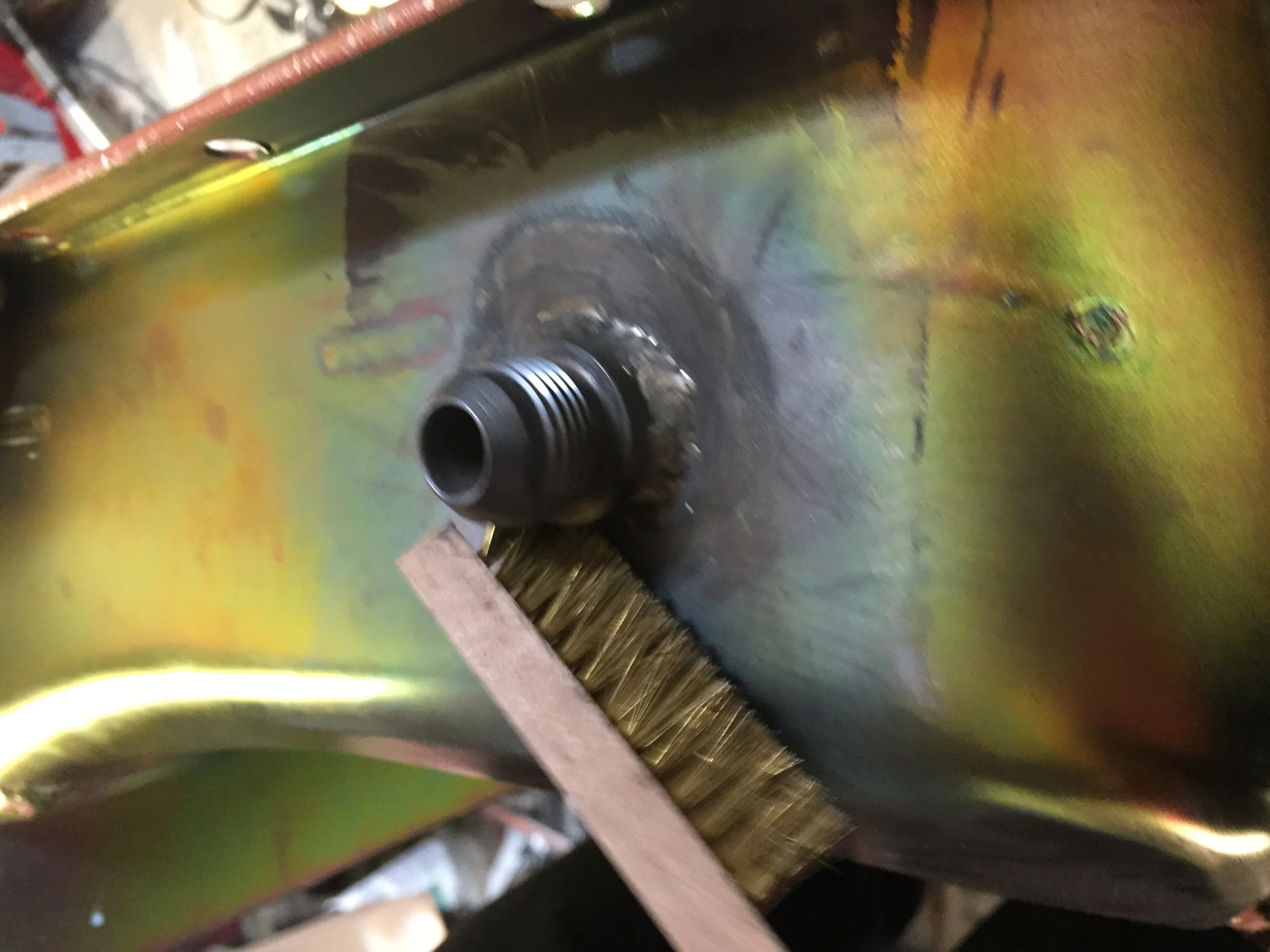

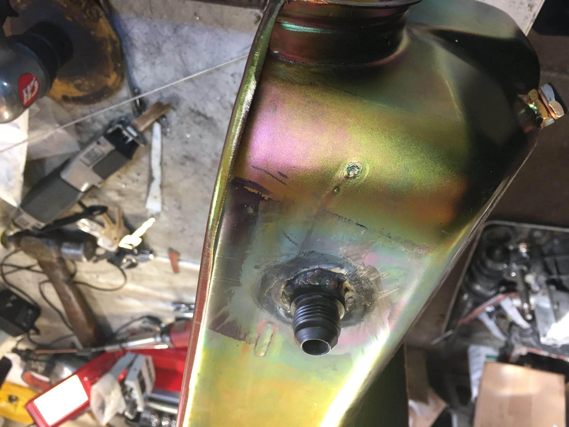

That's how my fitting is . Again in the car your not gonna do it this way but it's just to show an idea of where it should be .

Little update -
On the last few steps...ended up changing valve cover gaskets as well when I switched injectors.
All that’s left is to switch the crank pulley, tap the pan and mount everything up.
Thoughts on grade 5 bolts for the crank pulley? I cannot seem to find any Grade 8s in the 1 3/4 size...tried everywhere local including a fastener store.
Also any tips on tapping the pan ? Directions just say to start small and move to a 9/16 punch.
