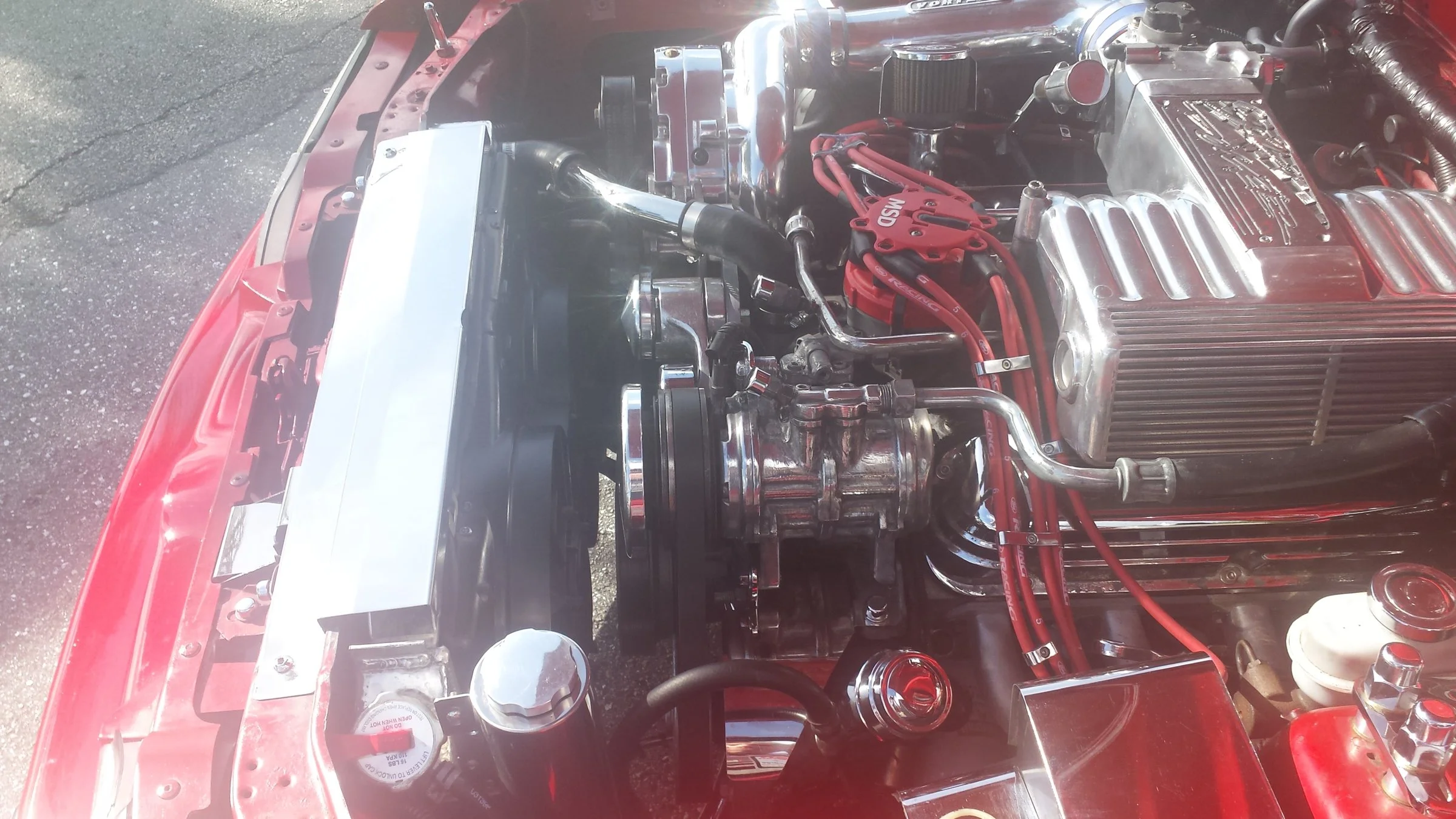

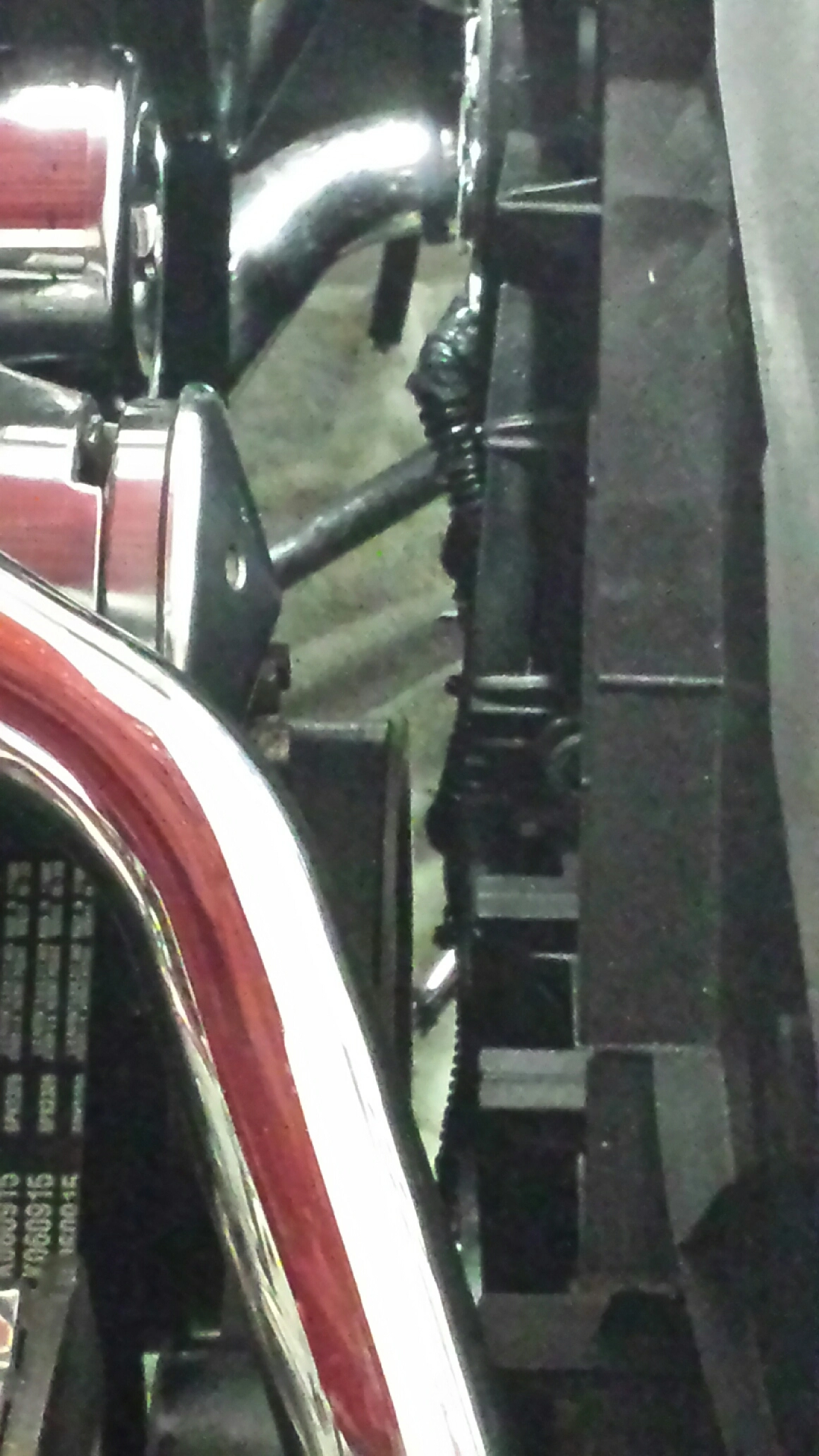

It is very tight. I run a dual contour fan.
Thanks for the pics - that’s similar to mine so I should be OK.

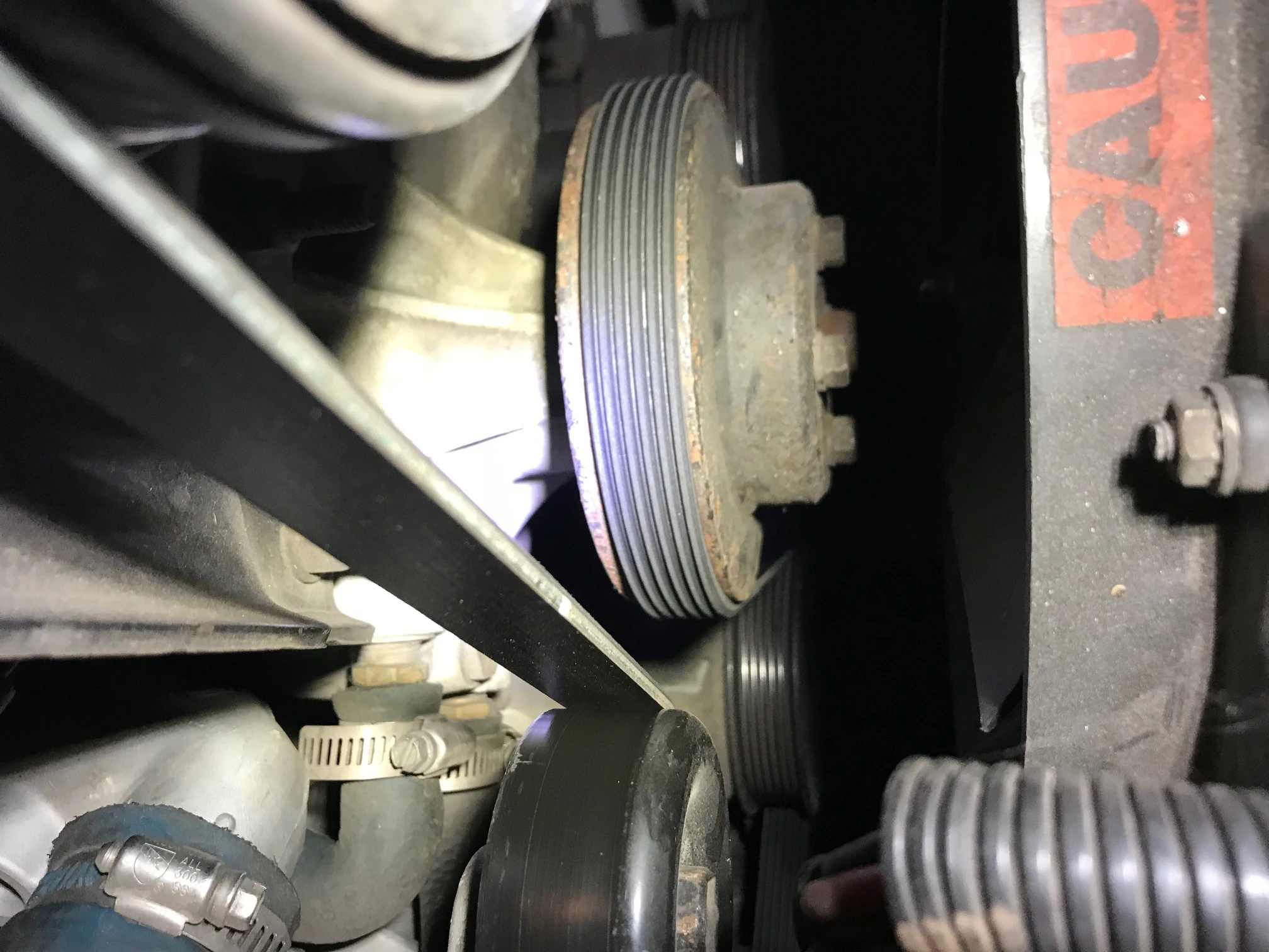

Looking at my water pump pulley is there any easy way to tell if its UD or not? I was told it was UD but every replacement pulley I've looked at looks the same....
Attached a terrible picture and it measures roughly 5.5 inches...

Looks like an underdrive .
I'd swap whatever fan you have out for a dual contour fan eventually . Plugs im not certain on id ask the tuner . Make sure you have a way to bypass the msd if you ever get stuck they make a quick harness . I told ya make your life easy and order a 93 cobra water pump pulley from ASP . Trust me
