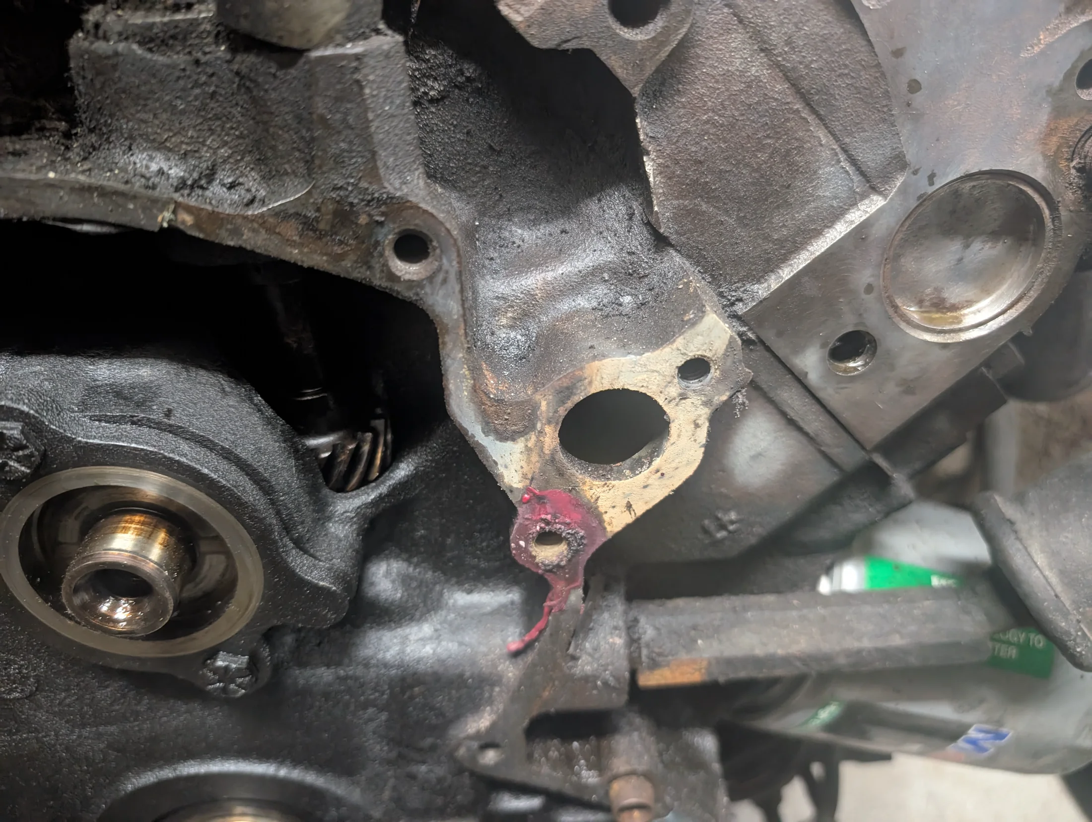

Extraction was successful.

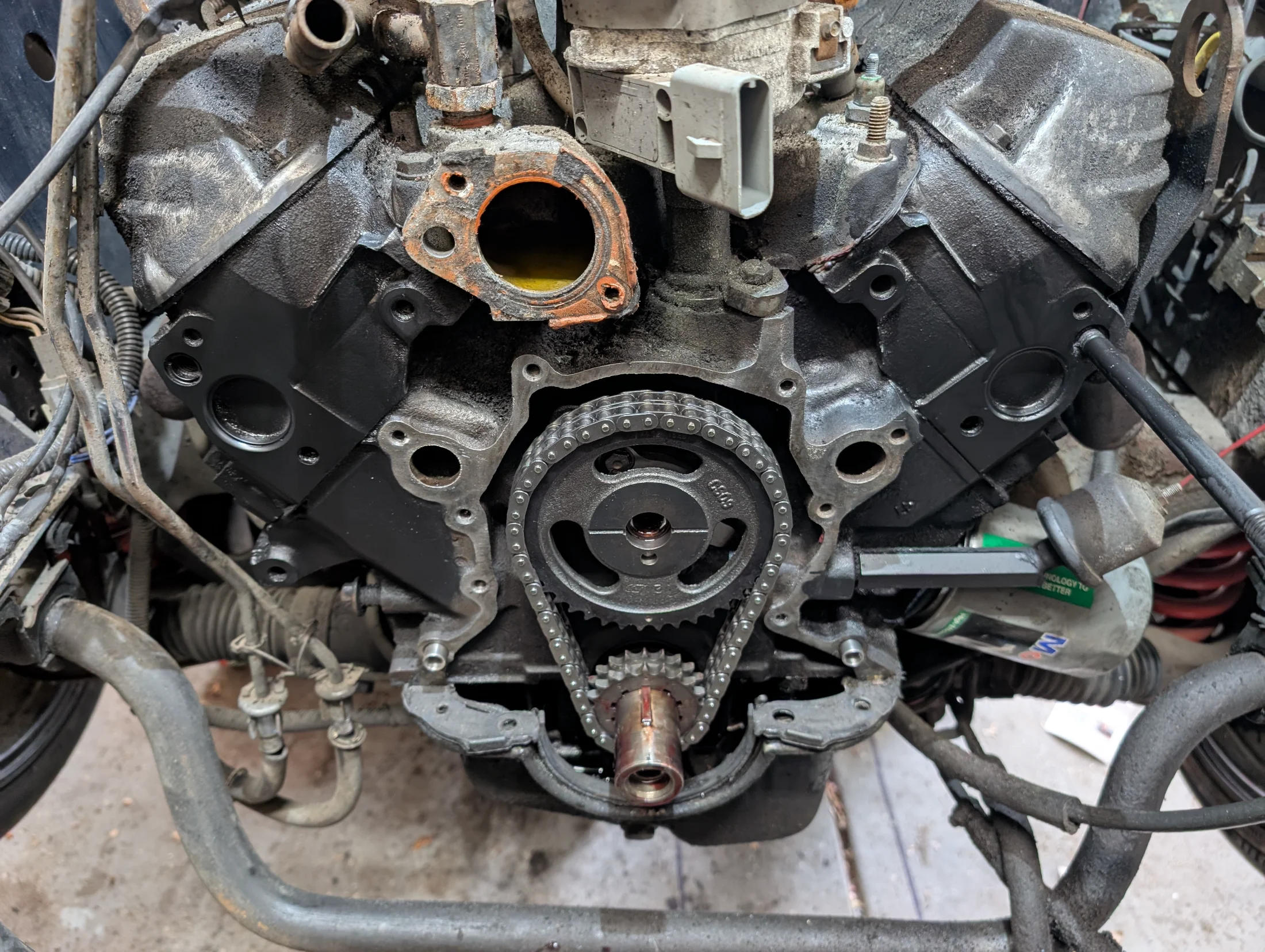

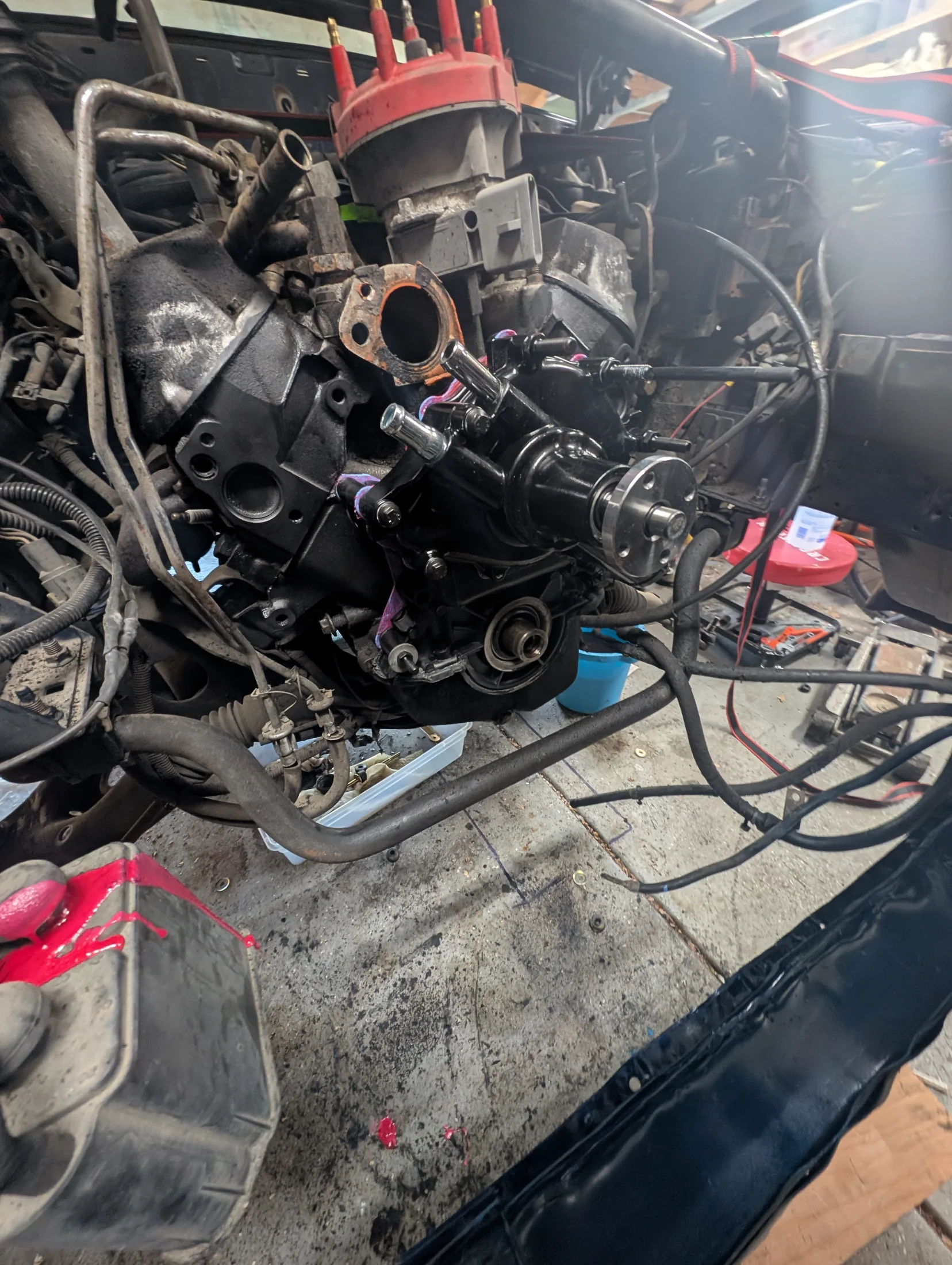

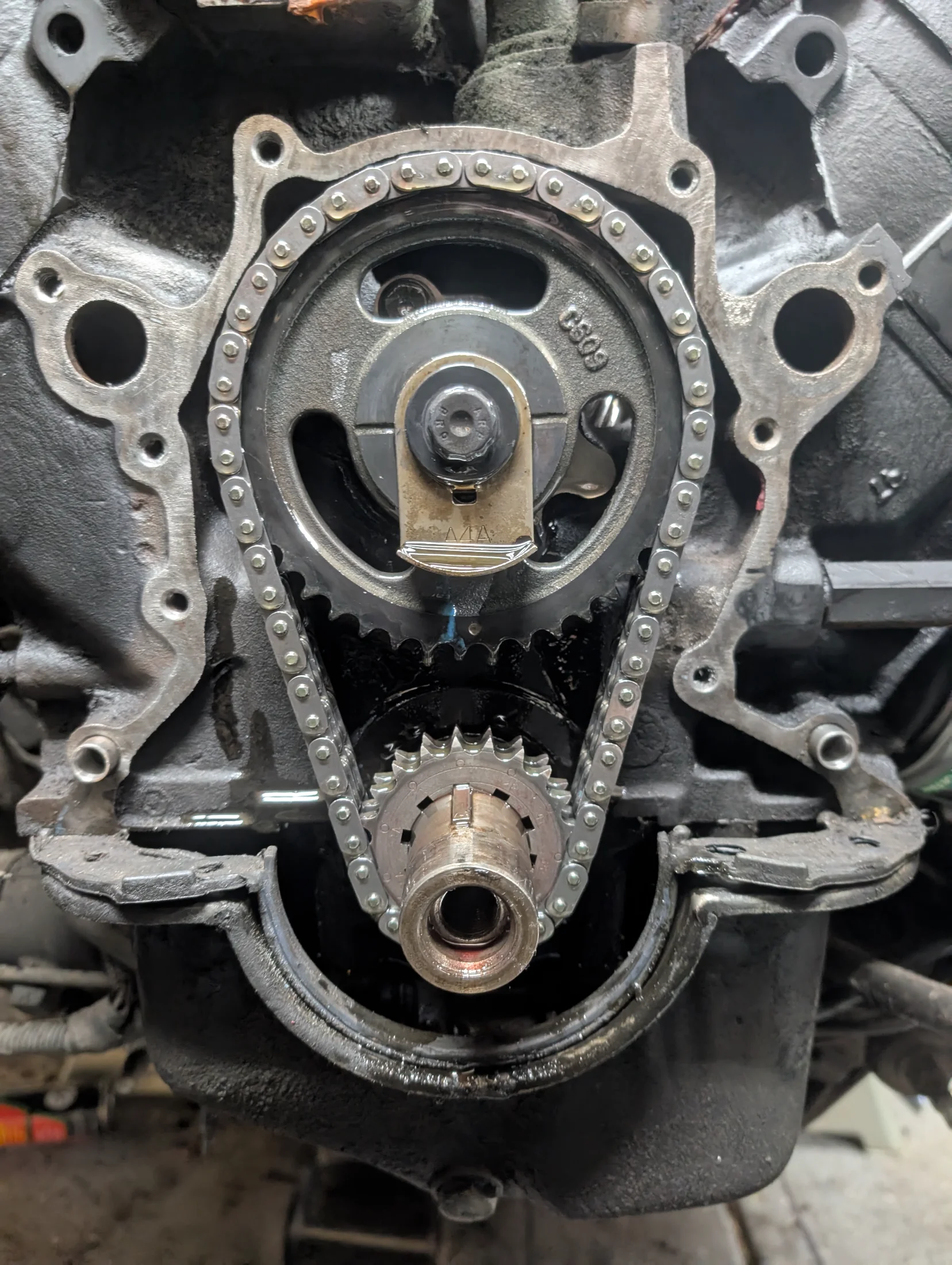

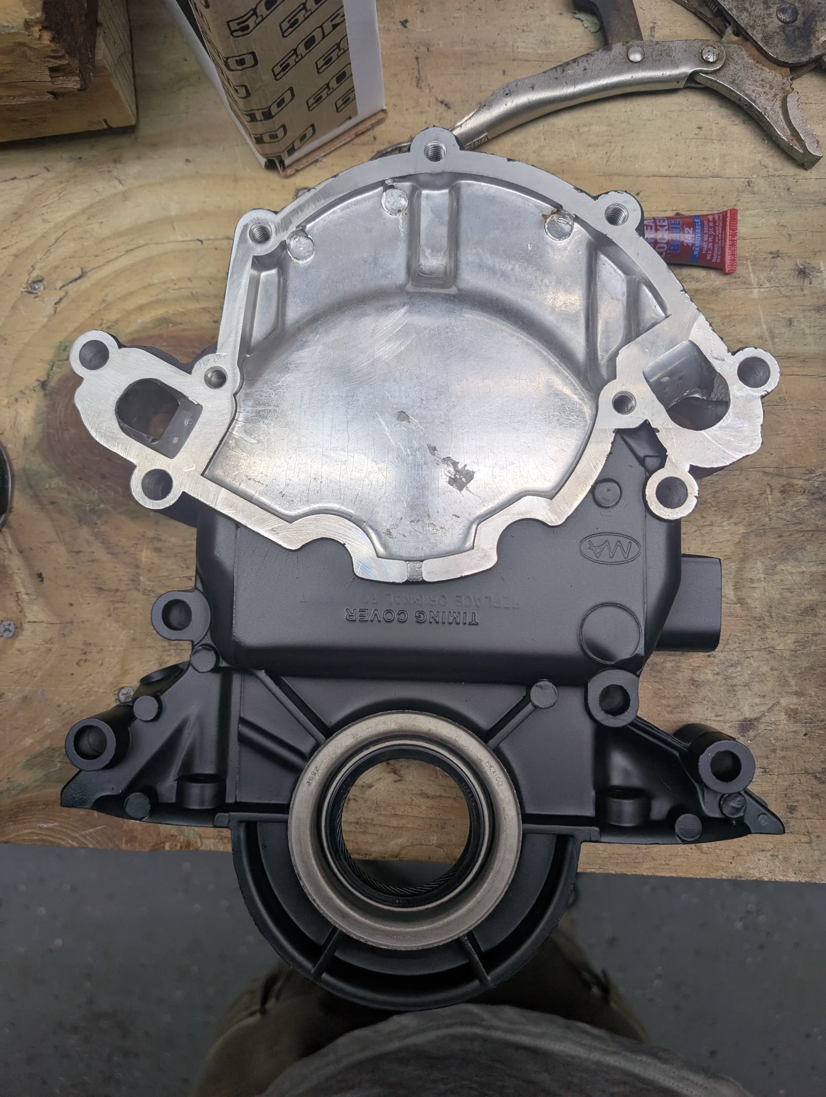

Bit of cleaning and engine paint.
Timing set went on like a dream. Just got to install the cam bolt.

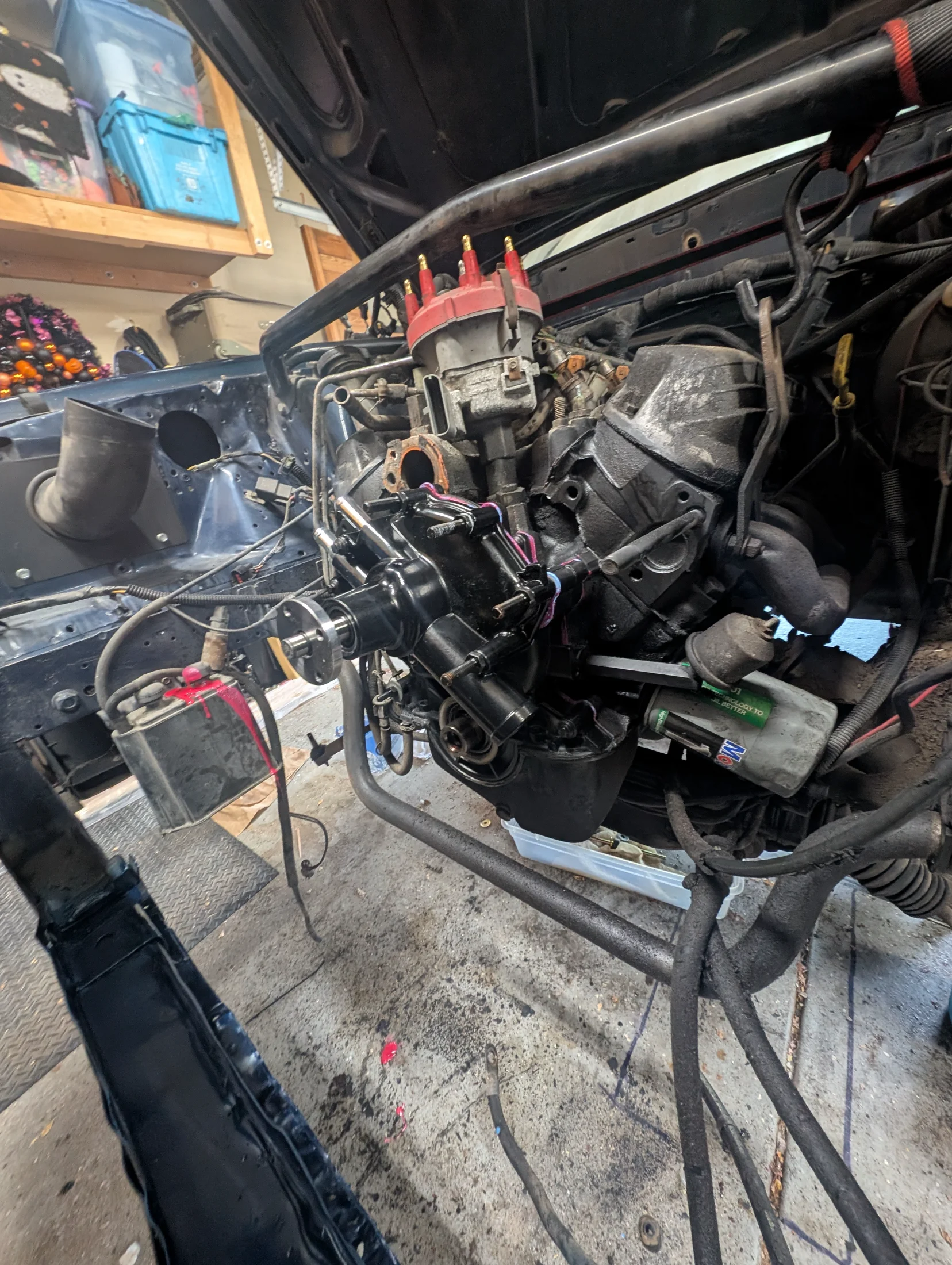

Torqued. Spun twice. And oiled down. Like we all hope to be.

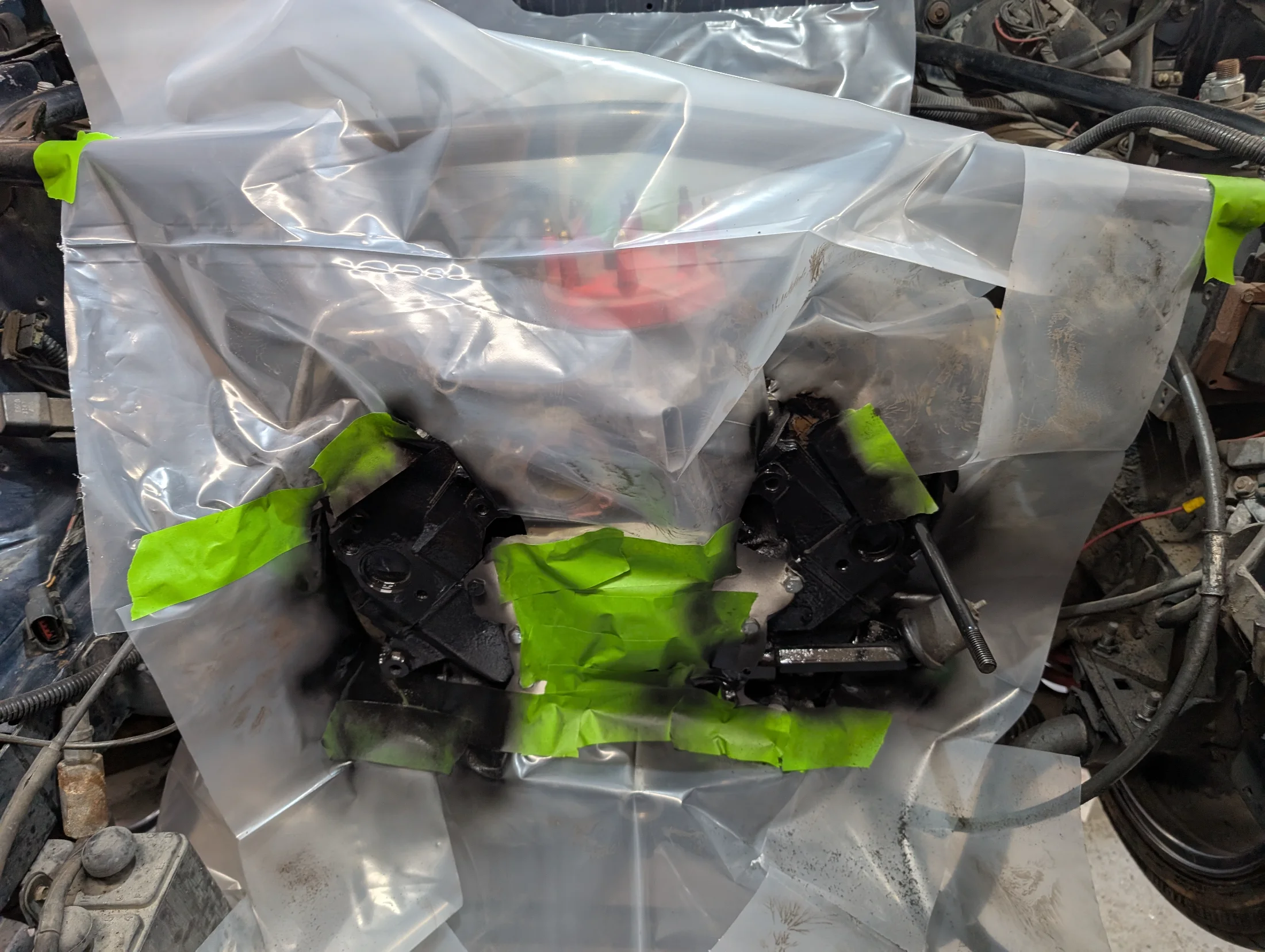

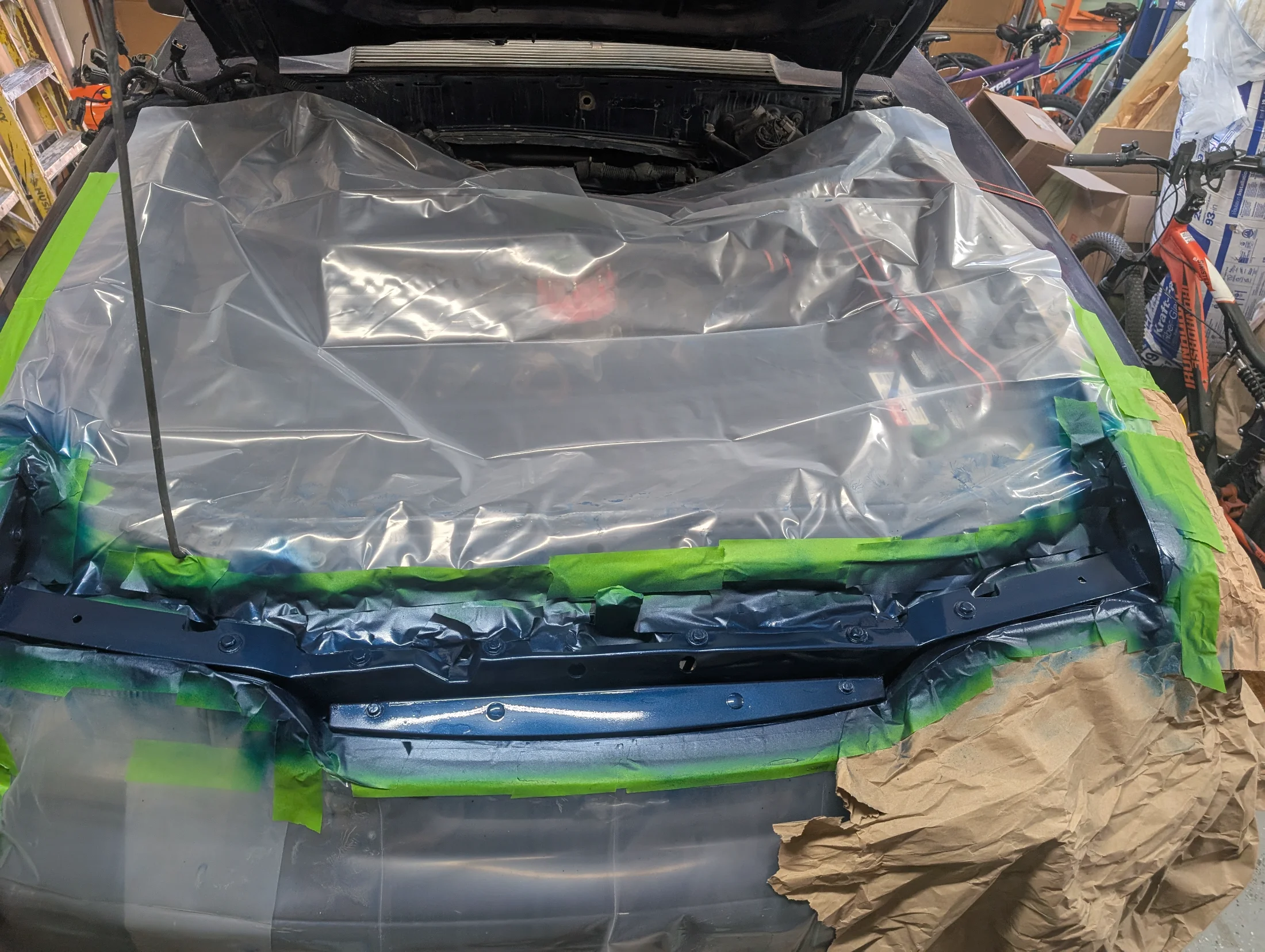

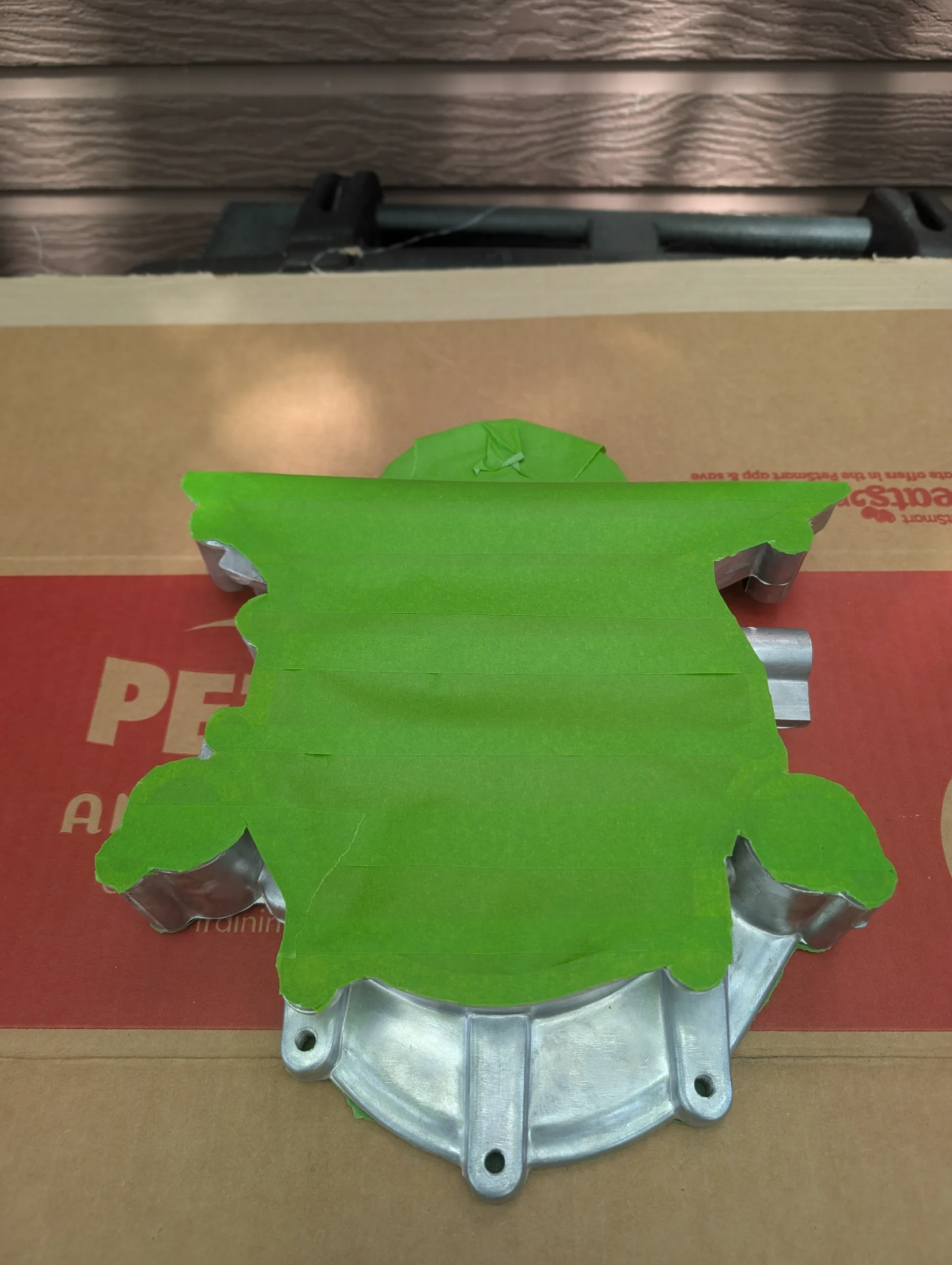

Since I'm blacking out the front of the engine....
Reactions: Rdub6, AeroCoupe, gkomo and 1 other person

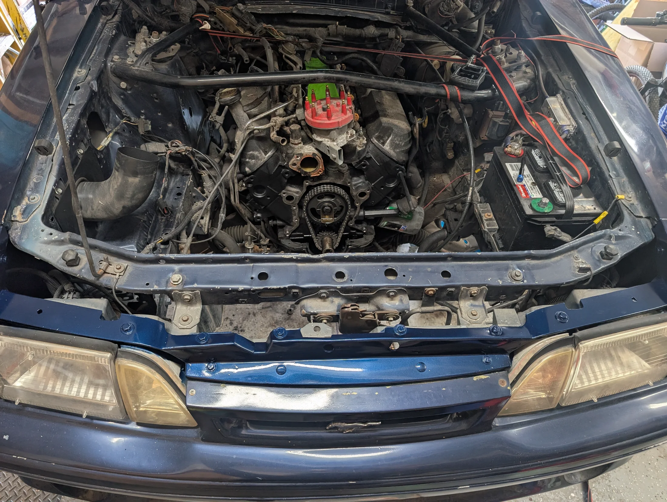

Removing things for an incoming Maximum Mortorsports order.
Reactions: gkomo and 85GT4V

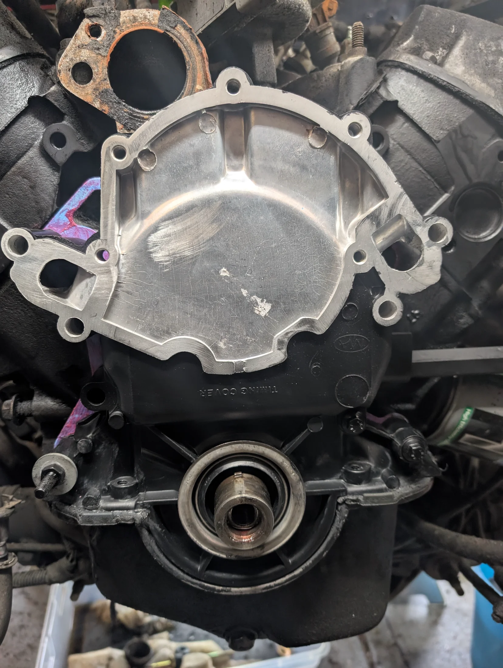

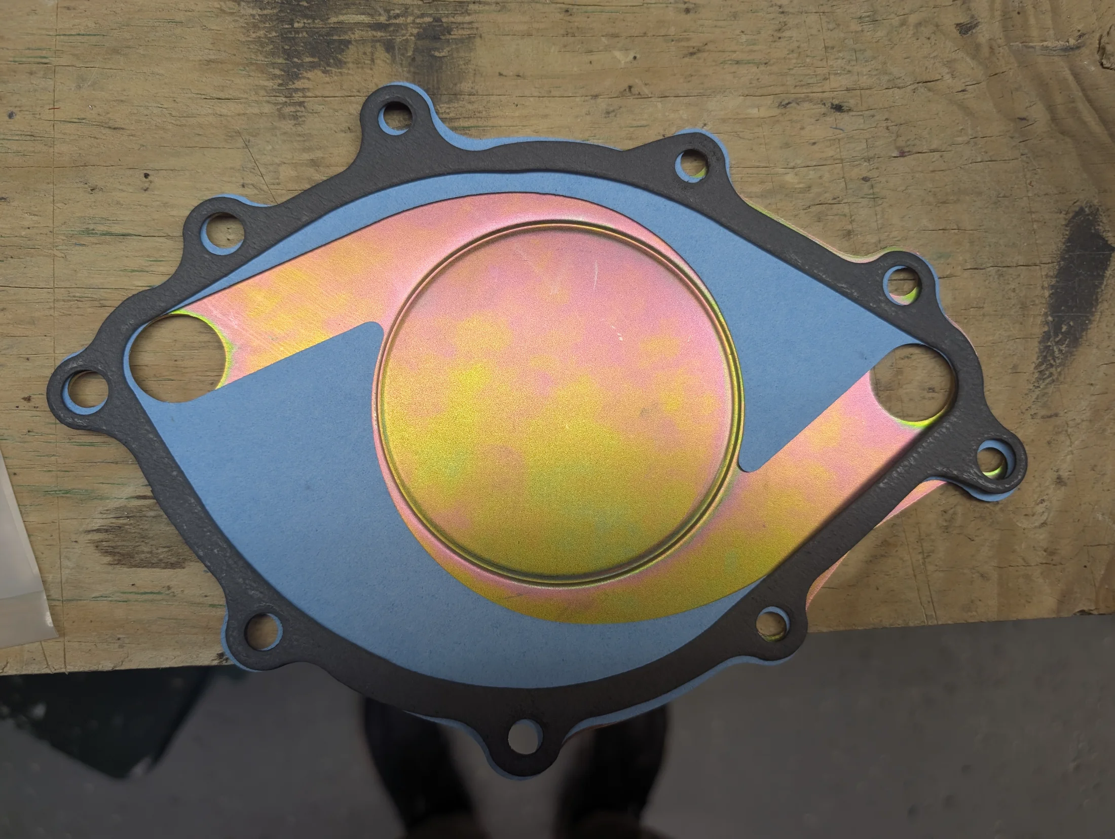

I picked up the proper Fel Pro gasket for the water pump backing plate.
Gray is the POS that came with the water pump.
I feel like I should trim the inner blue off the Fel Pro to match so that there's not free floating gasket on the inside of the pump.
Thoughts?

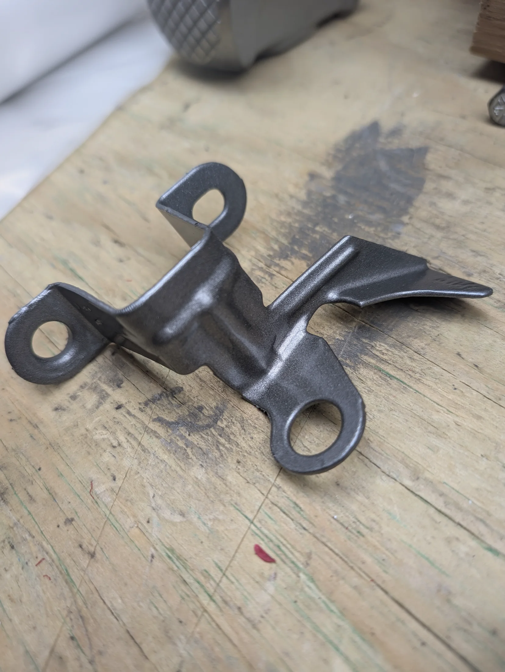

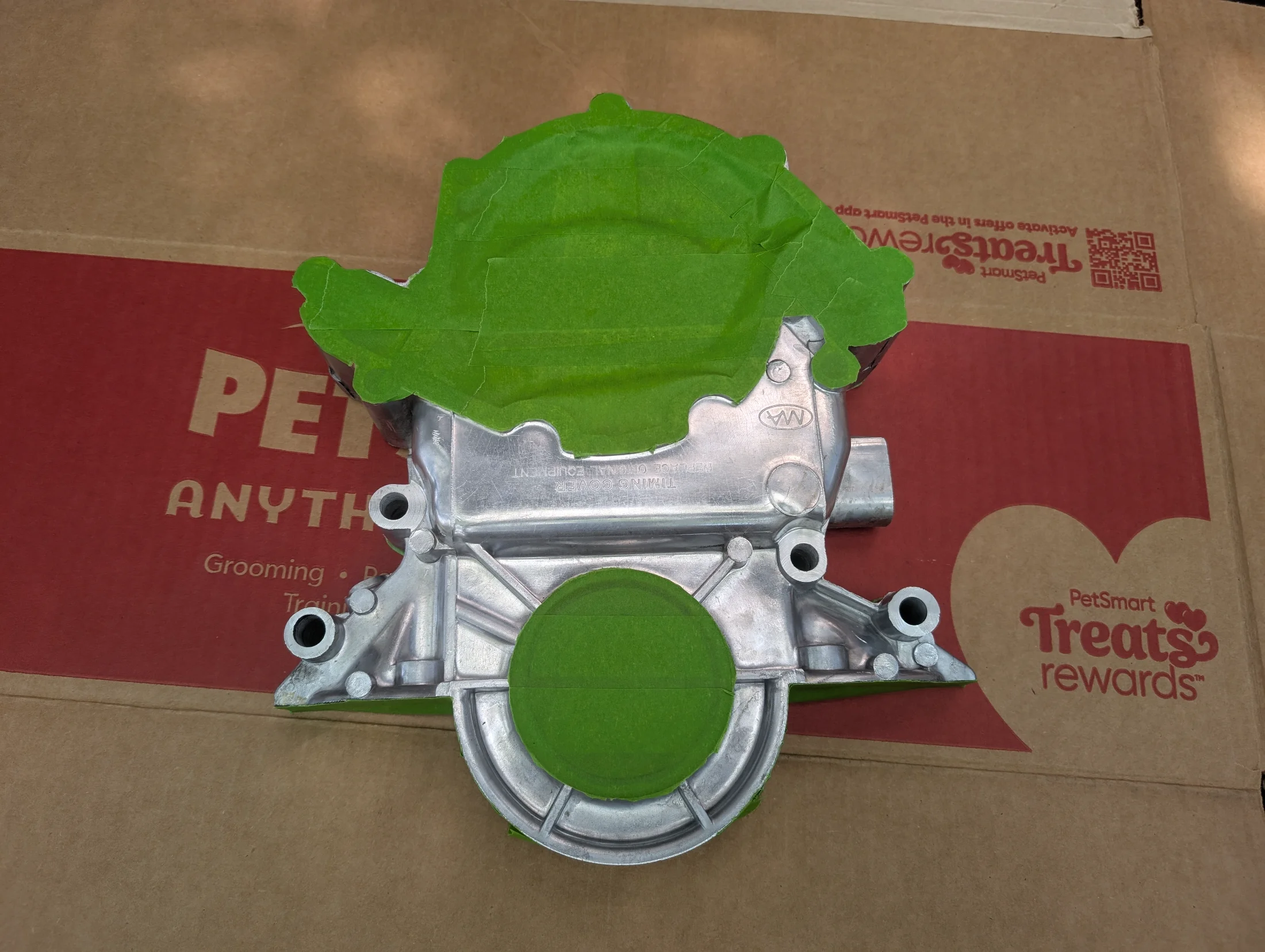

Aight. Did a thing.
Also, while I wait on more parts, I tried a rattle can thing.
That's what the whole car looked like when it was freshly painted.
Reactions: Rdub6, General karthief, RaggedGT and 1 other person

Getting the timing chain cover to go nicely over the curved part of the oil pan gasket was a royal pita. I did put some black RTV in the corners where the cover meets the pan and a bit under the oil pan gasket. It's the nice full rubber one with the metal inserts. So hopefully no leaks.
Also, per the Ford manual. No RTV on the water pump. Good gaskets and some gasket tack.

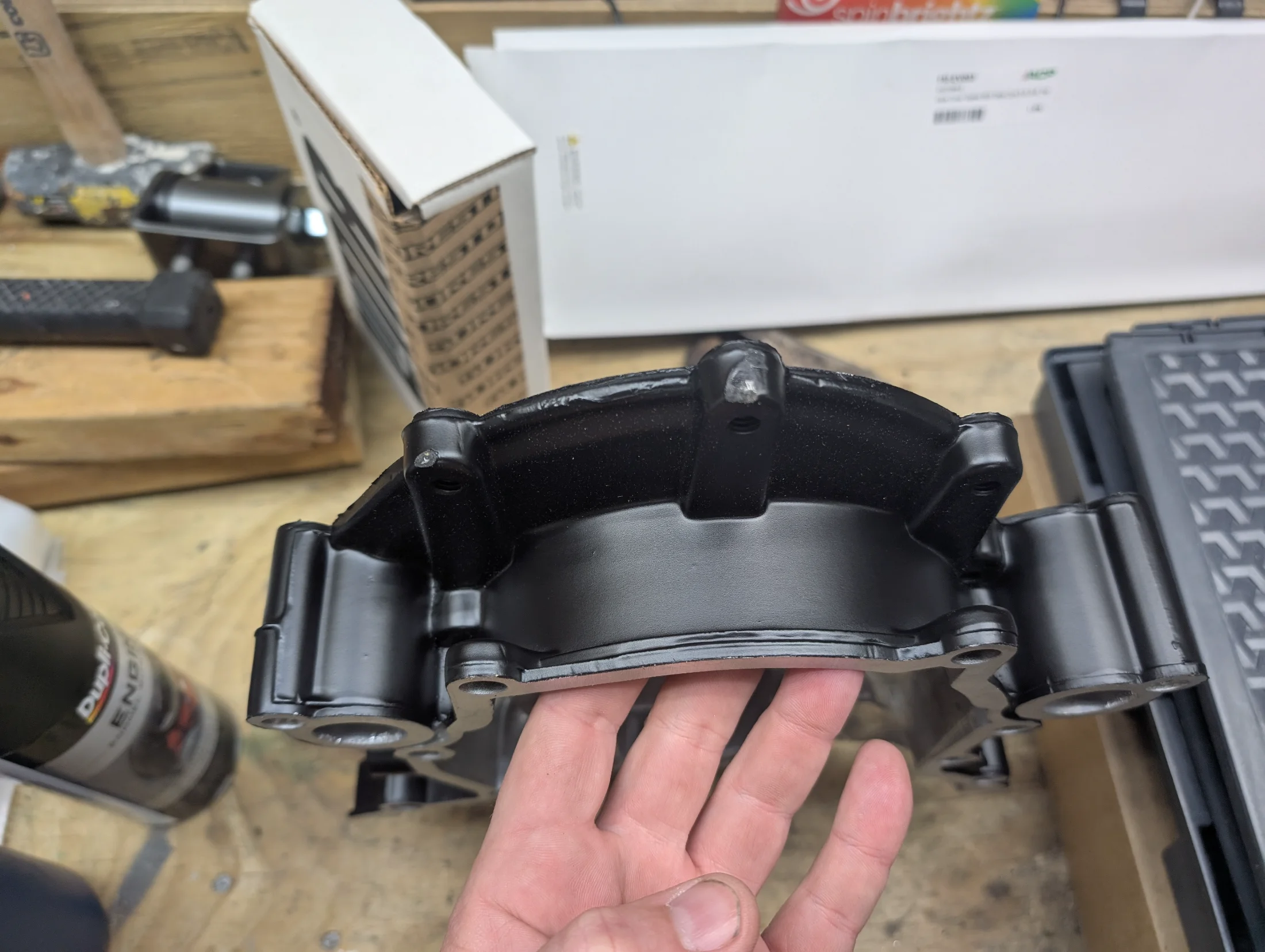

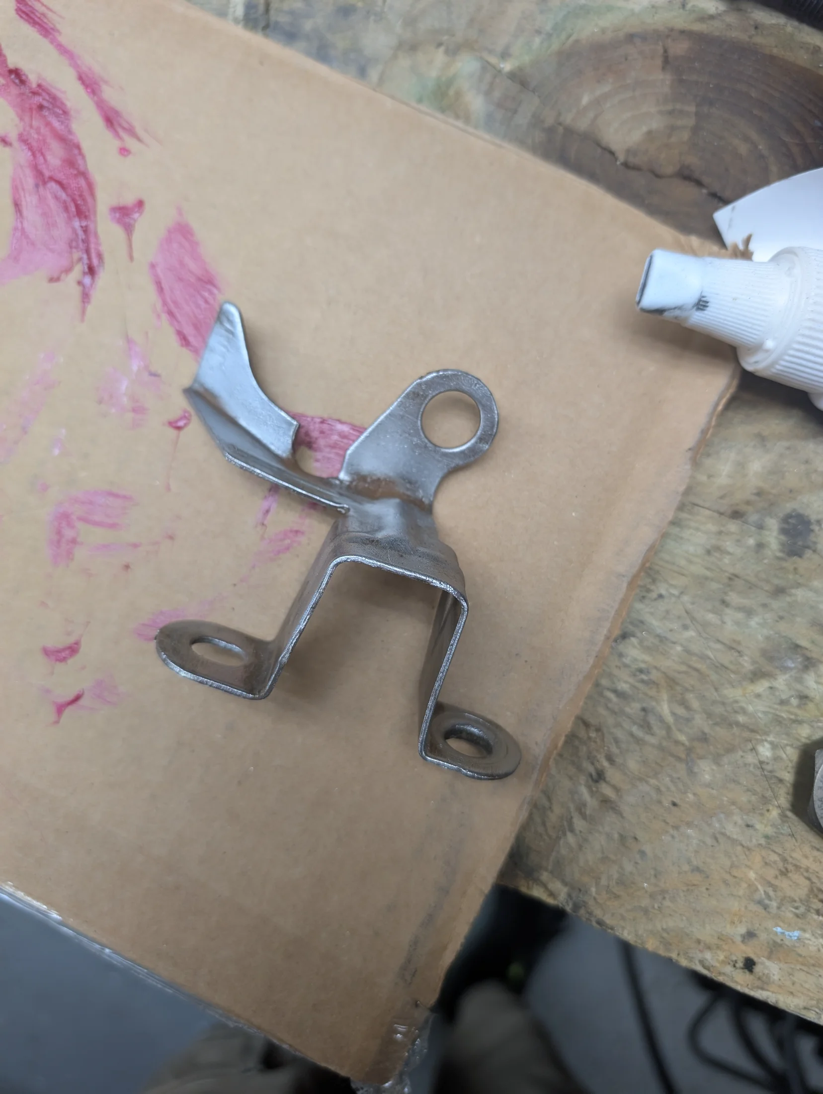

Had this over at a friend's place soaking in an ultrasonic cleaner. Wire wheeled all the remaining rust.
Hit it with some silver wheel paint. Hopefully it stays looking that good.

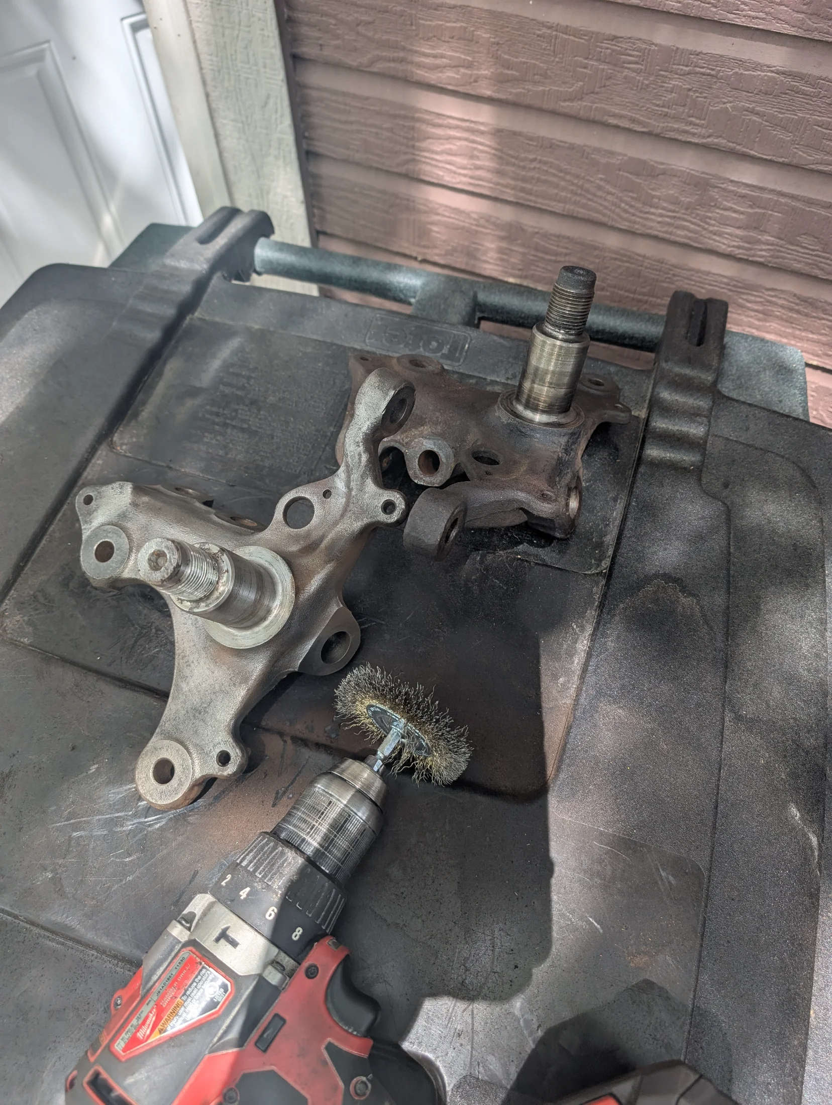

Cleaning up the spindles.
Be careful with wire wheels, kids.
Reactions: General karthief, Rdub6, gkomo and 1 other person
