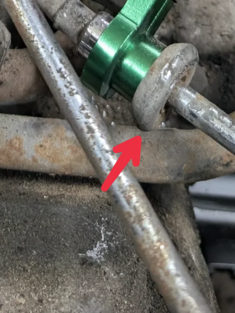

I need someone to explain to me the magic of fuel line disconnects.
These fit perfectly in the collar and I can feel the prongs being pushed in. But they will not come apart.

They can be a PITA. I'd suggest spraying some penetrating oil in them where the tool goes. Then get them moving without the tool in there. Twist, push and pull until they are moving free. Keep spraying penetrating oil to flush out the gunk and grime that is in there.
Then,
-Push the lines together
-While holding them pushed together insert the tool
-Wiggle tool and rotate while holding lines pushed together
-Pull lines apart
There is a spring in there that has to go over a lip. If the lines aren't pushed together it doesn't have room in the fitting to fully go over the lip. Also all the crud that gets built up in there takes up the space the spring need to clear the lip.
Edit:
Connector has a taper. Arrow shows widest part. Push together so spring it located in the widest part. Then insert tool. That way the spring has room to clear the lip.
Reactions: Noobz347, General karthief and gkomo

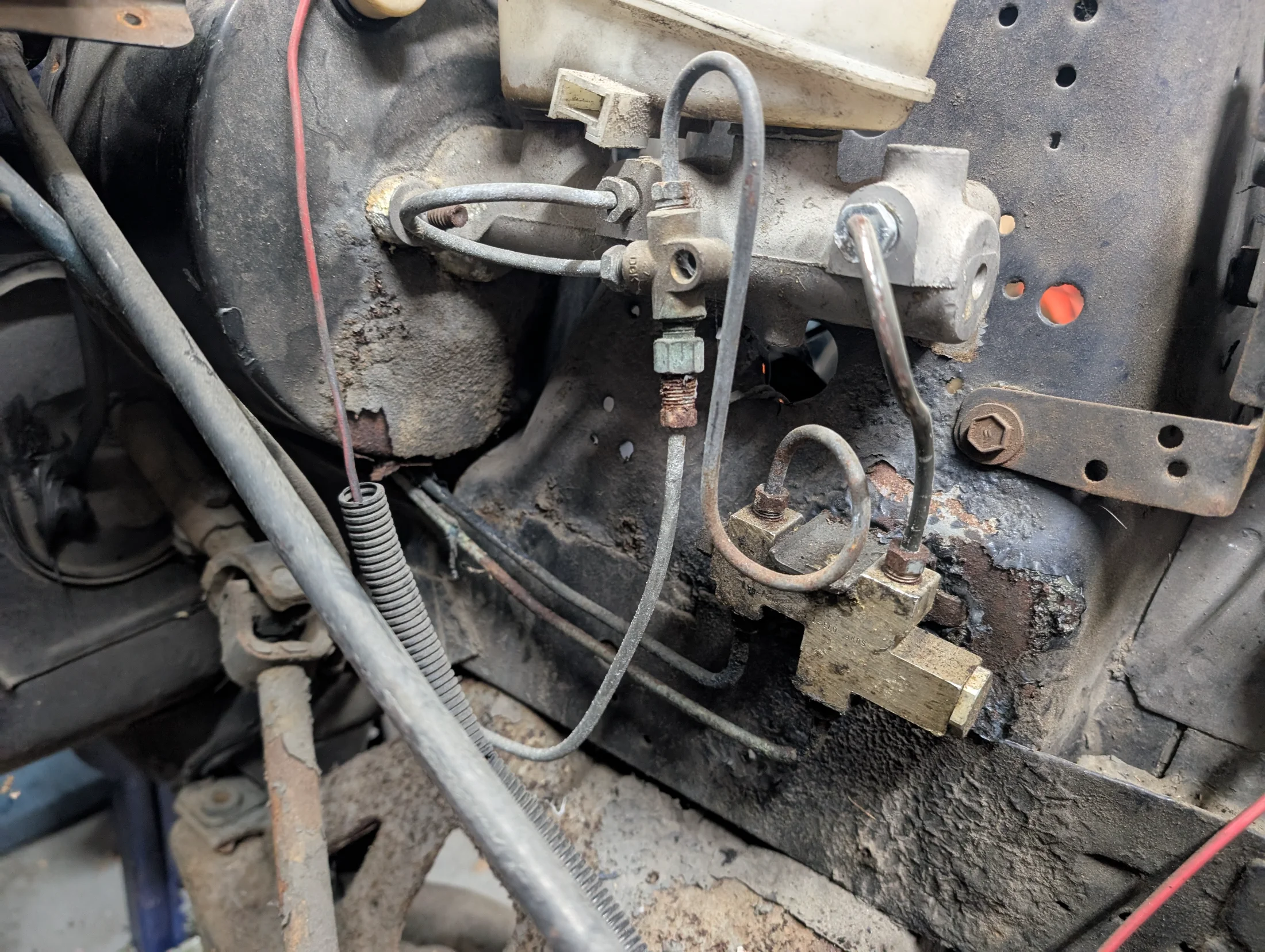

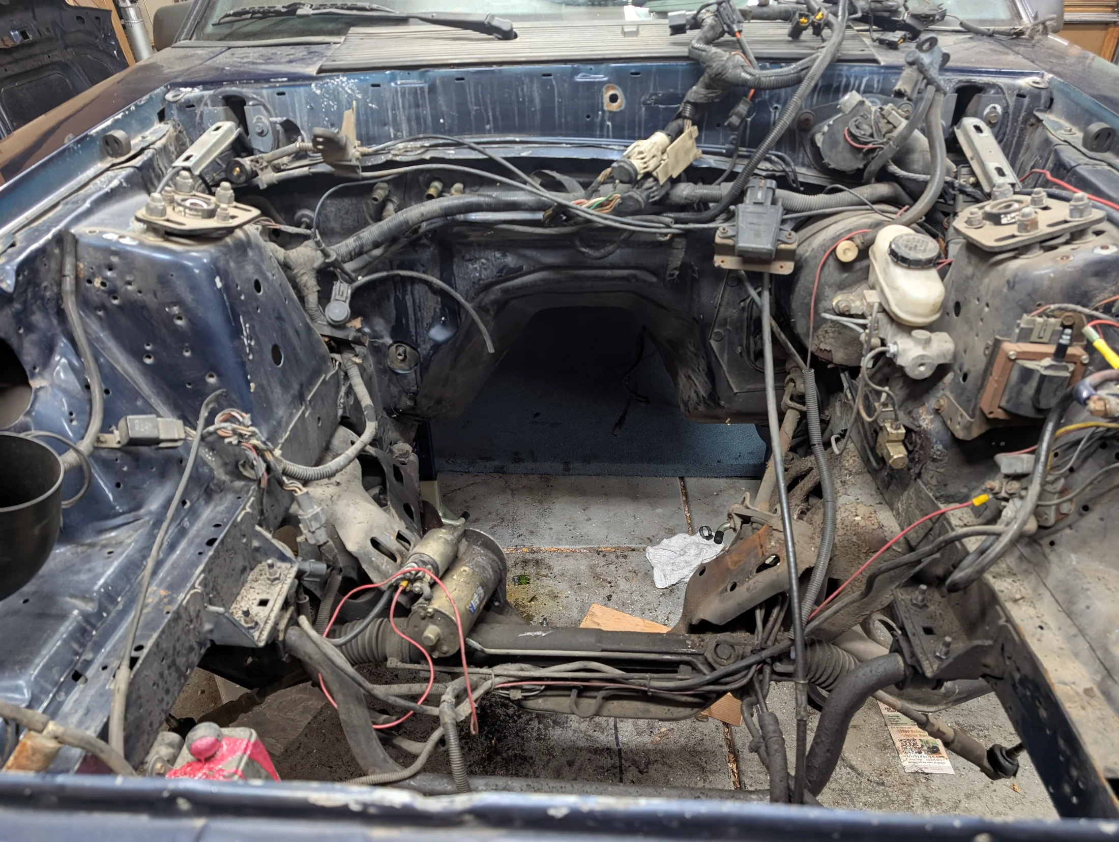

Originally, I wasn't planning on pulling it. But it appears I had a brake leak at some point.
Which has rendered certain things garbage and in need of repairs.
Reactions: 85GT4V and gkomo

gkomo said:
Further mods to the engine now that it’s out?

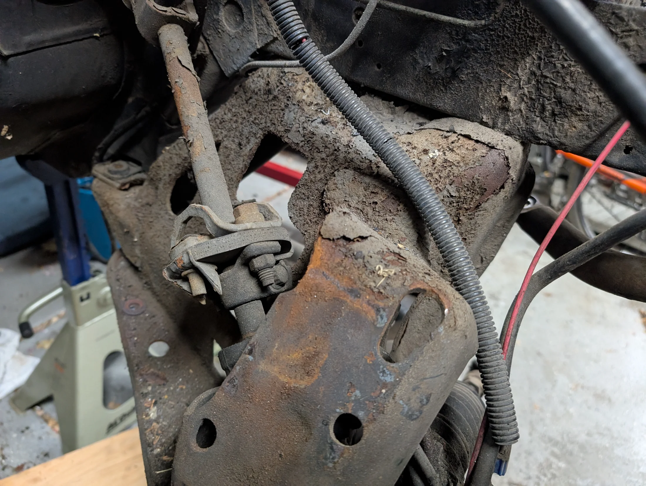

Not really. It already has a cam. I don't feel like spending the money on heads/rockers, I have a Cobra intake and long tubes for it. Gonna 1000%, seal up any potential leaks, so new oil pan gasket and bolts, new valve covers /gaskets/locking bolts.
The big thing is that the booster is so rusty at the bottom from the brake fluid that it's probably garbage, which means might as well hydroboost the brakes. All the brake lines are coming out and getting replaced with the ABS install.
Since I'm in there I'm going to do some welding of the Swiss cheese on the strut towers and repaint everything. Got some wiring to fix and extend since I want to tuck all the EGR stuff with the charcoal can in the passenger fender.
This is the last time I want to with this level. Do it right once. And I'm in no rush. It'll take however long it takes.
Reactions: gkomo, General karthief and 85GT4V

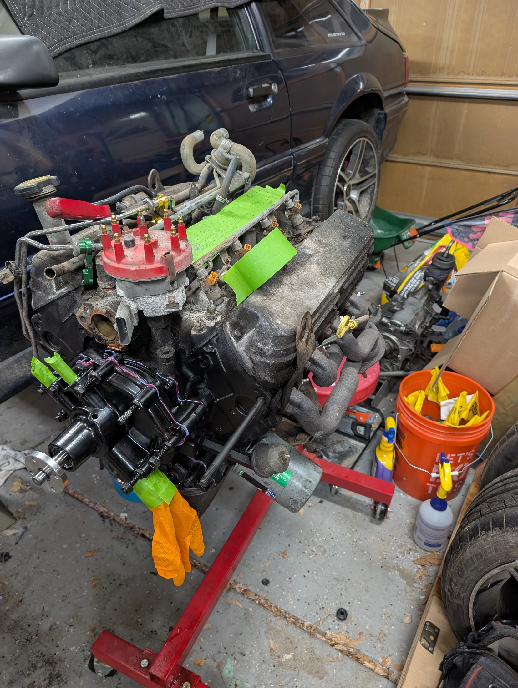

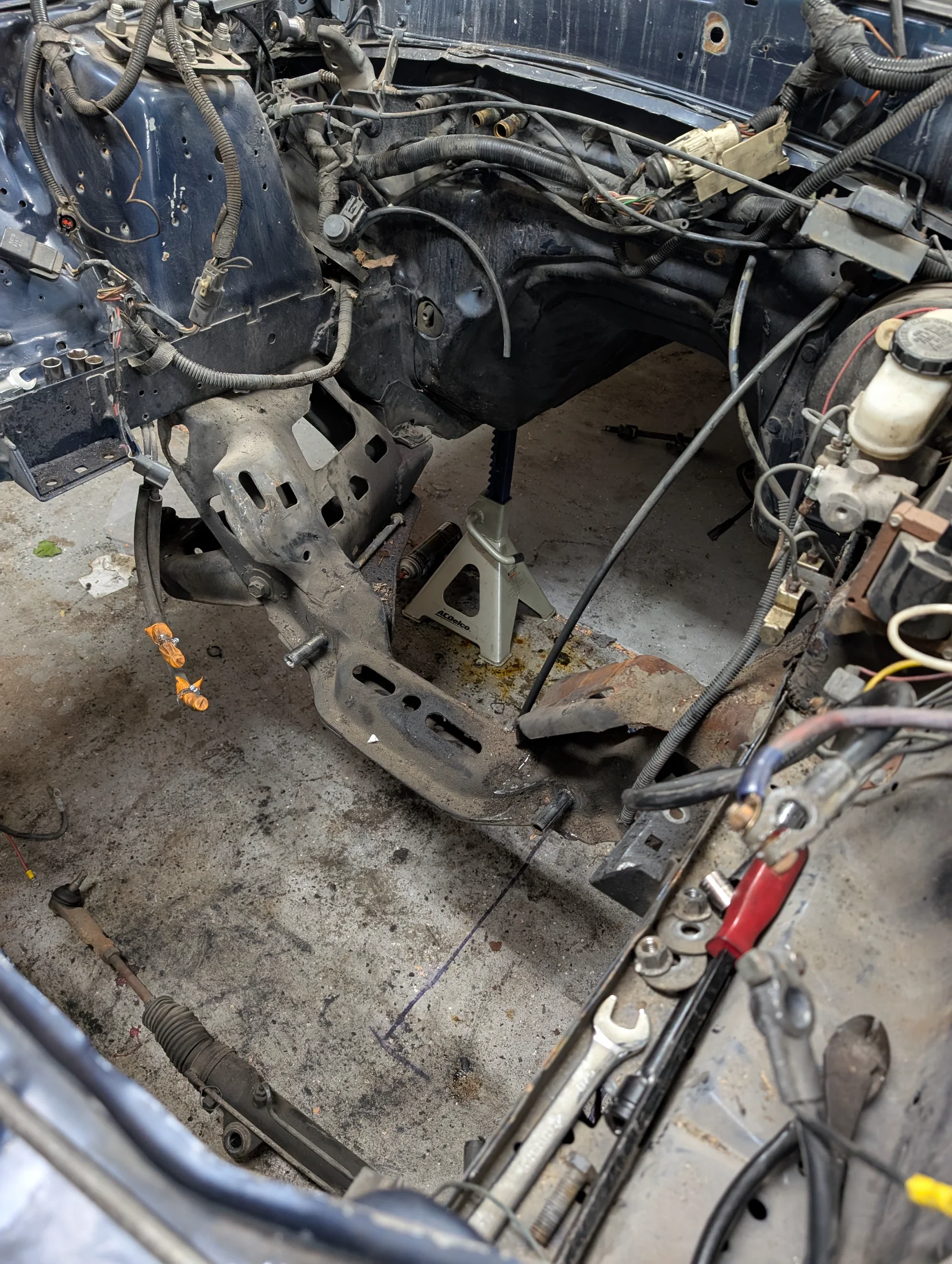

This is the 2nd time a motor has been pulled from this car. There will not be a 3rd.

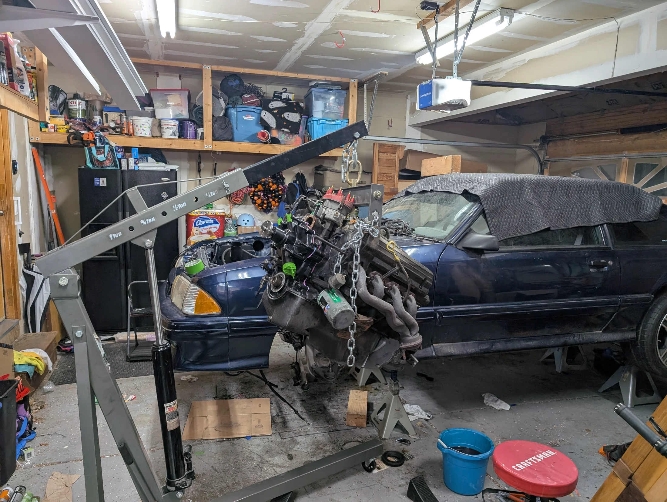

Impact getting a workout tonight

Oh. And I had ALL the power steering leaks. Every line was loose or leaking.
Reactions: General karthief and gkomo
