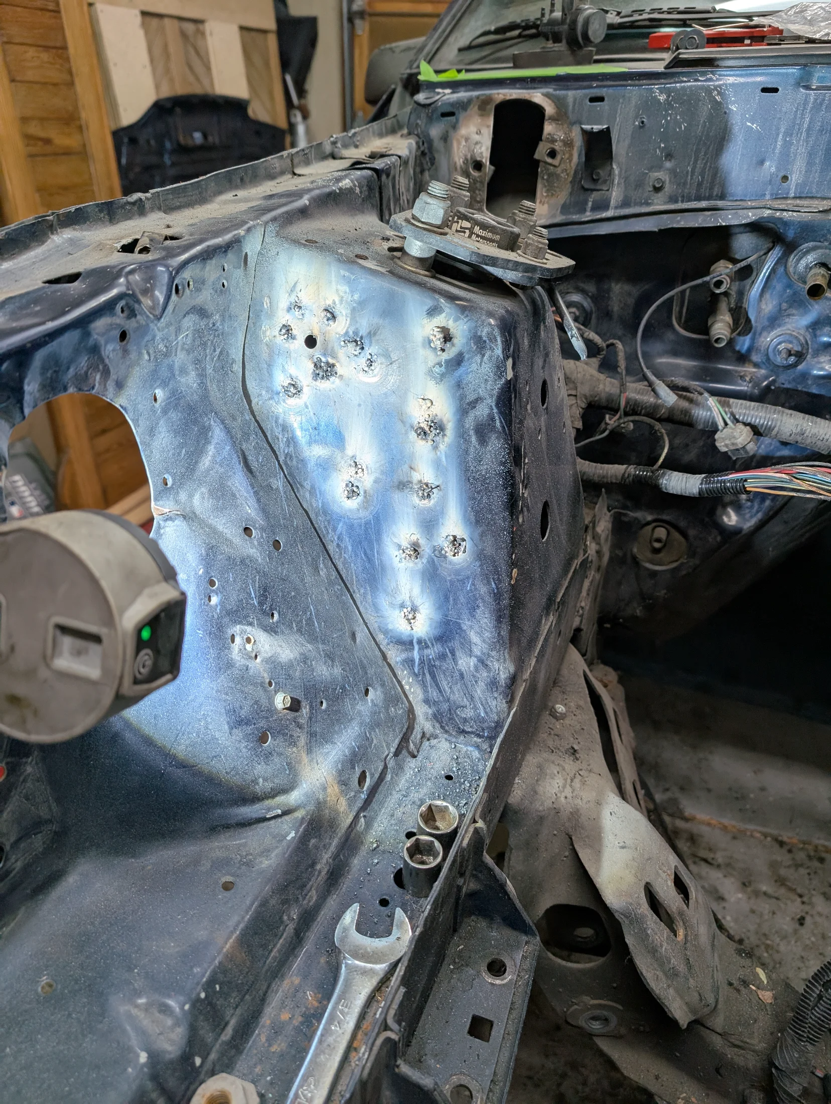

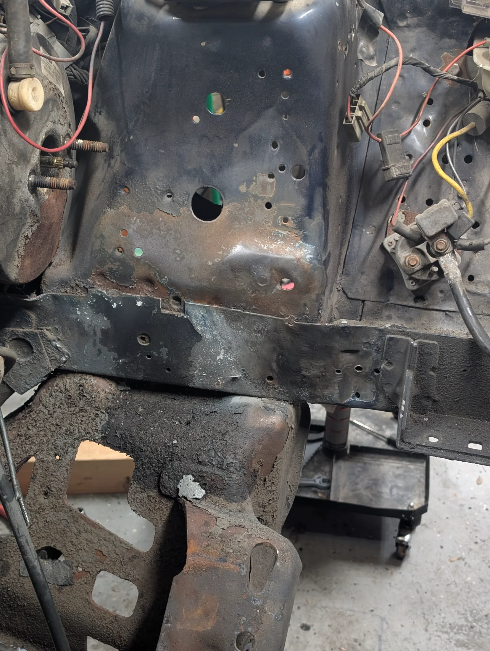

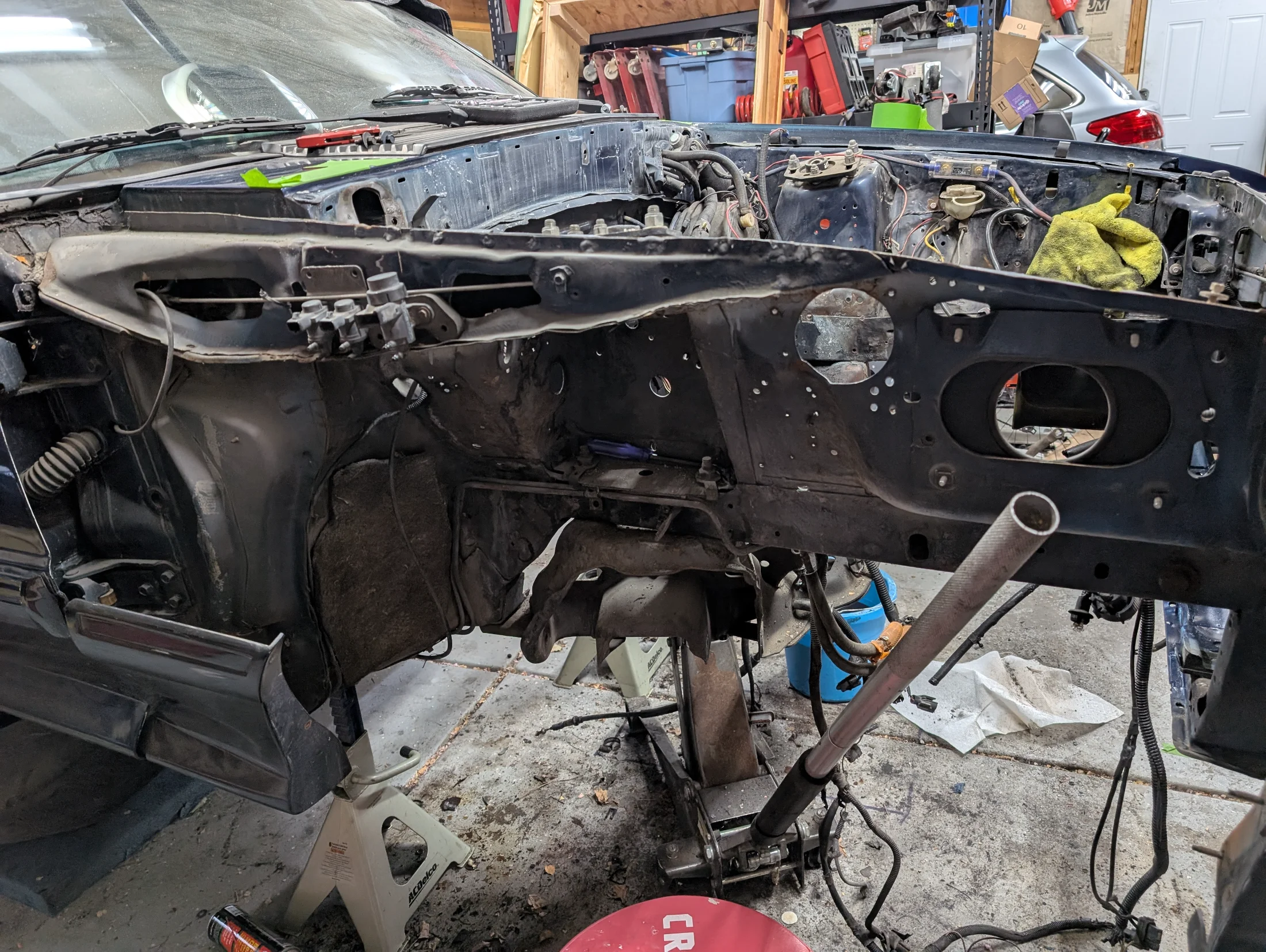

It's not as bad as it looked. Surface rust only. The inner seam of the front frame is a bit distorted. Gonna clean it as best I can. Fix the stressed weld and maybe add a few more.

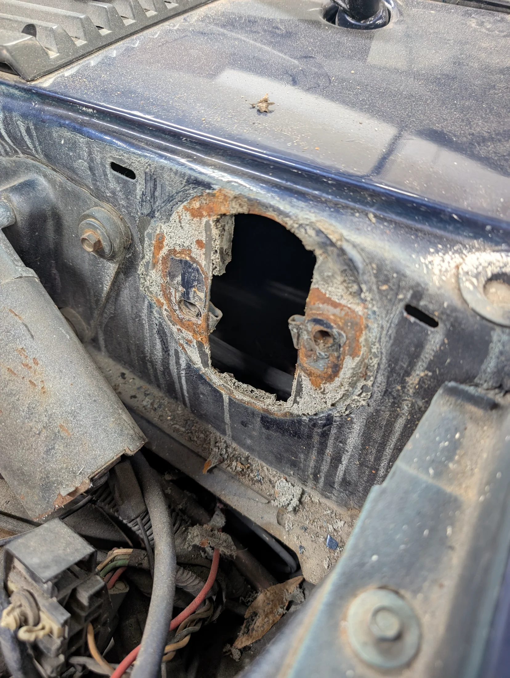

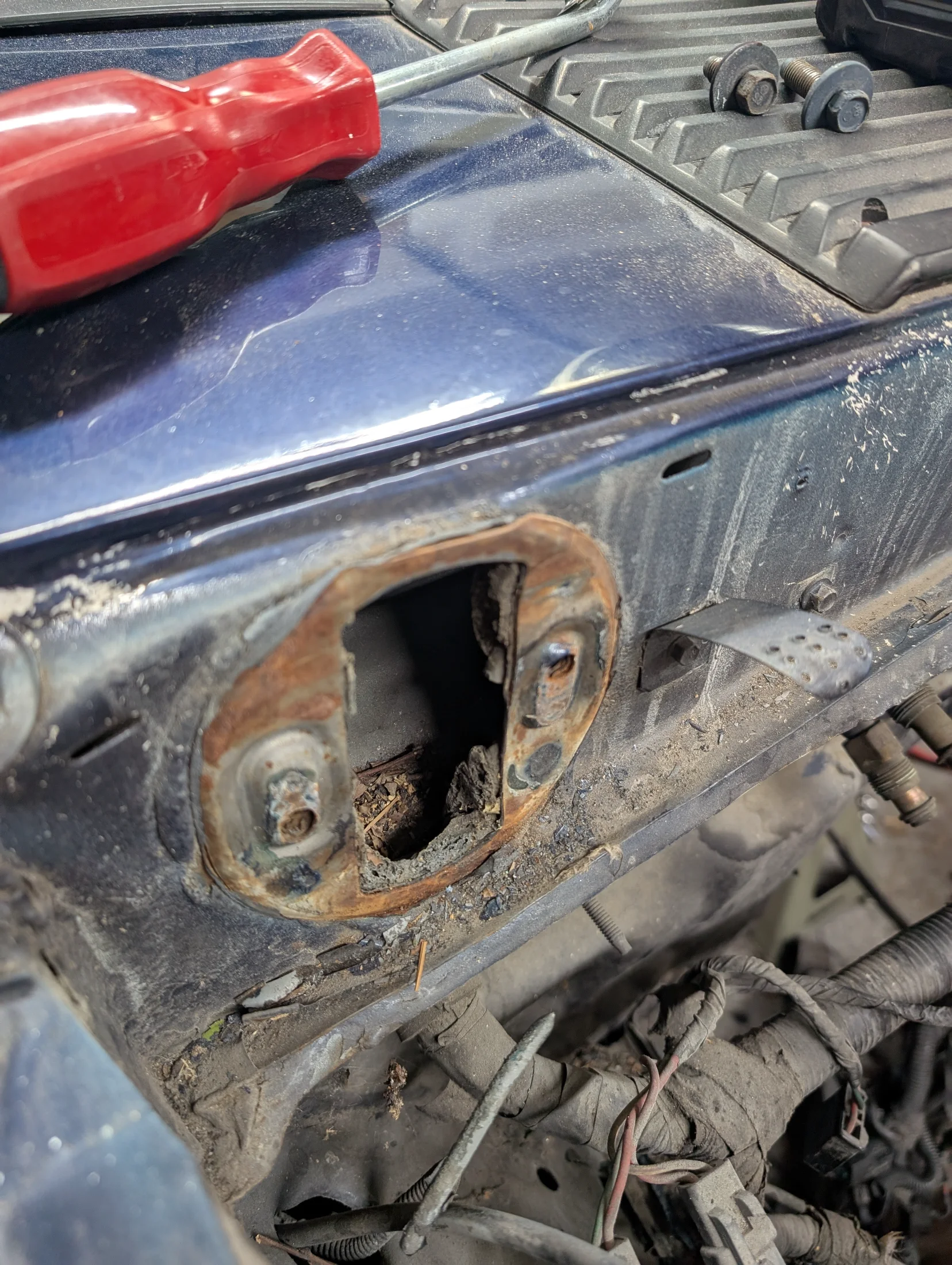

Interesting. I pulled the hood hinges. One side has a bracket.
The other side doesn't.
Obviously new hinge boots are a thing. But it feels like one side is missing a piece of metal.
Admin Dude
Jan 4, 1985
43,340
21,535
Box behind Walmart
May 30, 2025
#246
  • May 30, 2025
  • #246
It is... Somebody replaced it with nutplates.
I'll just leave this here

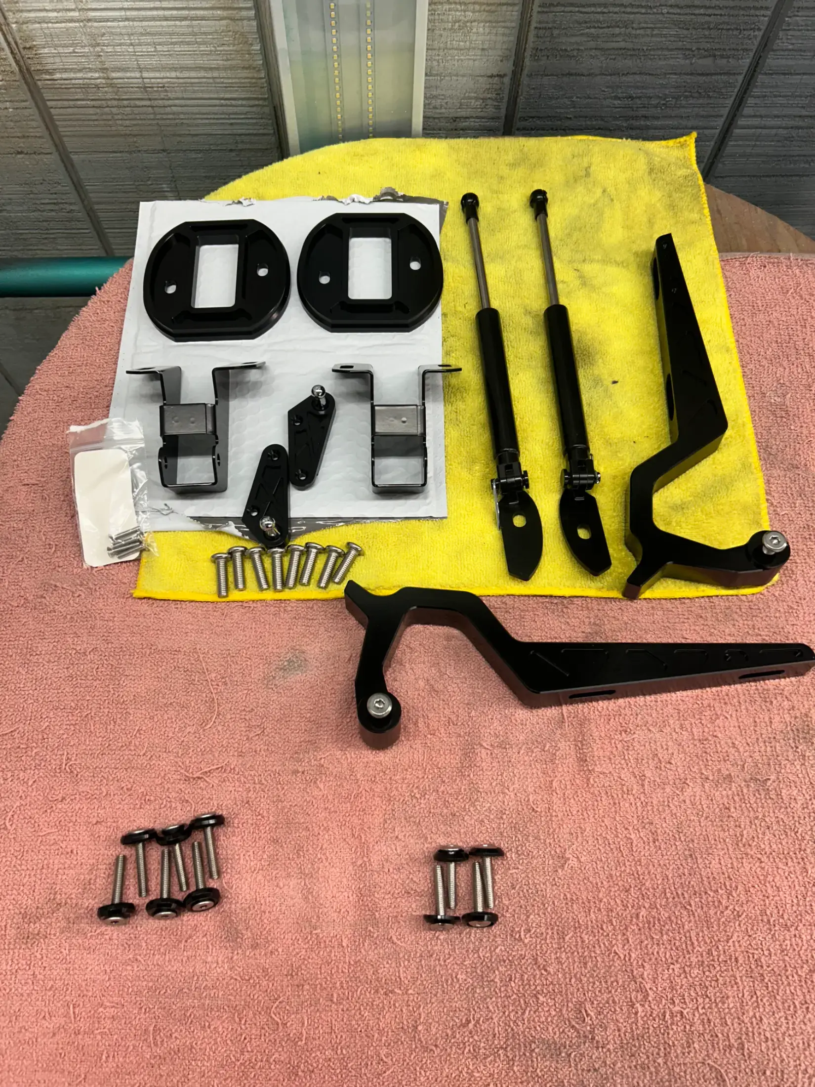

Finding a hydro boost pump was not easy. But. Done.

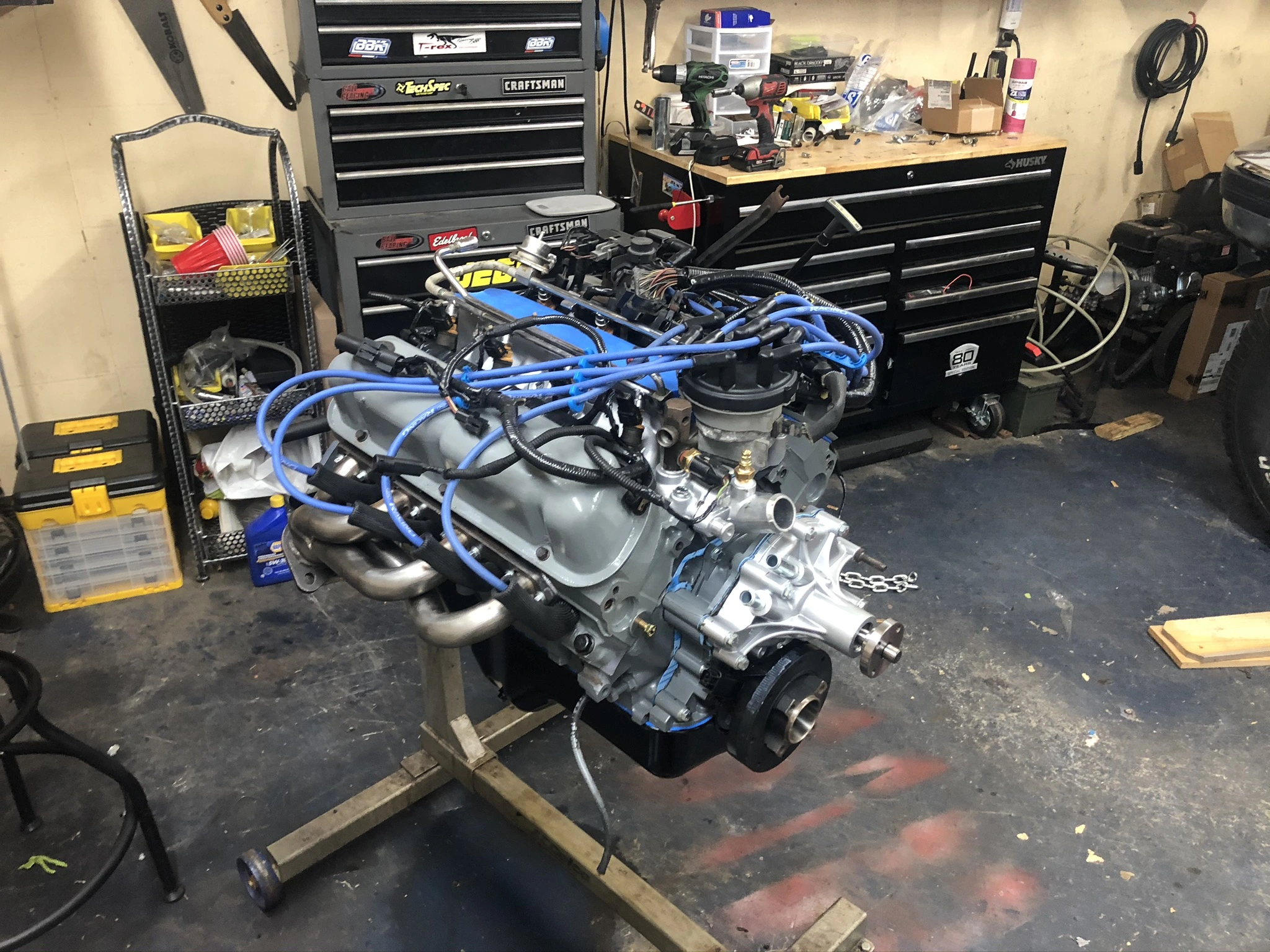

Nice. Quick tip on engine paint that I learned over the years. After clean / prep, do a final wipe with wax / grease remove (like Prep all) sprayed on a link free paper towel. Once it evaporates, use a heat gun to warm the surface being painted. First reason, if you missed any grease / oil - you'll know right quick. Also heating the surface and making the paint flow on smooth. Lots of light coats. You can use heat gun between coats, helps off gas the propellants and set it up. Here's the 302 I did for the Bronco I restored. Engine still looked great when I sold it 15K miles later.

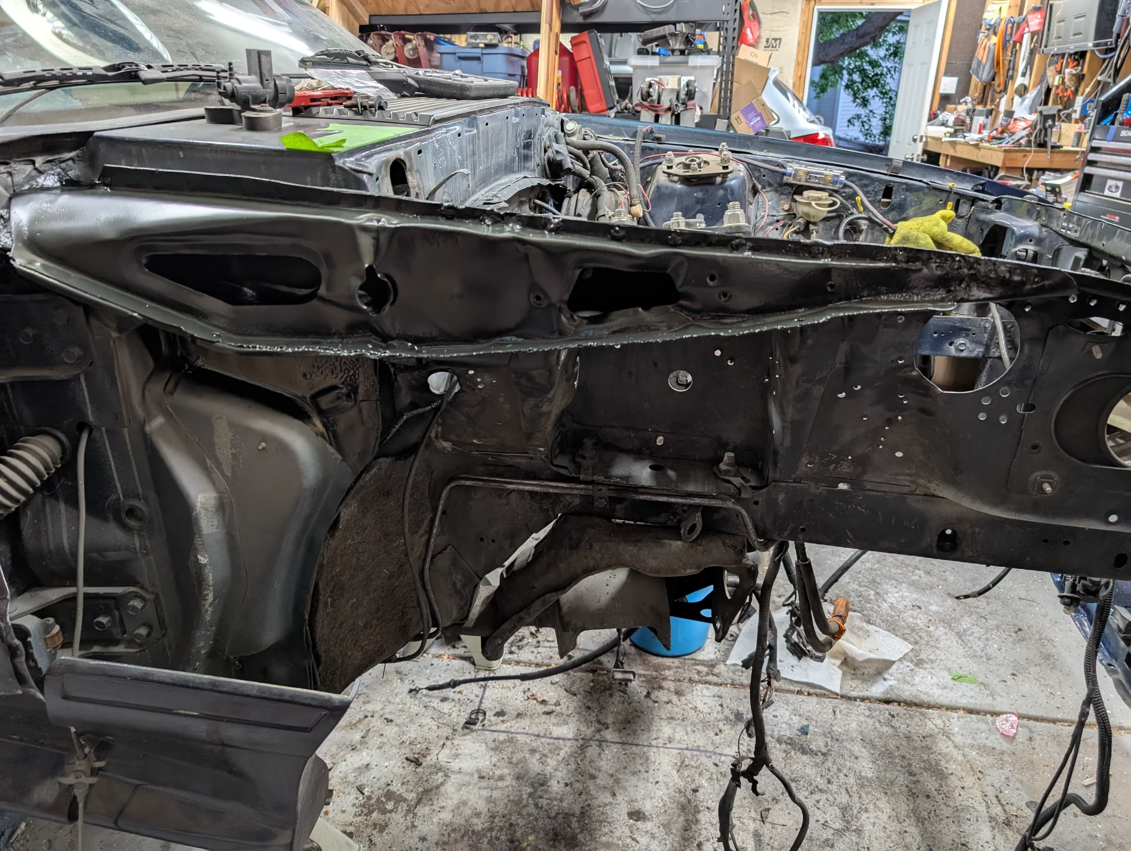

Got the fender pulled. Figured out where to mount things. New solenoids and charcoal can will be here this week. It's going to get cleaned up and painted. Probably going to stay like this till I get the Swiss cheese welded up.

3rd time ever welding something. Gonna grind it all down tomorrow and see how I did.

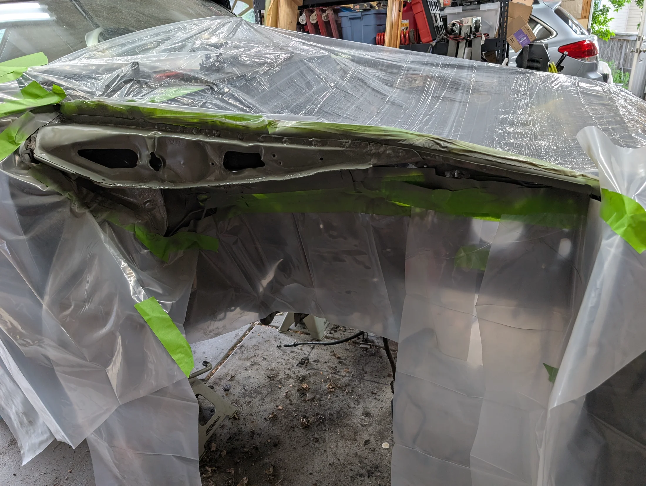

Oh! Also did some other work yesterday.
Ready to mount up the new solenoids when they get here. Gonna wait to paint the rest till the welding and grinding is done.

His thing has never been in a wreck while I've owned it, but these front frame rails have seen some .
