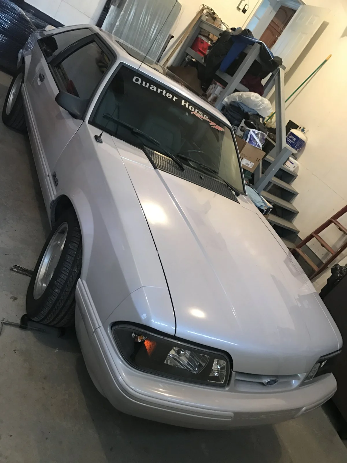

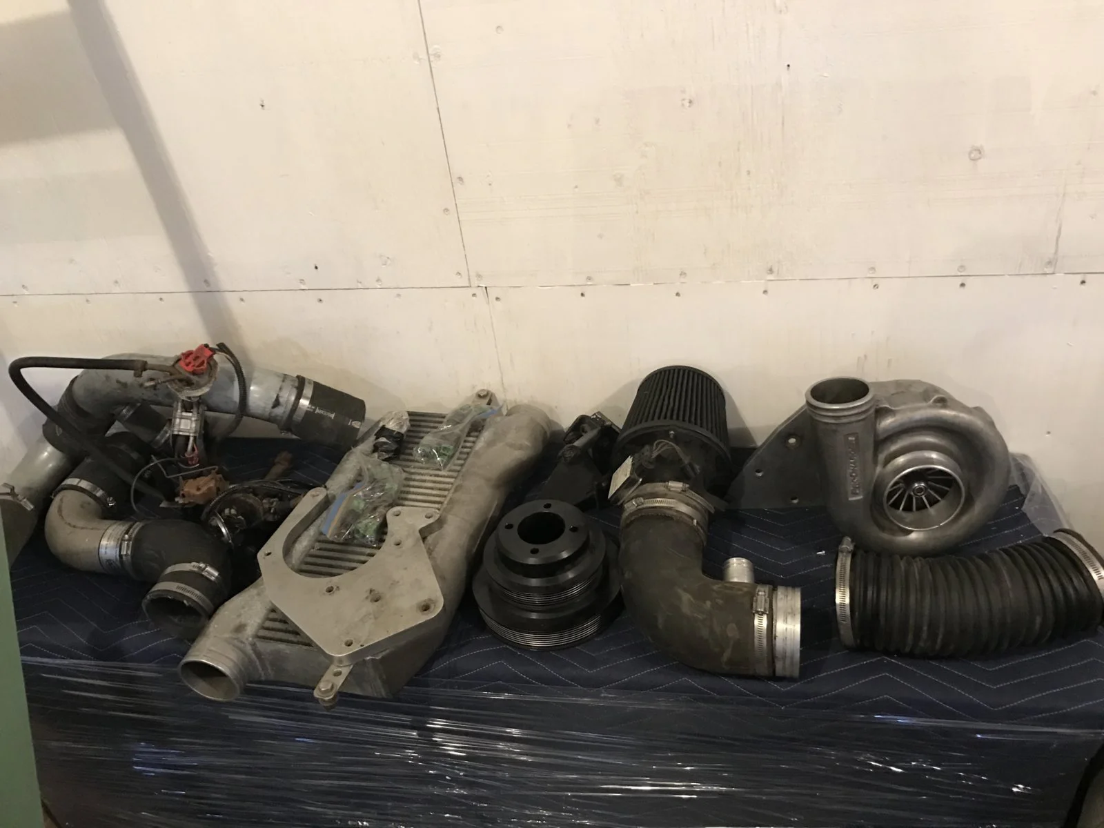

Hey guys just picked up a used pro charger kit off a buddy just wondering is there anything anyone would recommend upgrading? Or anything else on the car I should upgrade? Car has a 306 with b303 cam, trickflow tw heads ,gt40 intake and long tube headers. Trans has exteddy stage 2 clutch and rebuilt with ford racing internals and 3.73s and sub frame connectors. Any advice would greatly helpful!

I have injectors ,in tank pump and another external fuel pump that came with the set up. Is there a lot to setting up the megasquirt? I was going to swap computers apprently there's a chip added onto the computer of the car that this kit came off
