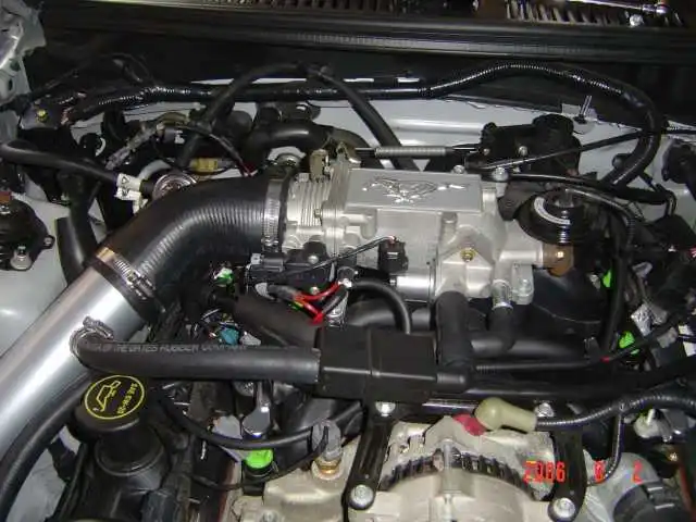

Here are some update pictures. We redid the PCV setup(wasn't necessary how we had it) and changed the vacuum T to where Rob99 has his. The car still stumbles and stutters, here's a shot of a plug that was completely clean before running all of 2 minutes.
and the engine bay, anyone see anything we somehow missed?
Would it make any difference/be safe if we were to put the stock injectors back in? The car wouldn't be driven hard obviously, until it's safely tuned. Also wanting to get the new MAF, but do you all think the car might run any different if it weren't getting saturated with fuel the instant its started up?
