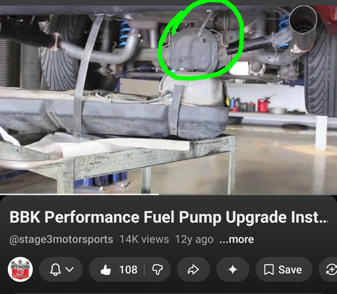

Here's a 94 95 I circled where the strap hangs that attaches the fuel pump harness and that wire that hangs I guess is grounded somewhere. I'll take a look at my other car but I broke down and see if I see anything of where that wire if it's specifically grounded right near that location if that harness that singing down is specifically grounded right there somewhere

So the first thing I did when I got home was swap the CCRM and fasten it and the car did start. Did a koeo and still got the code 511, 565, and 542 but i didn't clear the codes nor did i remove the neg post though I know it's best to. Did a koer test and got codes 411 , 412 which both are IAC related pcm cannot control the engine rpm during self test but the car was running fine during the test so not so worried about the IAC right now. I know it's often said that if your car is running and you unplug the IAC and the car wants to die, then the IAC should be doing what it is supposed to? Code 116 ECT out of normal range also. The car showed 180 on the gauge and I guess though the ecm might get a different signal than what the gauge is showing.
I think in those regards it's not the end of the world so to speak and I proceeded to take the car on a drive. It didn't feel like it was too peppy so I stopped and popped the hood. I just wanted to see how the car would do when I unplugged the IAC while running and it wanted to cut off. I unplugged the TPS and it seemed for a second it picked up speed a little and I don't think it wanted to cut off. i took it out for a quick drive and brought it back for further checks. I think my glowshift fuel gauge sensor might be faulty because it showed 27 at startup and while drivng about 23 24 and when i pulled in garage about 21. Checking the volts at the inertia and then at the pump, the fp was at about 20. After about 5 mins of the car being off I started it back up to check the volts at the pump and the fp was at about 10. I got 13 plus volts at the inertia on both wires but at the pump on 5-6 volts with the car running.
I shut the car off for about 5-10 mins and put the mechanical fp gauge back on and it was 32-33 with vaccum line on and about 37 38 with line off. With the car still warm and the glowshift gauge showing 10 with the car running at that point of the checks, the mech gauge read right.
So now to the volts situation at the pump, I'm thinking I need to go from the green and yellow wire at the inertia and run a wire to the blk/purple wire at the pump harness connector just to see if I then get 12 v at the pump. I could either cut the hot wire running from the inertia to the pump or I can splice at the green yellow by twisting in the wire very tight just for testing purposes anyway. Matter of fact I was thinking of just running the wire out of the trunk haning over the bumper and even drive it like that lol, it's just for testing and if it automatically drives awhole lot better than I will make it permanent.
Thoughts......
