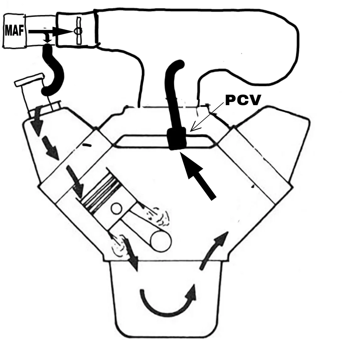

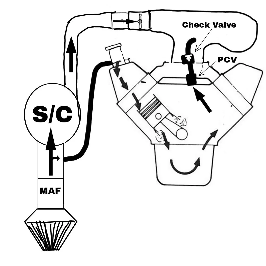

from6to8 said:
I guess you made that comment for him?
As for mine mine is currently the valve cover goes to the CAI and that is after the meter.
Running the power pipe it appears that it will also be after the meter I will just have to run a long hose that will connect to the power pipe, run it through the fender well where the pipe will be.
from6to8 said:
so at less than 6 psi will I be ok running a setup like gkomo with the check valves in 2 locations and not worry about using a breather at all or even catch can?
You only want a check valve on the line that goes from the PCV to intake manifold. That prevents boost pressure from entering the crankcase.
The PCV intake line (valve cover to fresh air intake tube) needs to be moved from its current location like you mentioned becasue now that will be pressurized. Anywhere between the MAF and S/C inlet is acceptable.
A device on the inlet line to catch any blow by oil is a good idea. That way no oil is getting sucked into your S/C inlet. A small filter that you regularly change or an oil seperator at minimum.
Should look like this cheesy photoshop I made lol:
Stock:
After Supercharger:
For some reason the Vortech kits re route the PCV inlet incorrectly to the air filter lid before the MAF. It's not right. Not sure why they do that. They put a silver fuel filter thing there to catch any oil from getting sucked through the main air filter. I think thats what Komo is referring to.
Notice how the PCV inlet line is in the same location relative to the MAF and throttle blade but in a non boosted area in the S/C image. I welded a bung to my powerpipe for it. It's in the engine bay not far from the valve cover nipple.
Reactions: from6to8 and 85GT4V

Oh gotcha and I appreciate the time to do that image, that's very helpful. So I think I got the gist of what you mean now. I guess I'll have to geta bung welded and take it to a performance shop or something who will know what I'm talking about when I tell them what I need .
So done the way Komo has it will suck in oil even though he has the filter or check valve?

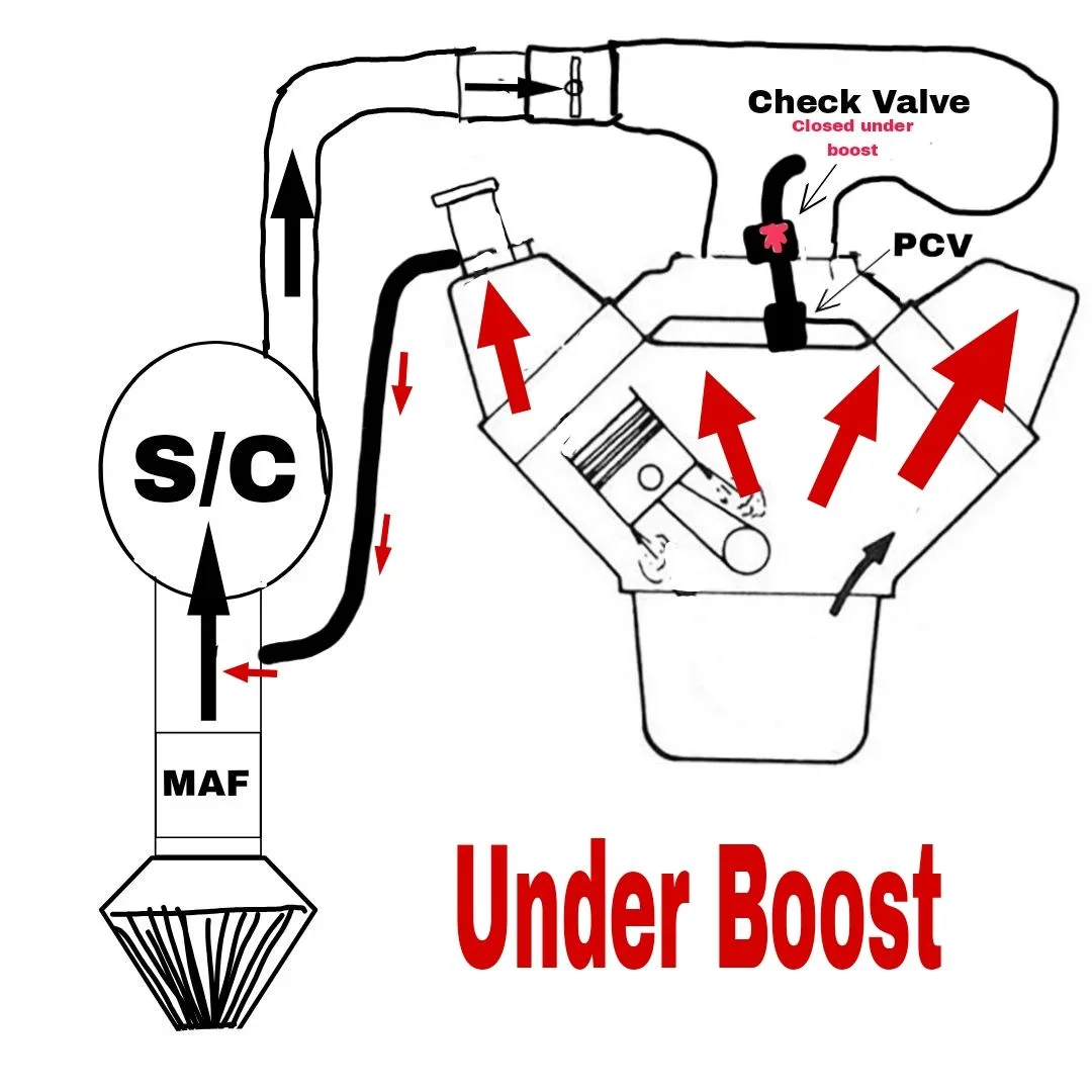

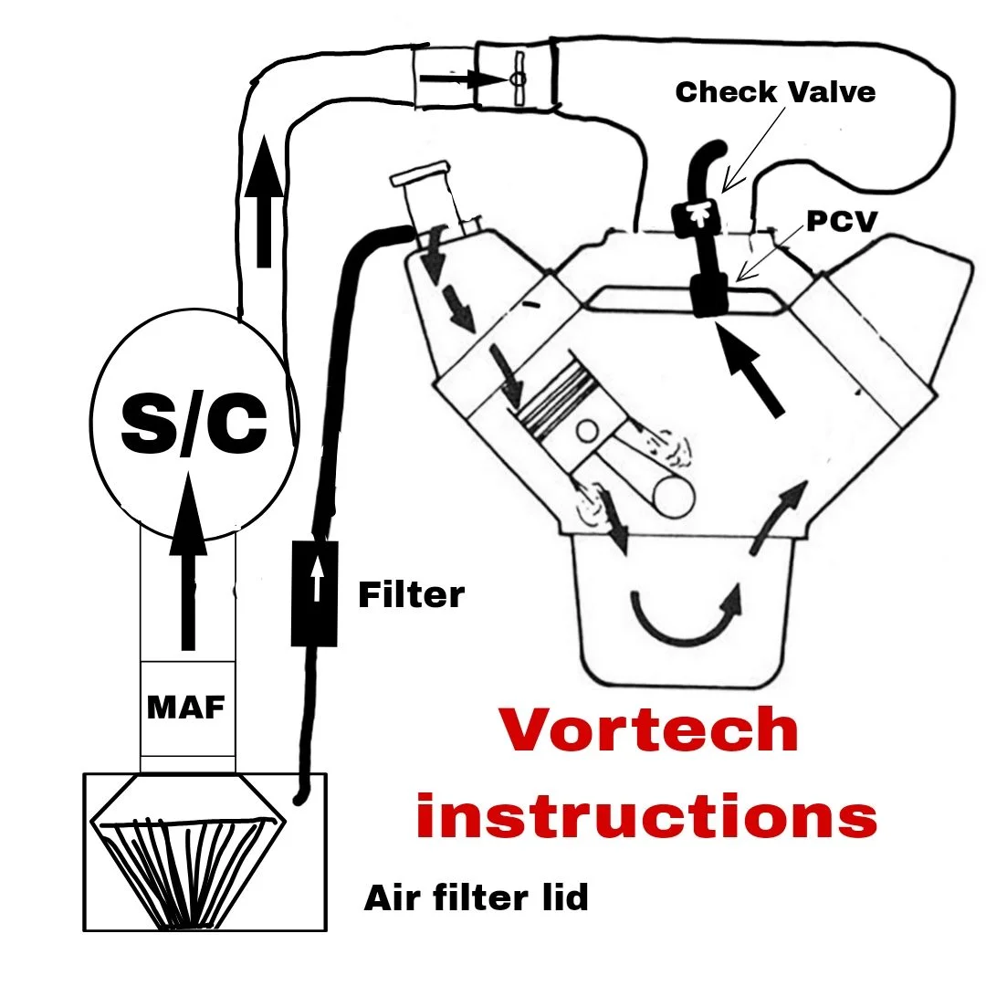

The way komo did it is how the instructions say. The PCV air inlet is moved to the air filter lid before the MAF. So as you can see below, it's sucking in un metered which isn't correct, but, I'm sure thousands of people have it that way.
See how the air going into the valve cover and through the engine then into the intake manifold to enter into the combustion process hasn't been through the MAF? That's what the term un metered air means.
Keep in mind all the images I poster previously are for when the engine is making vacuum. Idle, cruise and what not. Engine vacuum in the intake manifold behind the throttle plates is what sucks air into the PCV inlet the direction the arrows show.
When you no longer have engine vacuum, like at WOT, things change. Crankcase pressure builds and the arrows change direction. Blow by gasses fill the crankcase and look for a way out. There is no longer engine vacuum to suck them out. Because you had to install the check valve in the PCV line there is only one place for the pressure to go.
Notice below the PCV check valve is closed due to boost presure in the inake manifold. The only way for crankcase gasses to get out is through supercharger inlet. There may be oil mist mixed in. That's why you want a filter or seperator to catch it.
(You can also see why you wouldn't want a check valve there.)

The only difference in @nicholase "Vortech Instructions" diagram, assuming the arrow on the PCV "filter" in the diagram is the flow of air, i have my arrow pointing towards the air filter box, not towards the engine. So with the check valve there, no unmetered air can come back into the engine/VC, but excess pressure from the engine can escape back to the air filter.
