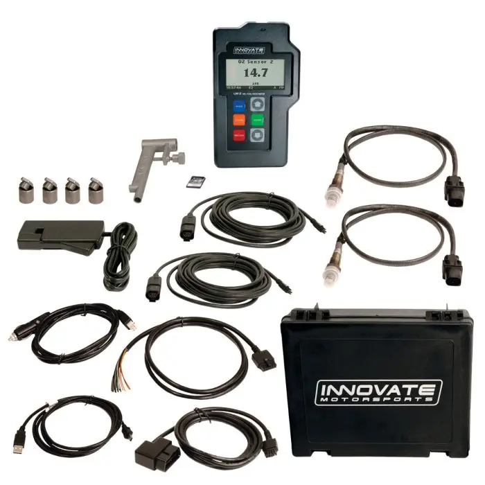

If I were to pick one up today knowing that my 'chip-tune' has no capacity to data-log:
  • 100 pct. Digital Wideband Air/Fuel Ratio Technology
  • 2 Configurable Linear Analog Outputs
  • 4 Fully-Differential Analog Inputs
  • Built-In RPM Converter [Direct Freq. or w/Opt. Inductive Clamp]
  • Large High-Contrast Graphics LCD
  • Log Directly To SD Card
  • OBDII Scan Tool-Read/Clear DTCs and Log Up to 16 Channels
  • Patented DirectDigital™ Wideband Sensor Control
  • Playback Log Data On Screen And/Or w/Powerful LogWorks Software
  • Single or Dual Channel A/F Version Available
The "2 Configurable Linear Analog Outputs" are so that you can use the wideband to spit out narrowband O2 sensor signals to the ECU instead of running extra sensors and bungs for wide and narrow band sensors. Your ECU (regardless of the chip that tunes it) is not capable of interpreting wideband signals.

I have mine installed with one sensor and have left the two narrow-band sensors to do ECU [things]. So, I have two narrow band sensors for the ECU and one wideband sensor for the LM-1.
Alternatively, I could install two wideband sensors and send the 5 Volt outputs to the EEC.
Back in the day, I think I would have needed to run two LM-1 units (but it's been a long time and I don't recall all the details).
With the LM2, you can run 2 sensors --and-- already have the 5 Volt outputs built-in to the machine. This is probably how I would go, today.
Now... There [are] other companies with widebands have the same or similar functionality. I refer to the Innovate products because they are what I am most familiar with.

from6to8 said:
Okay I need to call Scott and talk to him in the morning to get the gist of all of this because all he told me was I needed to buy a digital wideband gauge. I guess the gauge comes with all that stuff.
The vagueness in terms have become customary for some reason.
A "wideband gauge" does exactly horse . Lots of people have come through this forum looking for a way to hook their "wideband gauge" up to their narrow band sensor thinking that was going to give them something. What they got was a useless light show.
A wideband meter, complete with wideband sensor, is capable (in most cases but not all) of feeding a wideband gauge.
Most wideband systems today, come with their own gauge. This is why I do not own those systems. I want my gauge to match so I bought a system that allowed me to add my own gauge and not use their "digital nightmare LED Christmas tree color cornucopia". I wanted plain, white-face, analog to match my Kenne Bell gauges. No digital BS in my 80's cockpit please.

You need to know what AFR you are going to install but in general I would think you could find all kinds of videos on youtube for the install.
yeah gotta see what all is involved to feel comfortable doing it. I mean it's nothing to take the X off and have take it to get a bung welded but I'll need to know exactly where it needs to be welded.
lol I wouldn't mind that one gauge being digital as he said it'll be easier to an more accurate vs reading the number dial lol. I have autometer c2 gauges so yes matching them up is nice. I'm curious to see what he says tomorrow as to what he meant by what he told me to by.
They need to be installed in a portion of the pipe that runs down-hill and in a position between say, 8 and 4 o'clock.
So, header or pre-cat mid-pipe. Usually, in the pipe that connects to the X.
Lot's of people like them. Not bad-mouthing them (ok... yes I am ). Just not my kind of music.
I'm catless........
