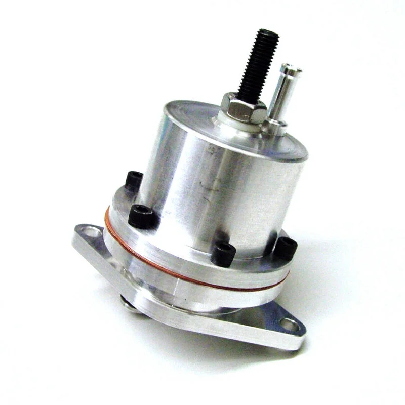

with this kirban style fuel pressure regulator that I have ( had it for quite some time), where would I tap in for the electric fuel pressure gauge that's going inside the car? I have a fp gauge at the fuel rails under the hood and don't see where on the fp regulator that I would tap in.
edit: disregard I will just remove the gauge at the fuel rail and put the sender there.

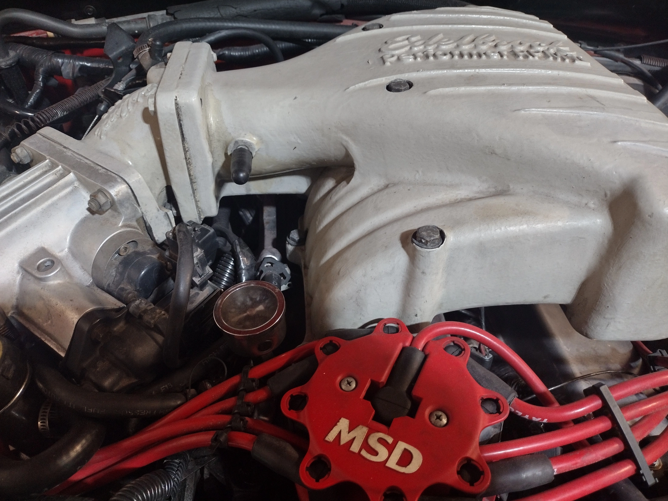

I do have another question about the boost gauge though. I've read do not use the plastic line that comes with the gauge but instead rubber or braided. It seems a lot use rubber and that's what I'll use. The pic is just in ref to my question about which brass nipple to use to connect? I saw an old thread from 2012 where a few said to use a brass nipple and with a barb.
Curious if the I.D. of the hose has to be the same as the plastic hose, looking at the inside of the stud on back of the gauge?

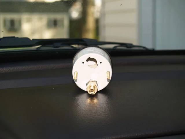

  • Rear of Boost gauge for reference using rubber hose and how to connect to vs using the plasti...webp

saw another post somewhere where some said just get a hose size that will fit over the fitting on the guage. If I can run that to the front of my intake then that'll be perfect. There's a spot on the front of my upper that is capped.

I think that the "barb" you are talking about is this:
Miniature Inline Orifice Restrictor
Inline Orifice Restrictor, .020 Orifice, 1/8 ID Hose Barb X 1/8 ID Hose Barb, Blue Polysulfone Body
www.universalpowerconversion.com
You run the hose from the back of the gauge to your intake manifold.
I did not use the clear hose. Instead, I used part of a roll of black vacuum line that I keep on-hand. I also included a small section of slightly larger hose that used to hold onto a metal orifice drilled out to 0.030 in. or something.
The barb in the link above includes this orifice and [Yes] you need a restrictor. Otherwise, your vac gauge becomes a vac leak.
There are different size orifices that allow you to 'tune' the gauge to make it smooth.
My gauge came [with] the tiny metal orifice.

is that restrictor only needed when not using the clear hose? Otherwise, I might just use the clear hose .
I don't need no extra headaches or things to worry about lol. Like tuning the gauge to make it smooth, finding the right orifice, ect.

I think you have to use it anyway. The hose is large enough to fit over the port on the gauge. That's too large [unless] the gauge has a restrictor already.
Refer to the instructions for the gauge.

Because running the clear hose you should not have to run or add anything extra I would think

That's why i was researching and no one said anything about having to run a restrictor. The first thread that I was in someone just said run a rubber hose and the guy asked just use a brass nipple and then the person replied yes .
No other information in that particular thread. Some of the other threads I didn't read anything special either

Just called autometer to ask them about using rubber or braided and he said they've been using the plastic for decades with no issues and they are designed for that environment. He also said they don't recommend rubber because they can collapse. Said folks use braided for I forgot what he said but that not for vacuum boost.
I guess all in all it's proof folks can and have used rubber with no issues but I'll stick with what comes with the gauge..

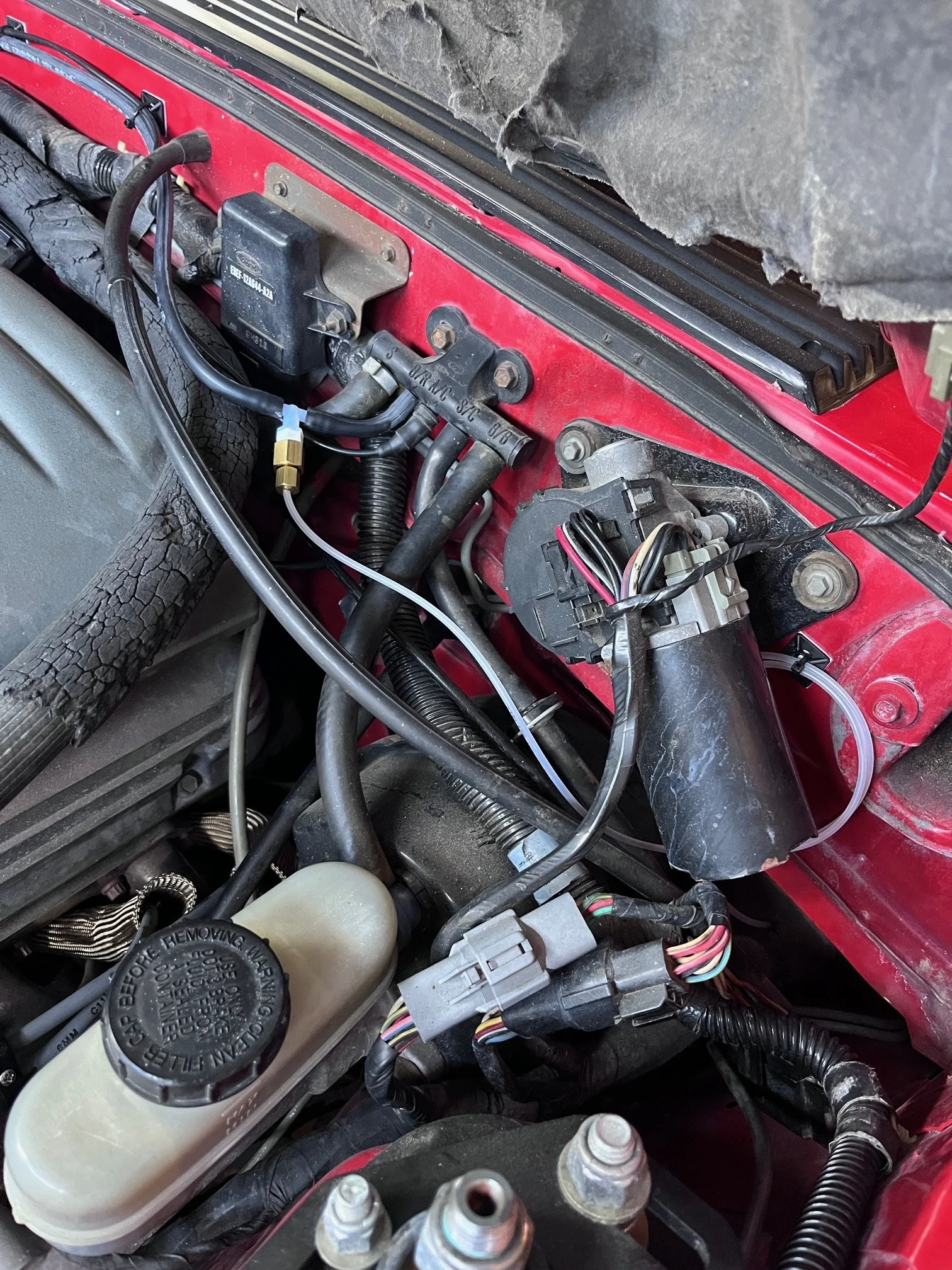

Nothing wrong with the plastic tubing. Here you can see mine 't'd off from the B/R port. I coiled up the excess behind whatever that motor thing is:
Yes I'm going to run it. I just looked at my car and I was thinking about the port on the front of the intake but even if I were to do that running that plastic tube there would not work because it's going to kink I mean I would have to almost run it you know all over the front of the engine bay to where it would not kink and that will not work lol.
So your spot looks like the most logical and I did see some other people running it there earlier today when I did some research.

The B/R port is usually capped off (not used), but that's where my FMU vacuum line goes to. Are you planning on running an FMU? If not, i think you can run the boost line off any other vacuum line (don't quote me on that though).
