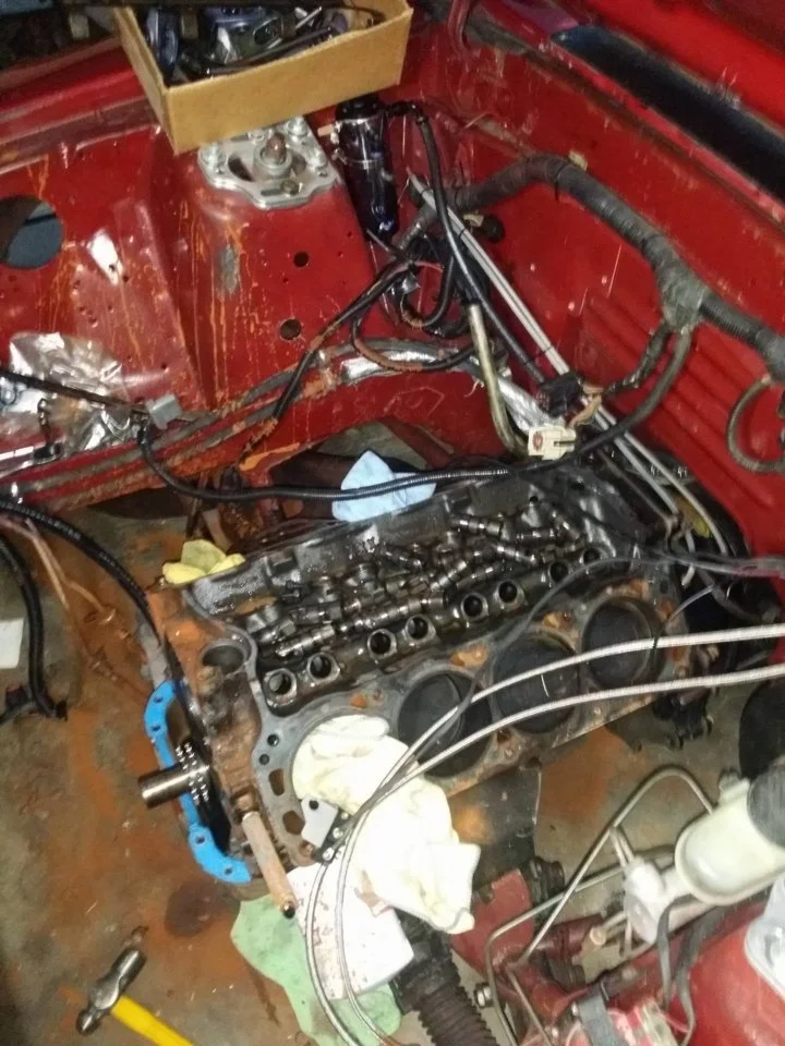

so after the race in novemeber where i pussied out and pulled a bunch of extra timing and chattered the tires i started pulling everything apart.

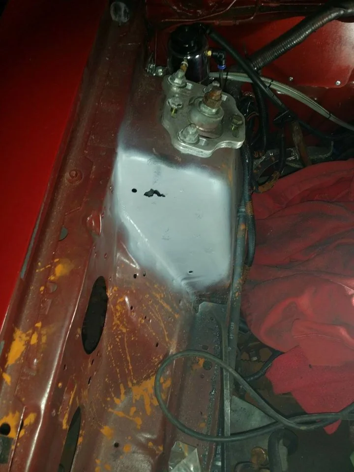

ive started welding up the strut towers and as you can see where the metal is stretched a lot its blowing holes in it. so i had to order a the stuff to start tig welding. and at that point i will start back on that.

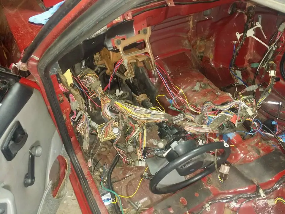

ive stripped most of the interior out of the car need to get the rest of the harness out of it and start working on figuring out what wires do the brake lights tail lights head lights and parking lights.
next step is cutting the floors up to do thru the floor subframes and cut my full length ones off. as well as straightening out the factory frame rails.

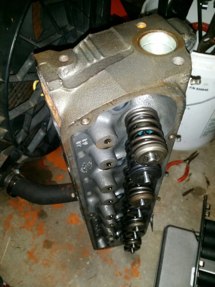

pretty much down to some flow masters
short block
GT40 heads
coil
and some random small :poo:
