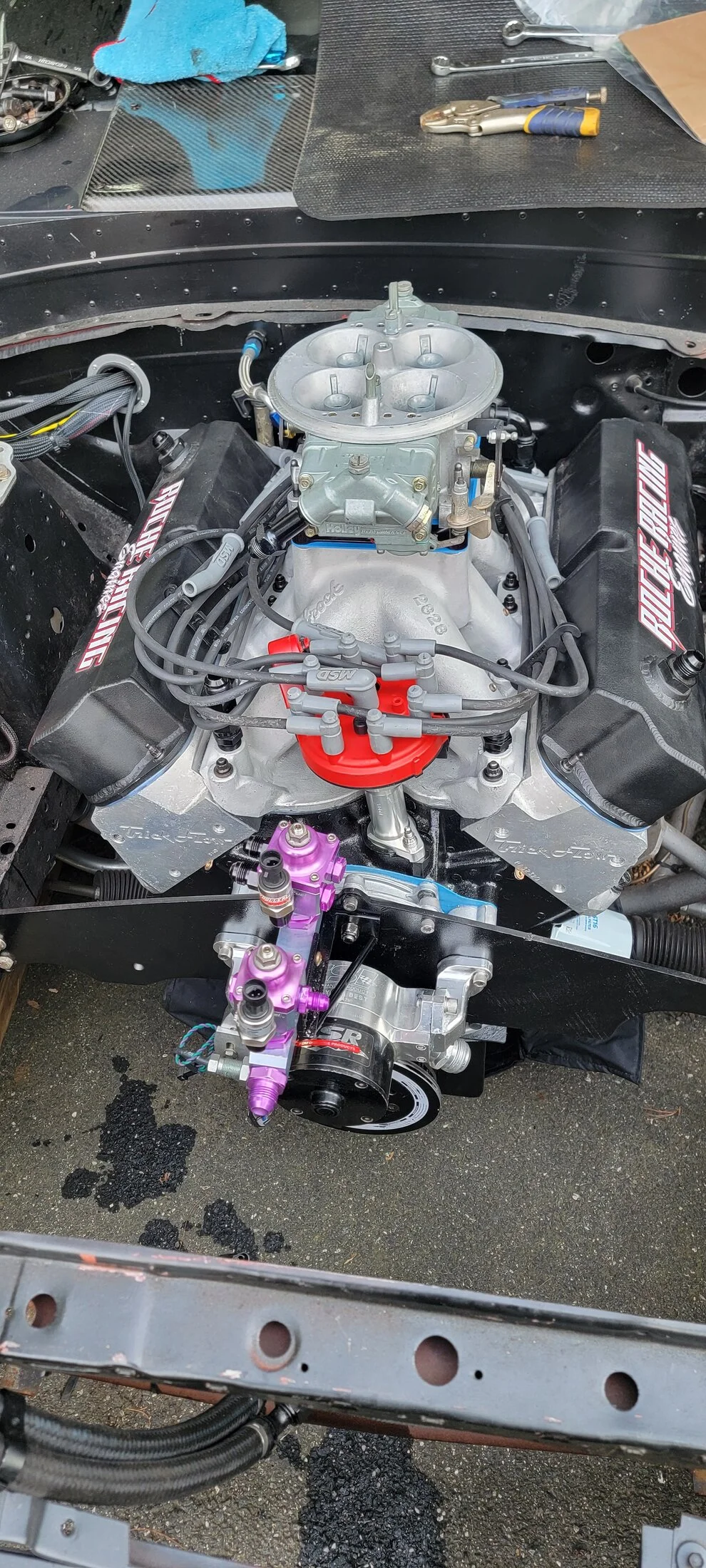

Definitely kicked my ass getting it this far today by myself.
Had to make new fuel lines to the regulator and to the carb. Also need to make a new line from the cell to the pump. So no oil pressure yet :(
Trying to make customer appreciation day at CJponyparts Saturday so I'm still pushing

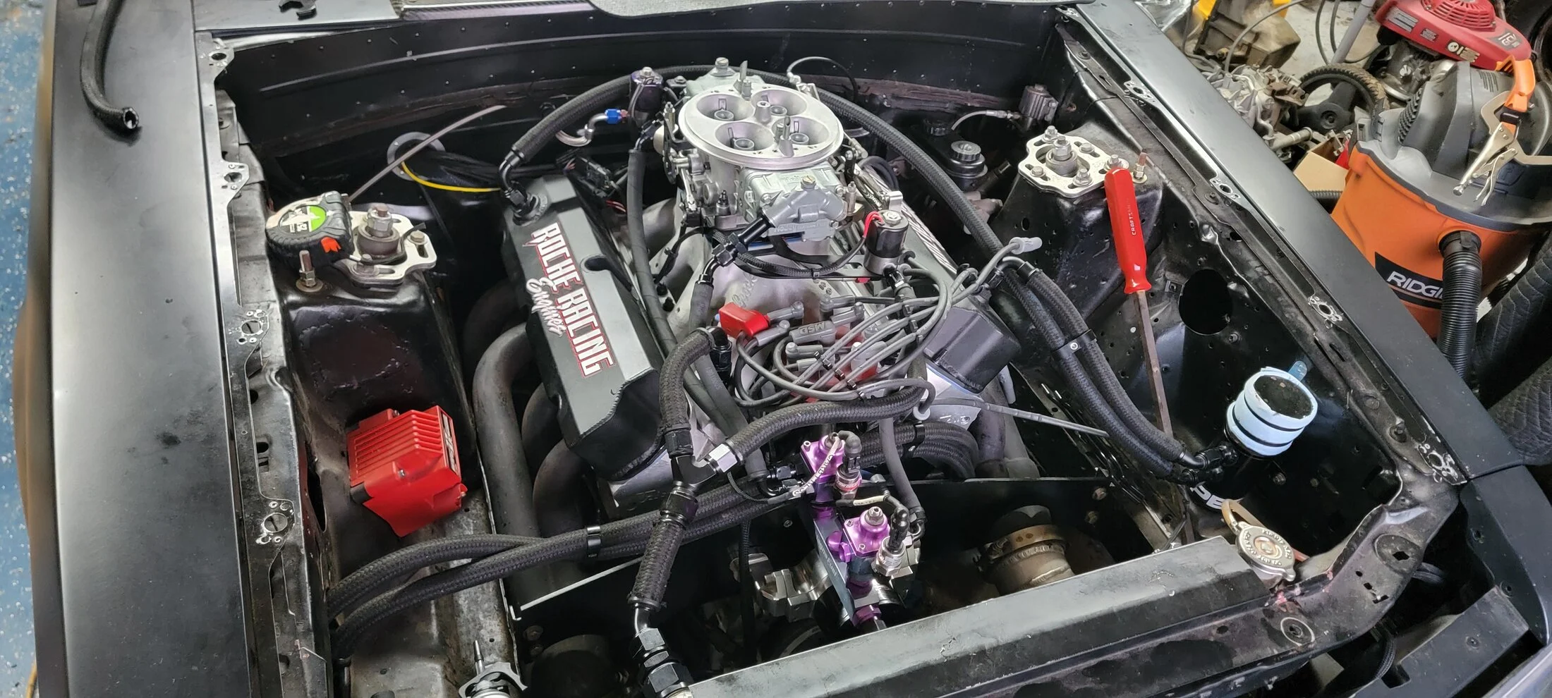

Got the car running... had a bit of a fire. Melted a lot of :poo:
Figured out the carb issue that caused the fire. Got it all fixed and running.

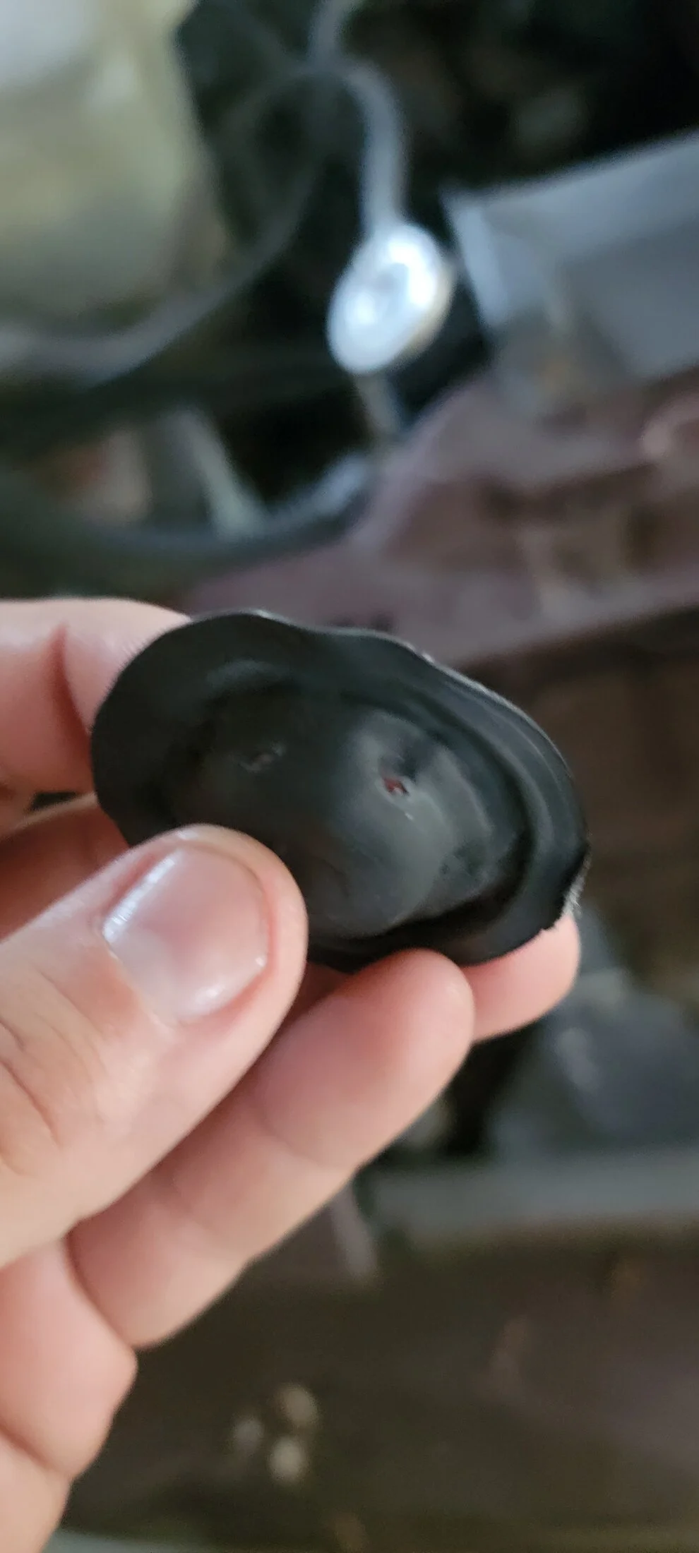

Nah just a bunch of wires mainly and my throttle cable... Q16 dried out the o rings on the needle and seat and no matter how low i set the fuel pressure it would flood the carb out. Is mainly been a struggle cleaning everything.
Going to start picking up everything to go fuel injection and boosted. Need to talk to Roche about the motor and how much compression we can knock out of the motor with a head gasket change. We have also talked about doing a built coyote... whatever we do this will probably be last year on nitrous with a carb.
