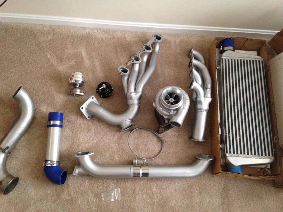

Here you go @TOOLOW91
Master power t70 with a .70 compressor ar and a .96 turbine ar
Tial wastegate and blow off valve
Thinking about swapping out the headers for a set of pony down headers instead I'll fit these up to see how I like them before I pull the trigger.
I'll take a closer pic the driver side had what looks like an AN fitting welded to it then they decided to fill it in? I'm not sure lol but I'm really excited roster this but idk if I wanna do this right away or wait til the winter
Mmmmmm.... shiney. :drool:
I probably couldn't tell you one turbo from another. Hopefully that one is sized to spool quickly (particularly since you're already 400 n/a). The torque boost should be very nice. :)
