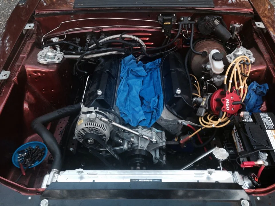

Well this sucks. Took apart my upper and lower manifolds to find a pretty big leak area in my upper intake manifold gasket. Had a new set of lower manifold gaskets so now I'm in the midst of replacing all of these here gaskets. Yay me!!:mad::confused:

I'll check what mine is after I do all this I know the vacuum was so low that my brake booster wouldn't work the way it was supposed to
