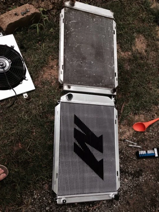

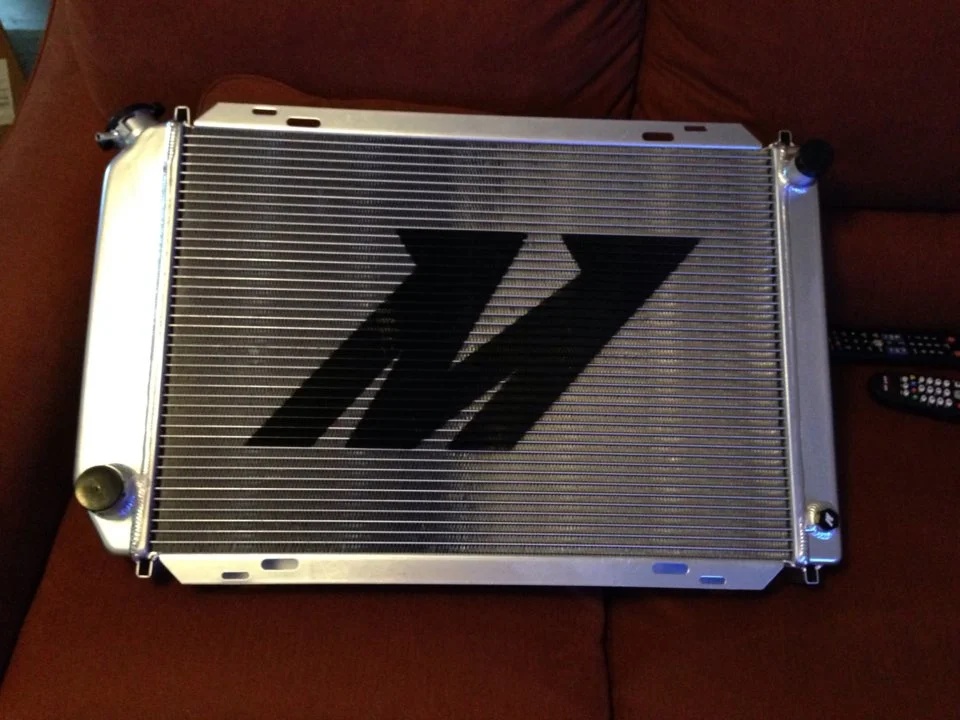

So friends I had another issue with the car apparently my radiator sprung a leak while I was driving and lost a bit of coolant, long story short my car temp reached 260 degrees at least that's where my gauge stops. Cars was popping and banging something fierce. So I put a new mishimoto 2 row in
Out with the old and in with the new
So I started her back up and she doesn't pop anymore, my concern now as I was slightly revving it nothing about 2500 Rpms just to get the temps up so I can fill with fluid and burp the system. As I would let off the throttle completely it would die every now and again the Rpms would get real low and other times it would just shut completely off. Did I mess something up? Bent push rod? I'm gonna pull the plugs tomorrow to check them out. Anyone wanna help me? @84Ttop @srtthis @madmike1157 @madspeed @TOOLOW91

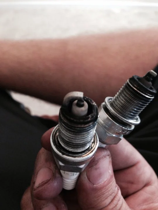

So I changed out my plugs for a set of densos I had in my box they are from last year still good hardly any miles but my question is why do my ngks that I pulled out look like this? I'm searching up spark plug reading and its pointing to the fact that the car overheated but I'm not sure here's a pic for you more experienced fellas
TOOLOW91
20+ Year Stangneter
8,500
8,753
S.I.NY
Aug 12, 2015
#730
  • Aug 12, 2015
  • #730
Hmmmm so many variables here . Glad to see you are playing again . Ect sensor will cause all types of issues
