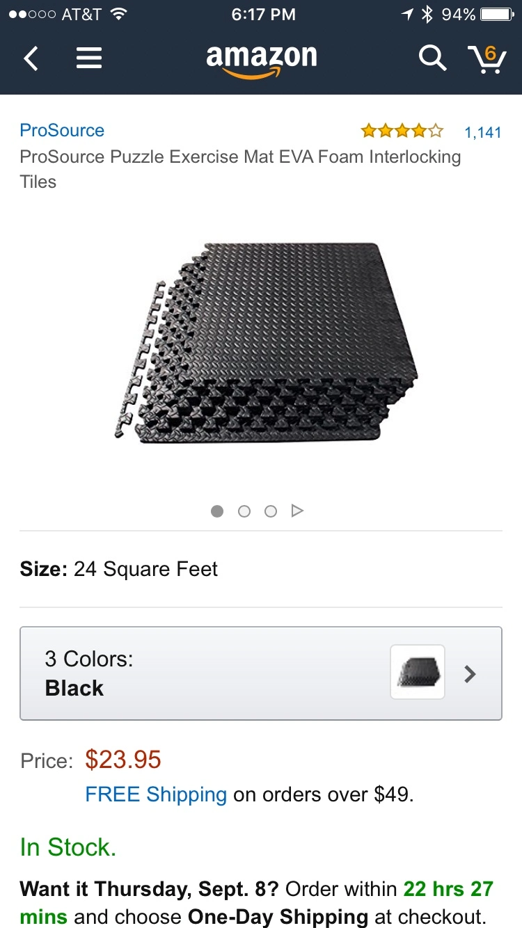

Ouch. Buy some of those workout mats from Amazon. Pretty cheap, and feels better. I have a 6x4 section I use when I lay on the ground

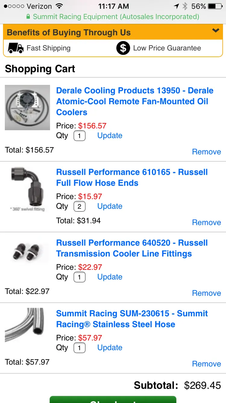

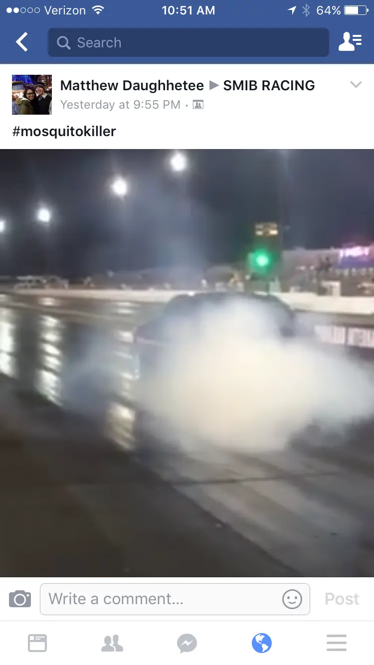

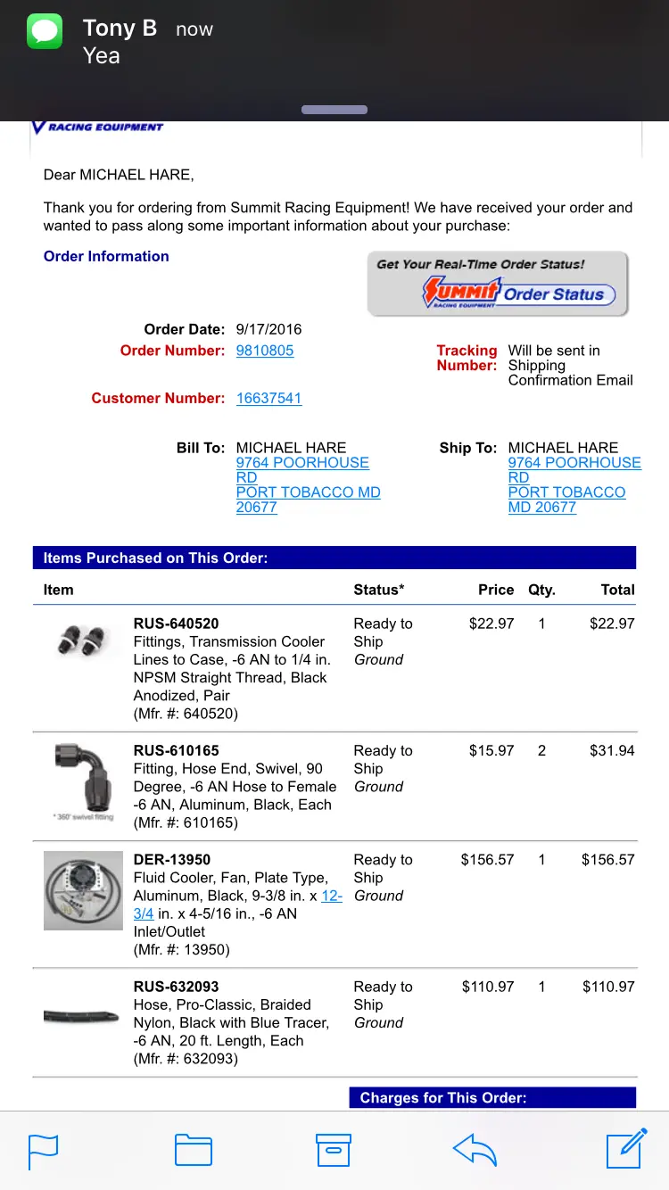

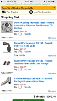

Jeff yeah I ran it Friday and made a huge embarrassment of myself and spilled fluid down the track .... Split one of the trans cooler lines. I have a remote cooler and some AN lines coming in now. Received a new name for the car .. Mosquito killer. :eek:
