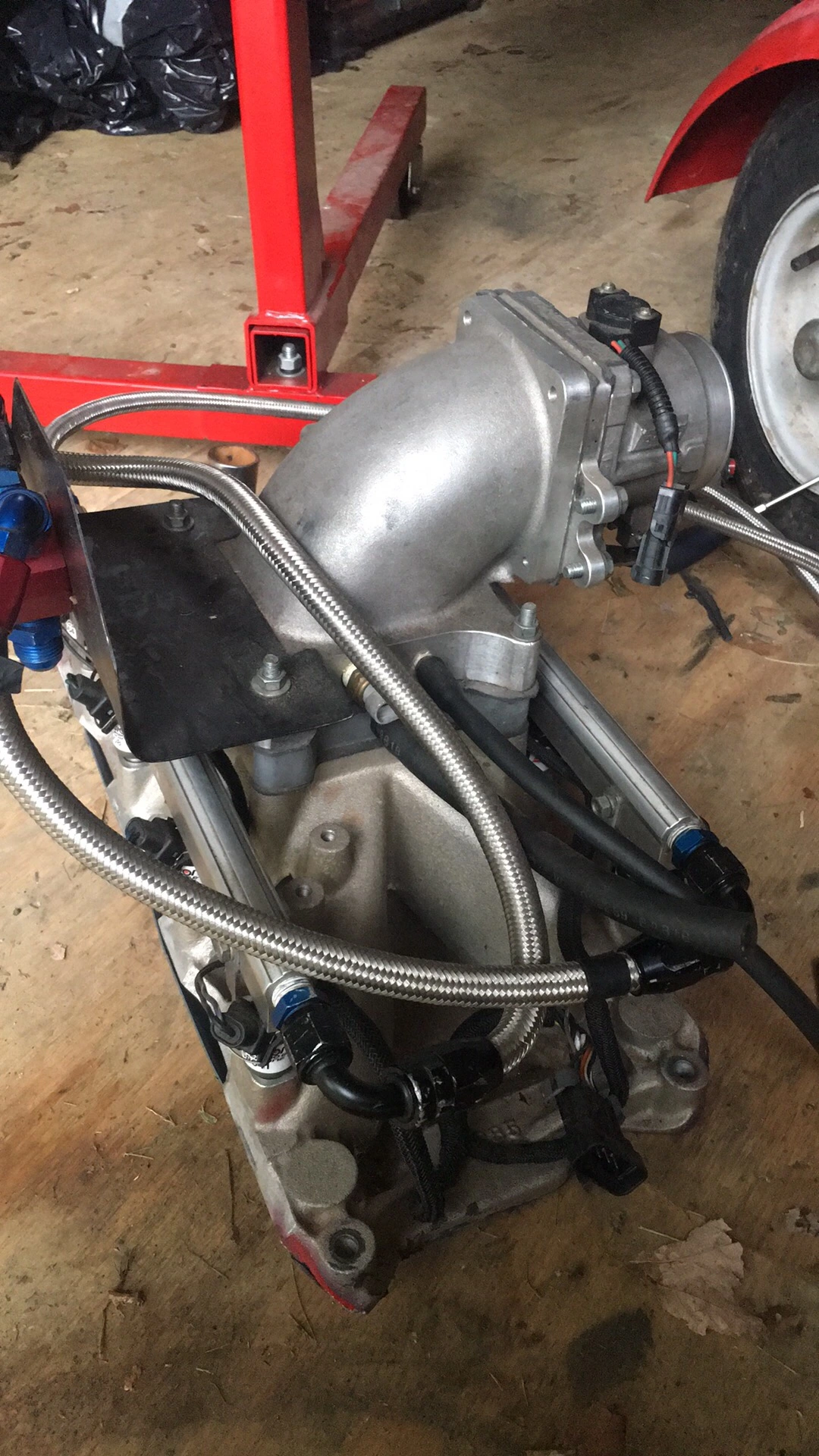

So I got the intake off of the new motor, lol and behold I have found a few more things I want to swap over to my motor. Link bar style lifters, crane cam rockers, rocker girdle, csr water pump. Anyways here's the intake I'm gonna swap over to the car.

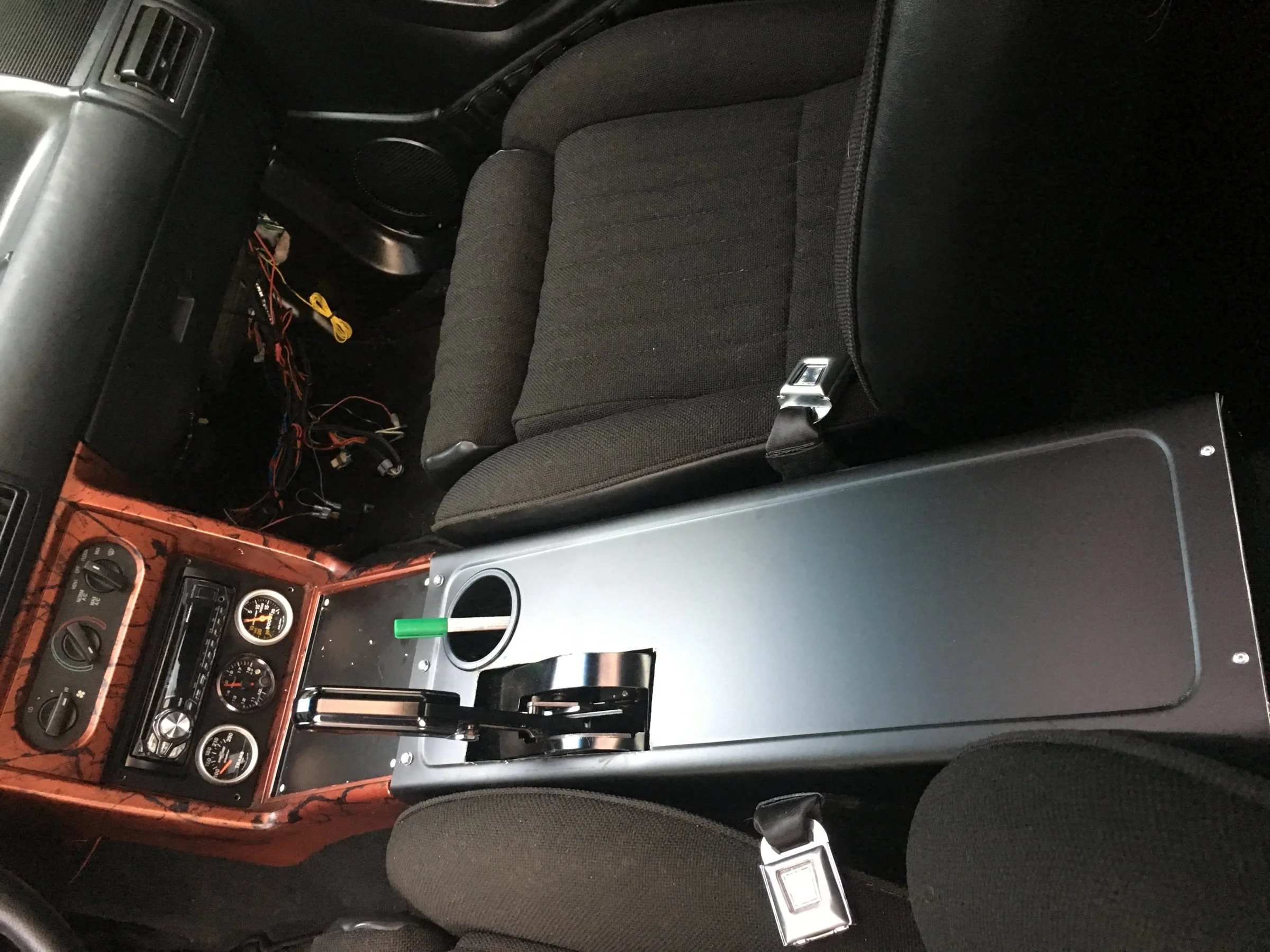

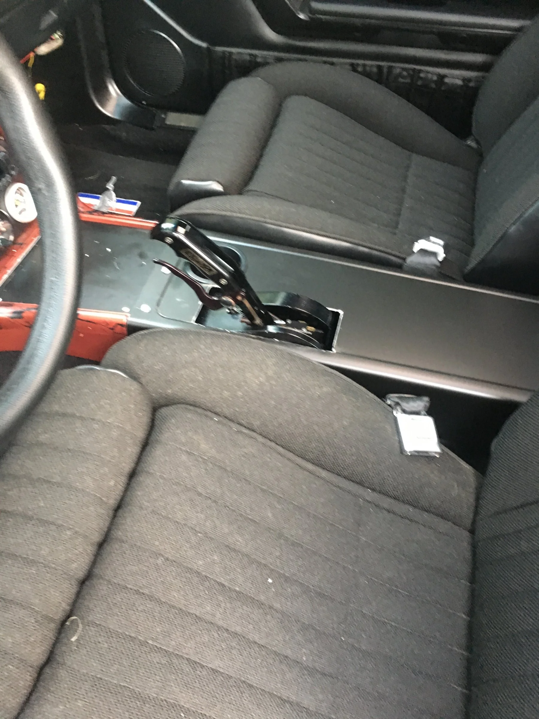

If anyone is thinking of installing a Scott rod fab center console this is what it will look like hah. I had to order two of them because the first one the cup holder was in the center and my shifter would not fit beside it. Called him up and he sent out another one with the cup holder pushed as far over as possible. I used self tapping screws for ease of removal. Although he does send rivets with it. What do you guys think? I know it's not anything fast I'm still waiting to pull the intake and swap them out still.

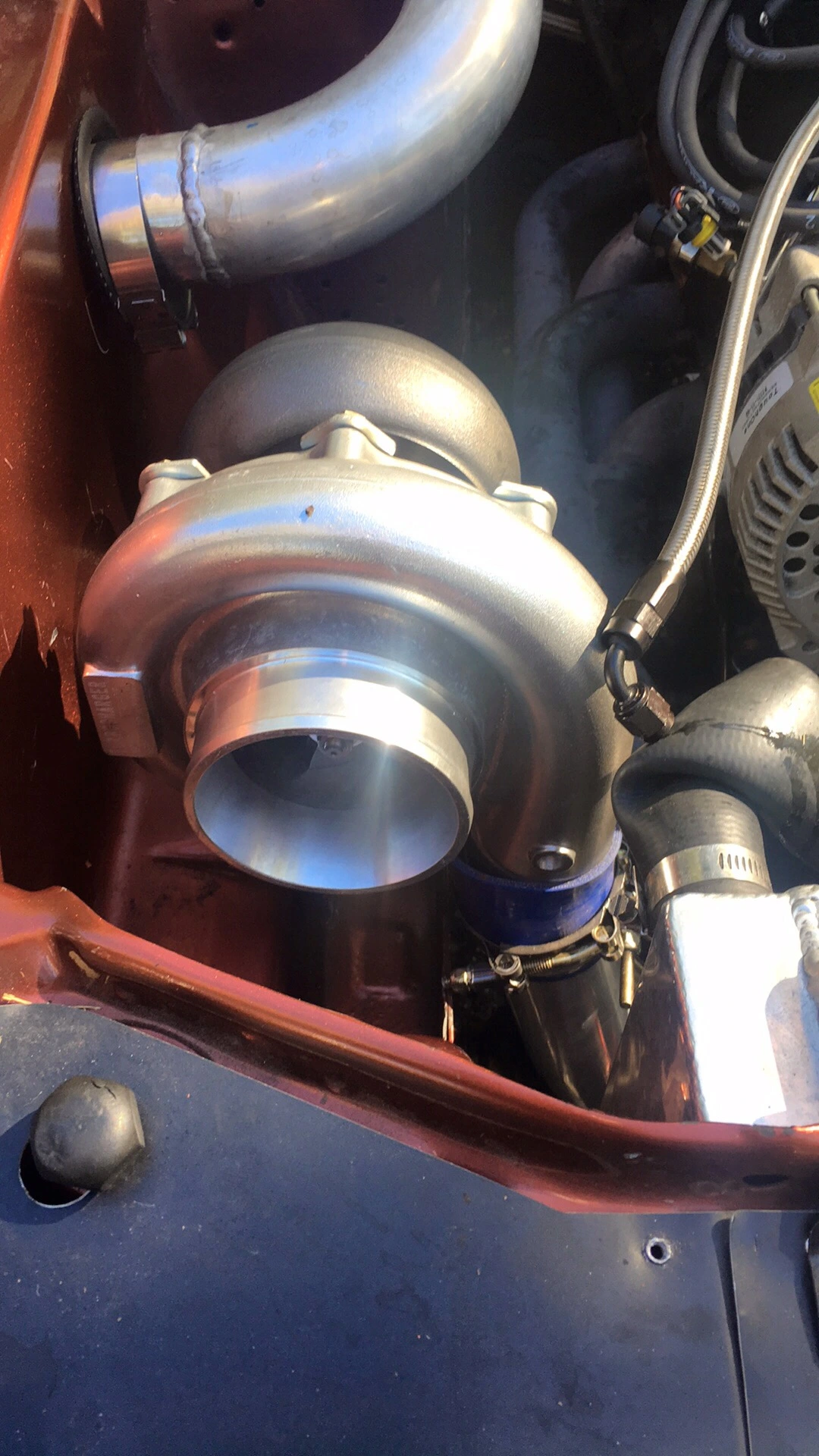

So I took the car to the track last night and installed a remote mount trans cooler. Track temps were cold and I couldn't get the power to the ground. Today I took it off the trailer and fixed an exhaust leak I had and also threw a larger turbo on it went from a 70mm to a 78mm. Let's see how this turns out

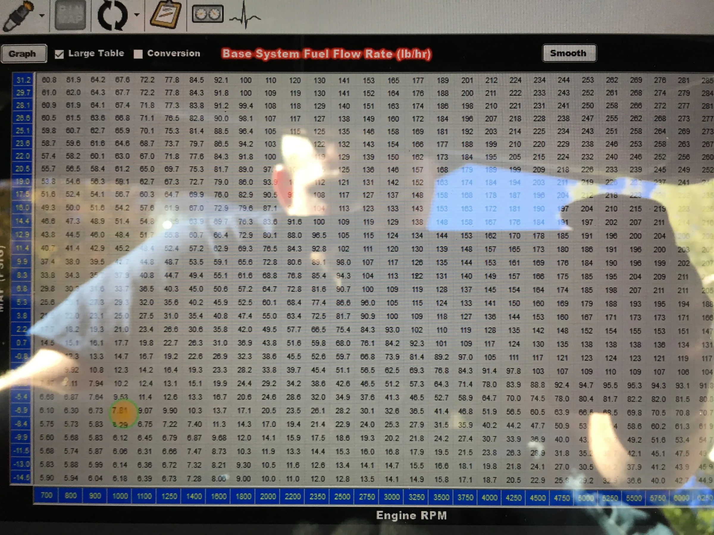

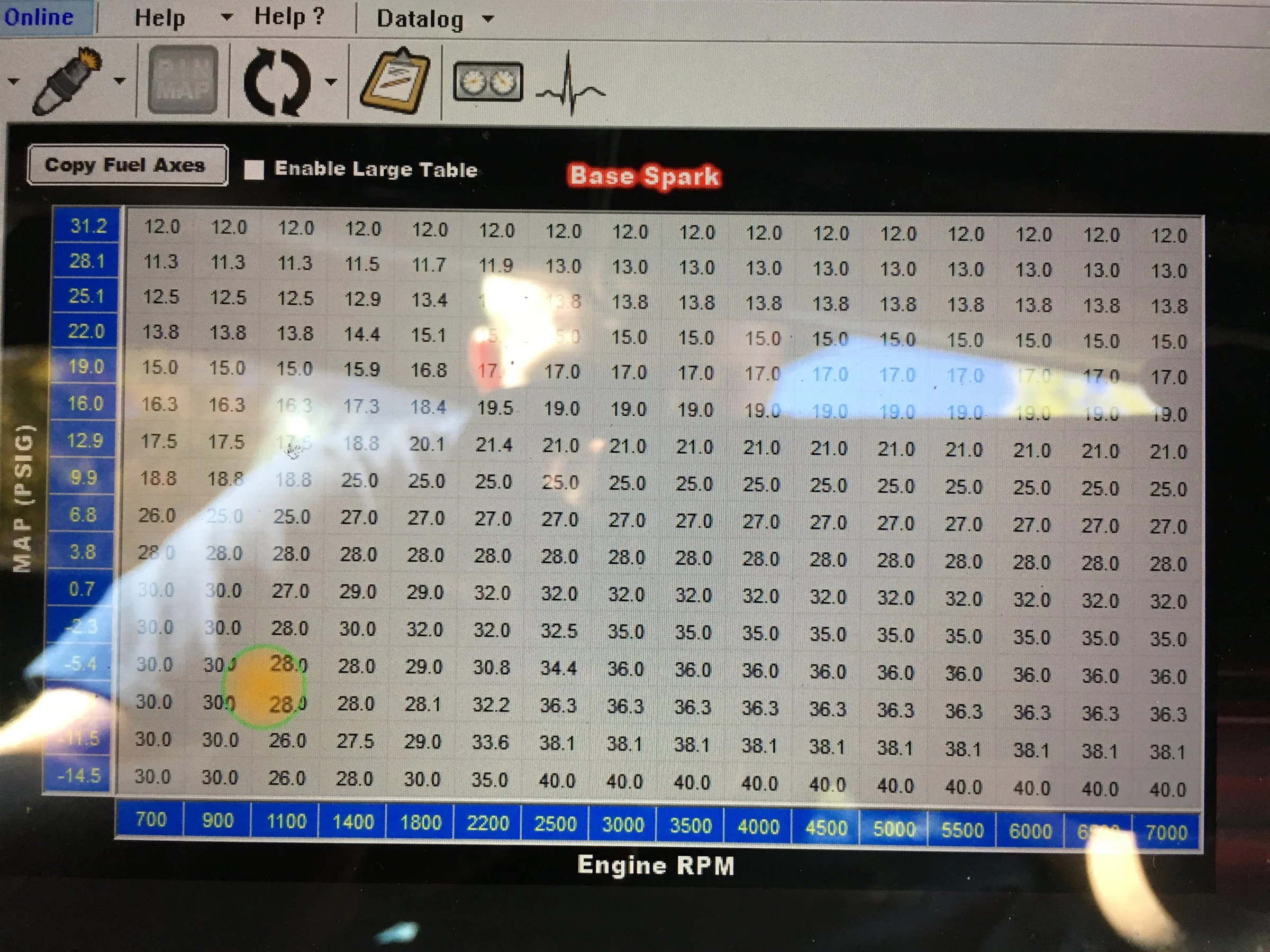

I know I told Kris everything was good but it still doesn't seem right I changed a few things around on the 2-step and no matter what I do I can't get it to level out at all.
Here's a few pics of my settings
That's deff weird . Sure it isn't a holley issue ? It does seem better then it originally was . Sounds just more like a low rev limiter then a actual two step
Sent from my iPhone using Tapatalk
@TOOLOW91 talked to a guy on turbo bullet and he said that I need to set it to spark high only at 4000 or something above where I want it set at and tune the fuel table to 13.0 where it is revving at in the table he said from the video that it sounds like too much fuel
Yeah I was kind of silently lurking on your post . Just seems so complicated where as it could be so simple in my opinion . Holley should just have a " 2 step option" instead of having to trigger a extra rev limiter and go crazy with settings to make it do what it should .
If you think about it with a simple msd 2 step when you trigger it , it doesn't do anything to your fuel it just takes care of spark and seems to work flawless everytime .

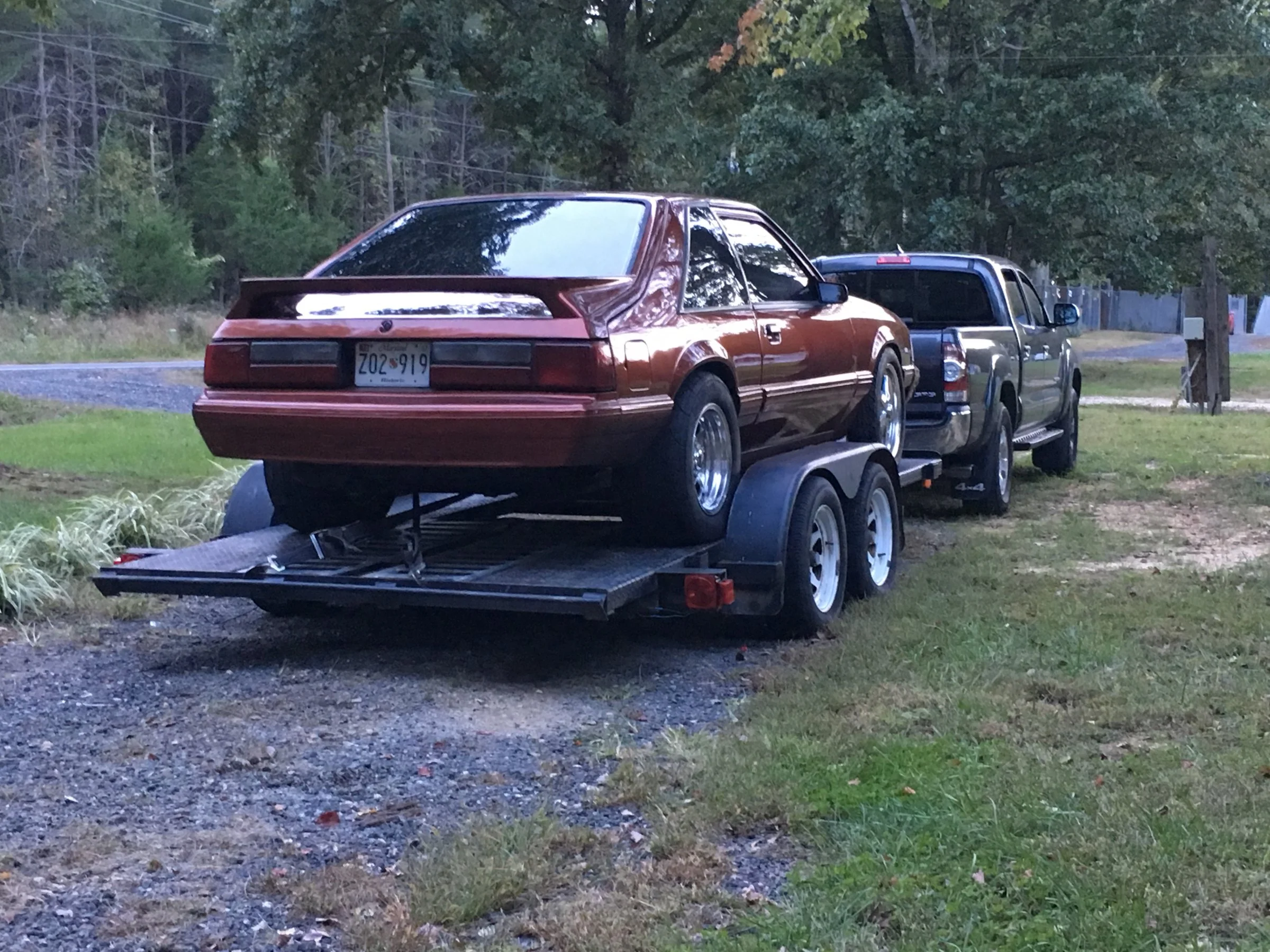

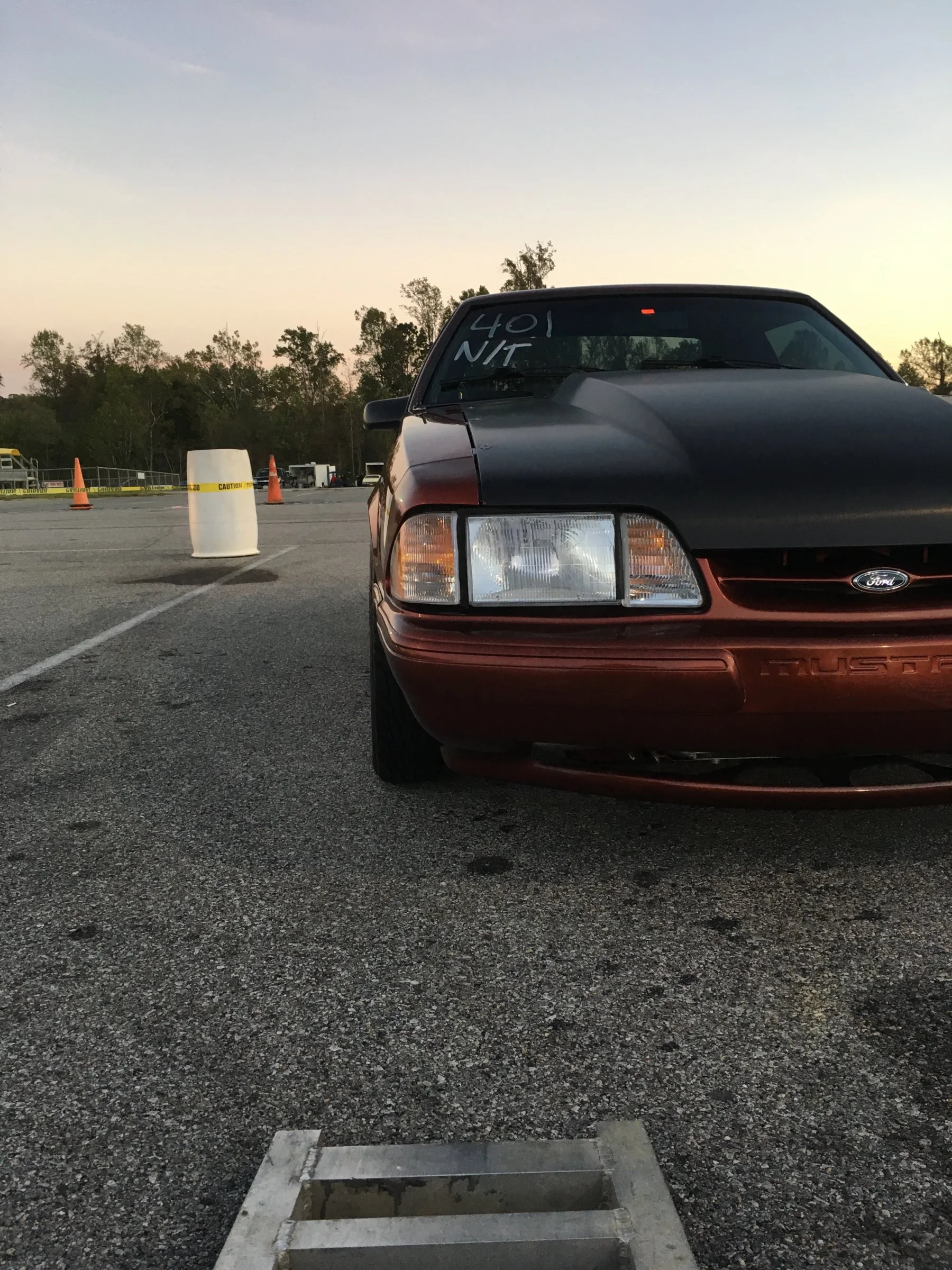

Well with the temps getting colder it's getting more like boost weather and so I loaded the car up yesterday evening to head to MIR. There was a grand total of about 35 cars there and 15 of them were part of the mopar event for today. Drug the car off the trailer started it up everything was good and kosher.
Went out for my first run and completely blew the tires off. Went a 11.63 but at 125 mph lol. Had a buddy help me the rest of the night and went and clicked off some of my fastest passes. Ran a total of 6 times last night. So happy with this car it just keeps surprising me time and time again.
