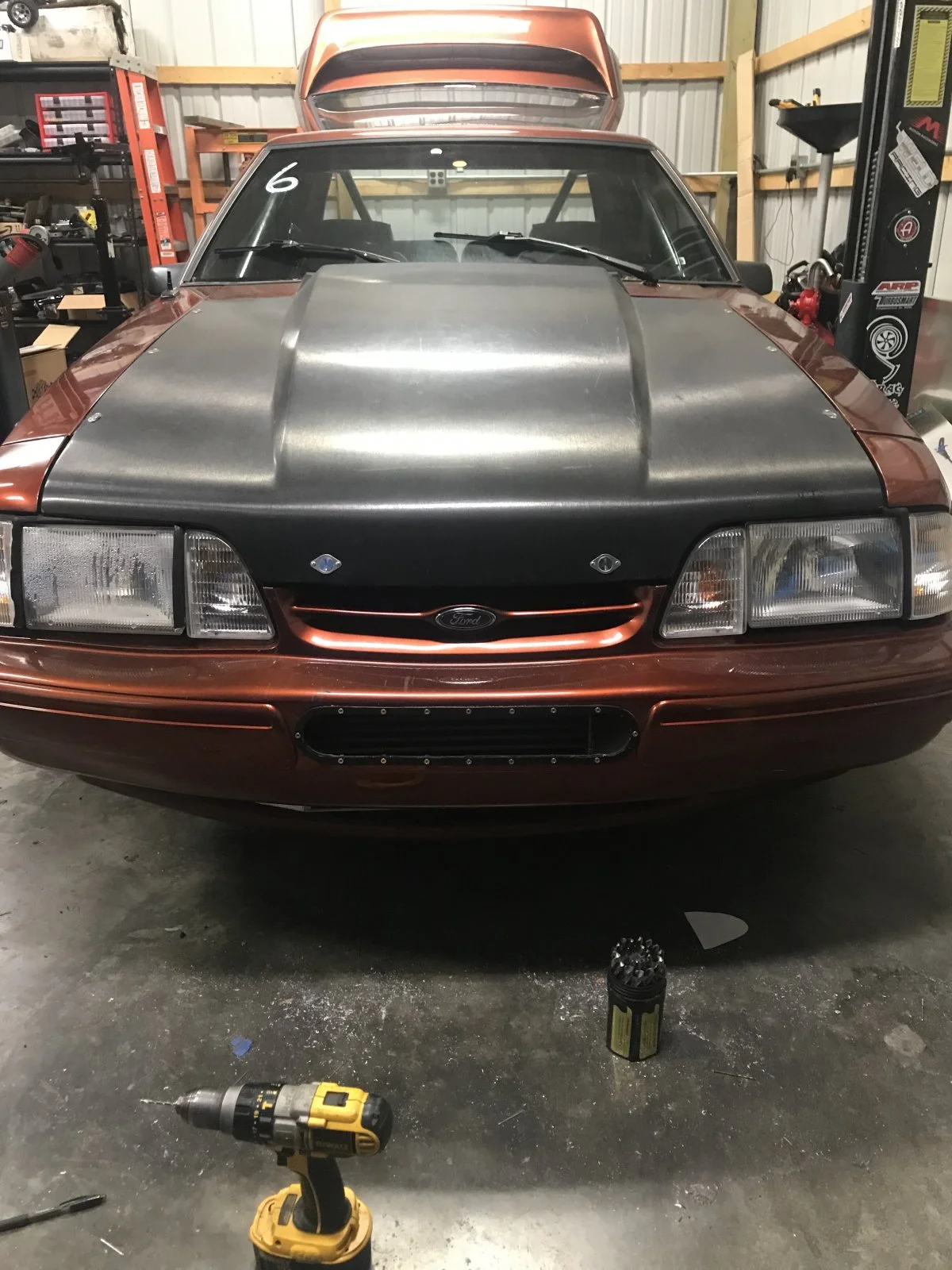

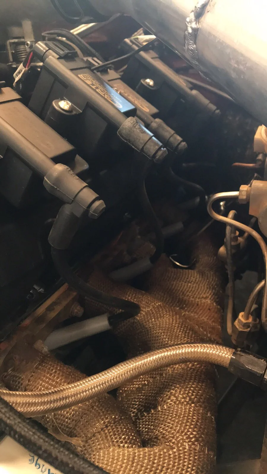

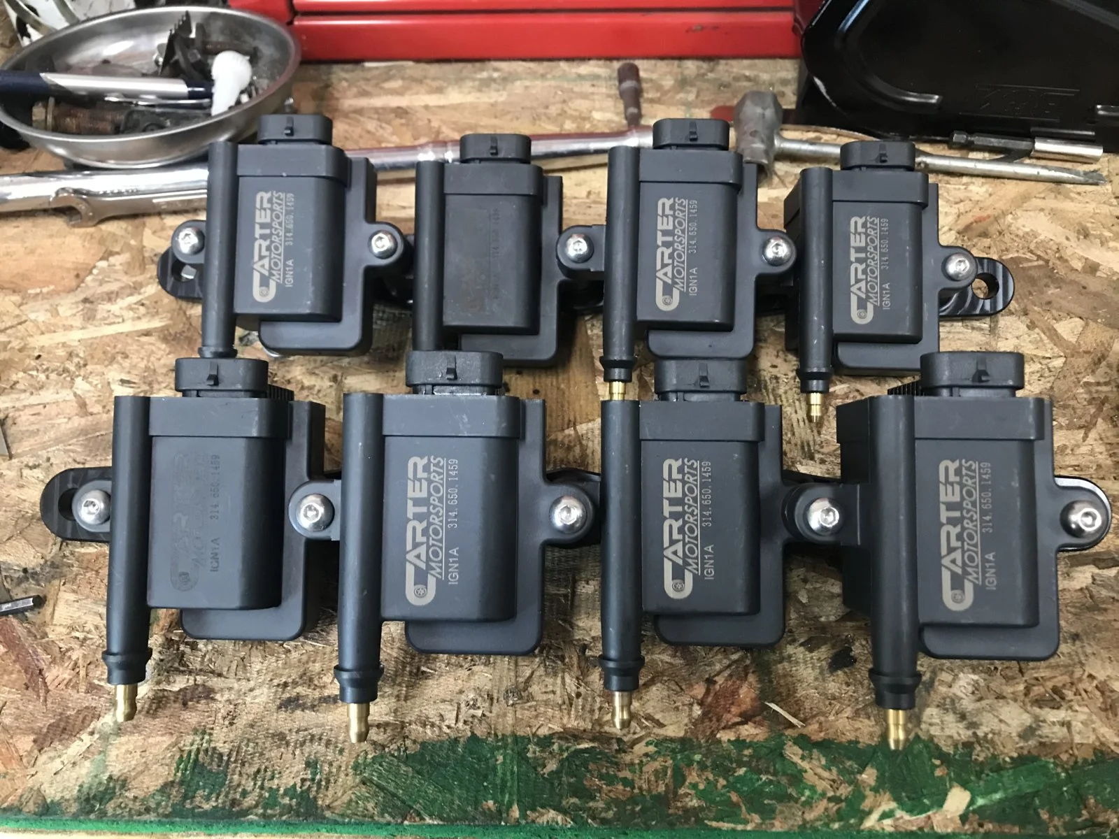

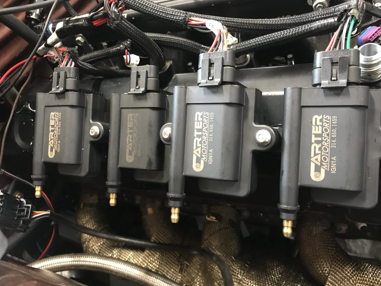

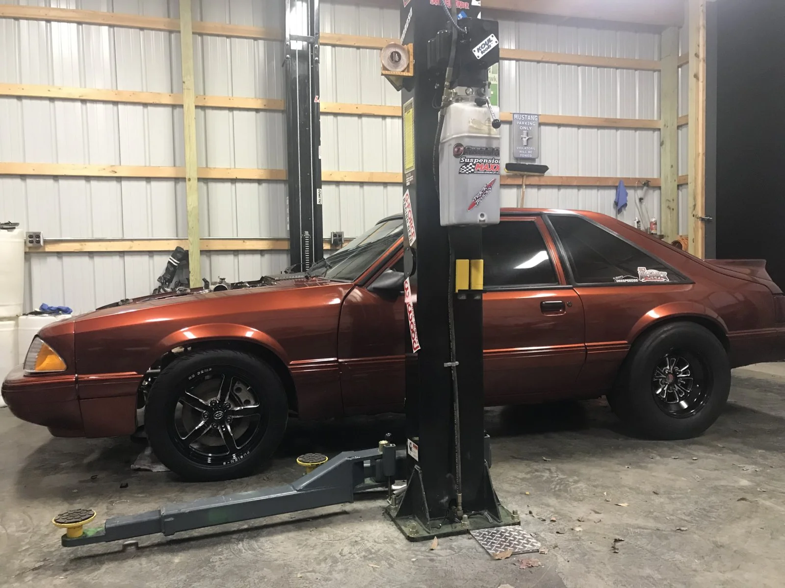

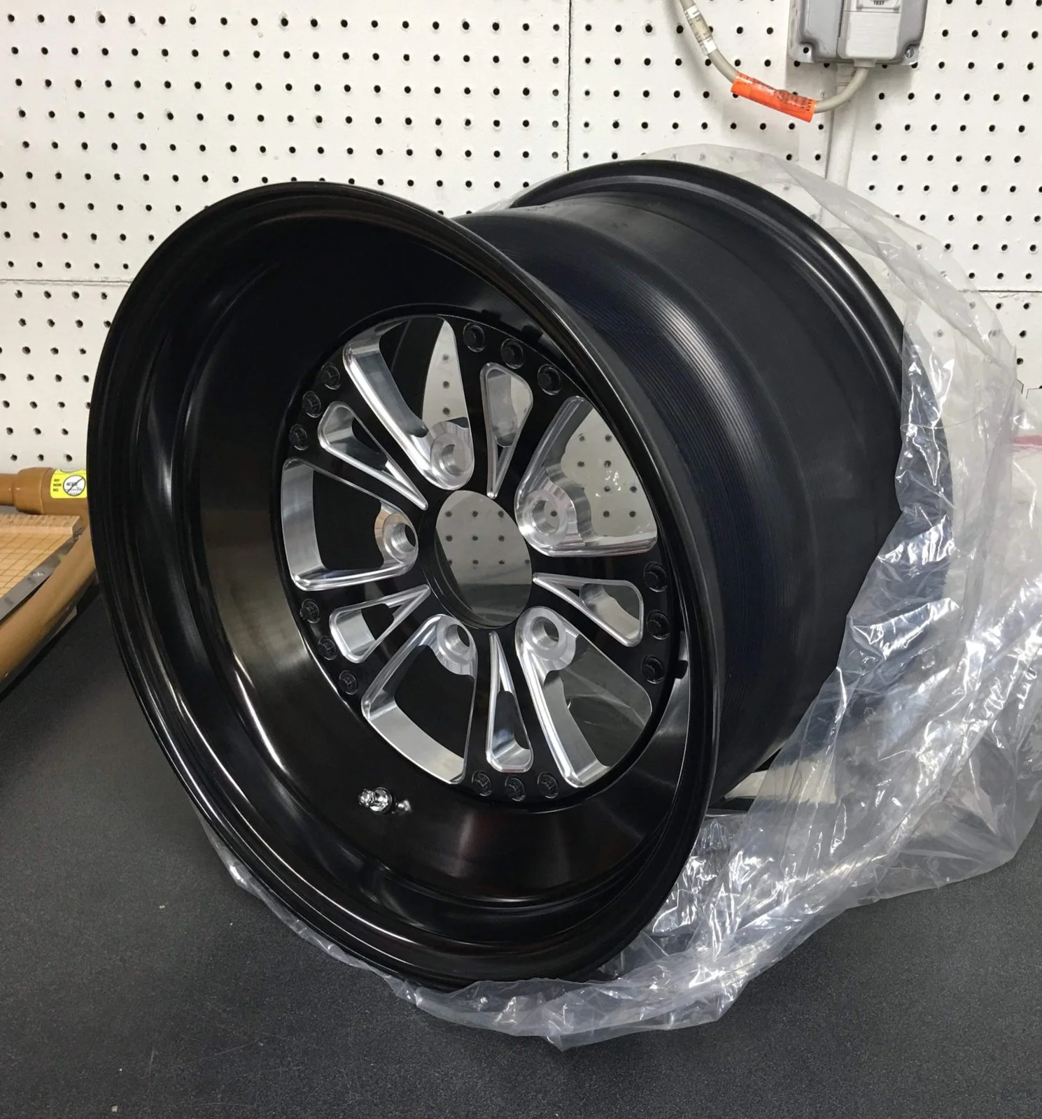

Very cool mike. Someday in the far off future I’ll want a version of that too.Finally able to get the wheels and tires mounted up to the car. Damn I can’t wait to finish this thing again before the seasons out. Also added my new ign1a coils to the motion raceworks coil bracket and set them onto the valve covers.

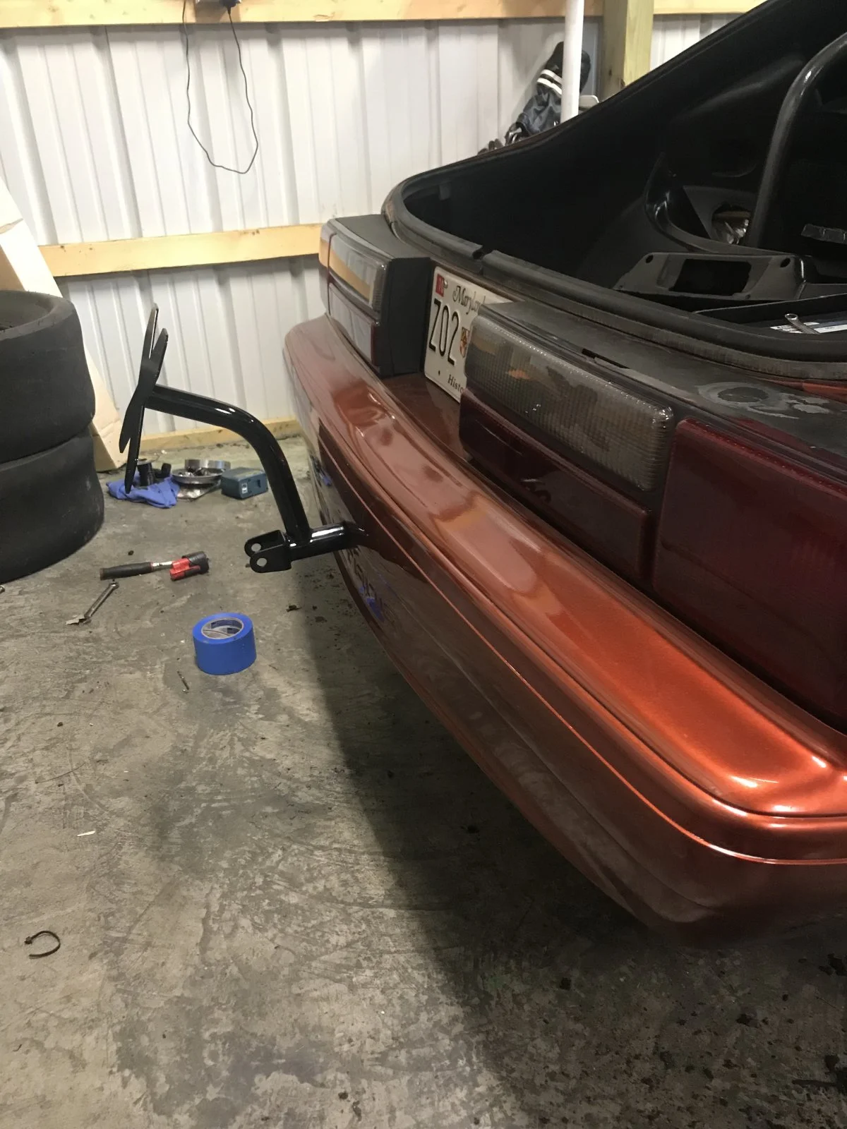

I pulled the chute Friday, still haven’t repacked itRace kor

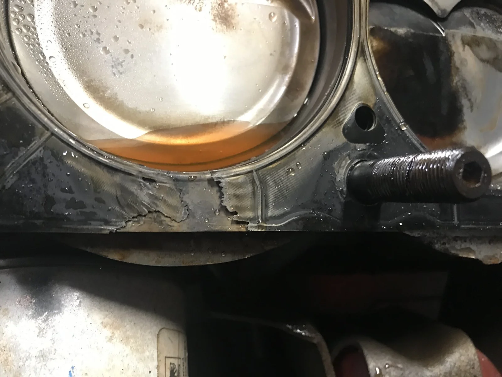

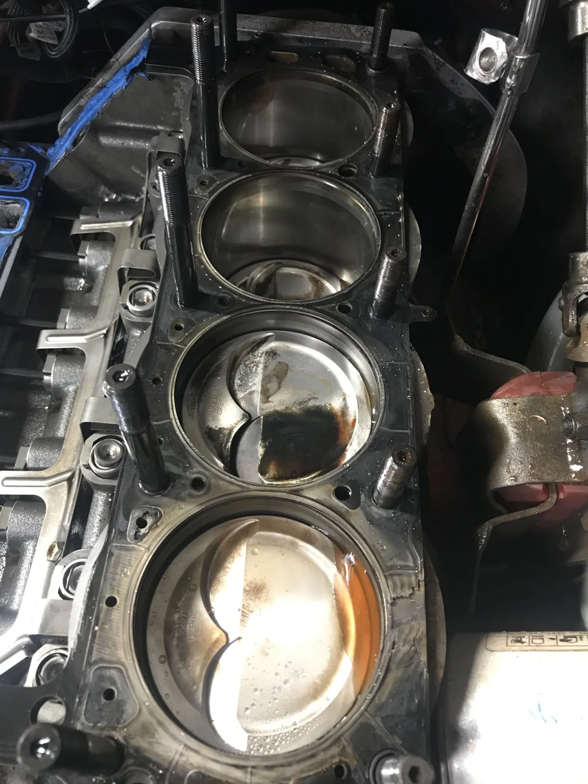

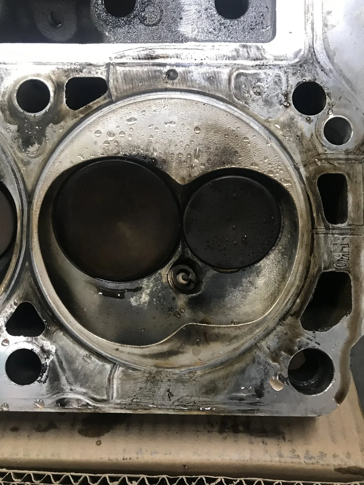

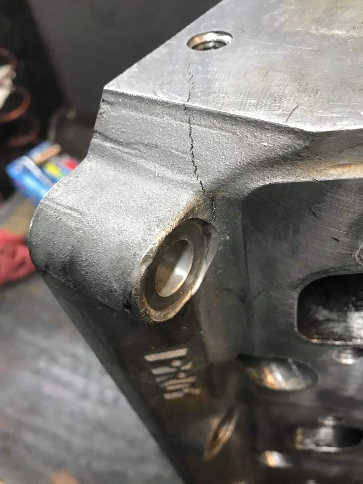

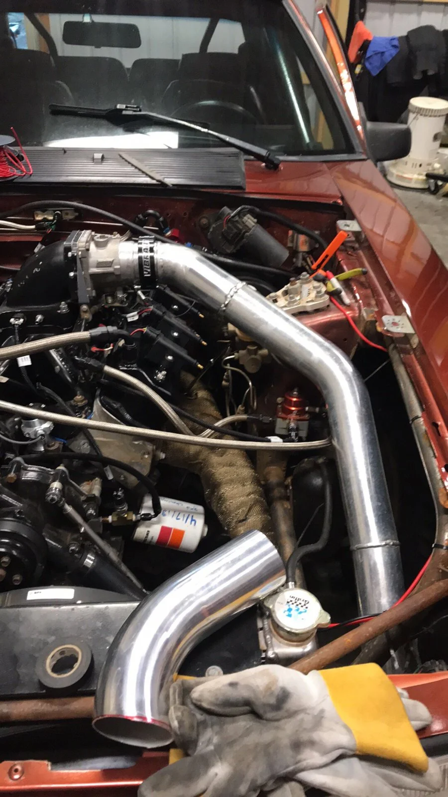

My theory of what happened is that it lost a head gasket at top end of the track, when I let off of it coolant got sucked into the cylinder and the head was the weak link compared to the forged rod and piston. Other then that I have no clue how it happenedStreet cars don’t do that Mike.......just sayin’
