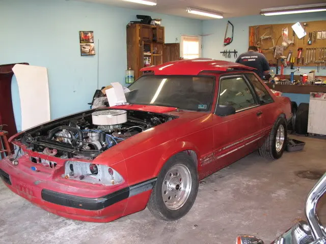

hey guys im new to the forum , i have been a member of other ones but like how it goes here so i figured i would post up my project i have been build ing for the last 4-5 months i have the car almost a year but didnt do much much at first because my daughter was born 7 months ago keep in mind this a budget car

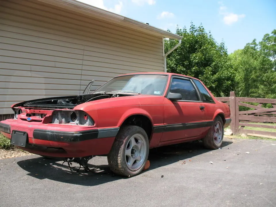

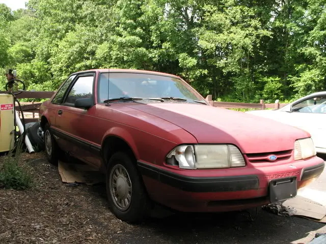

the day i brought it home 4cyl automatic

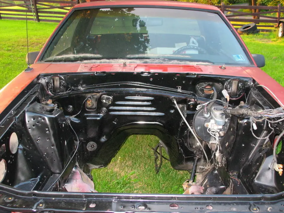

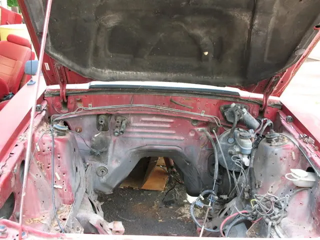

4cyl and auto gone

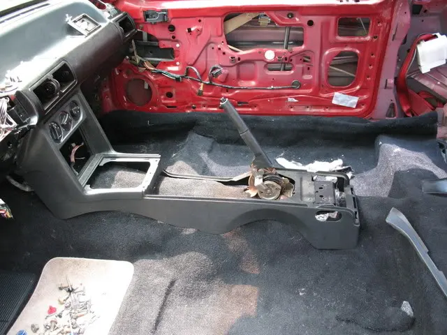

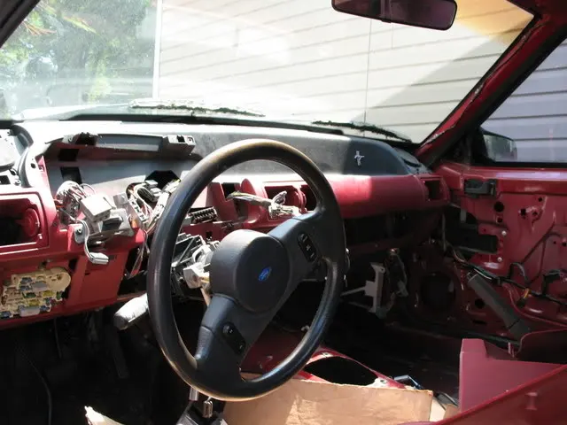

death to the porno red and 5 speed swap

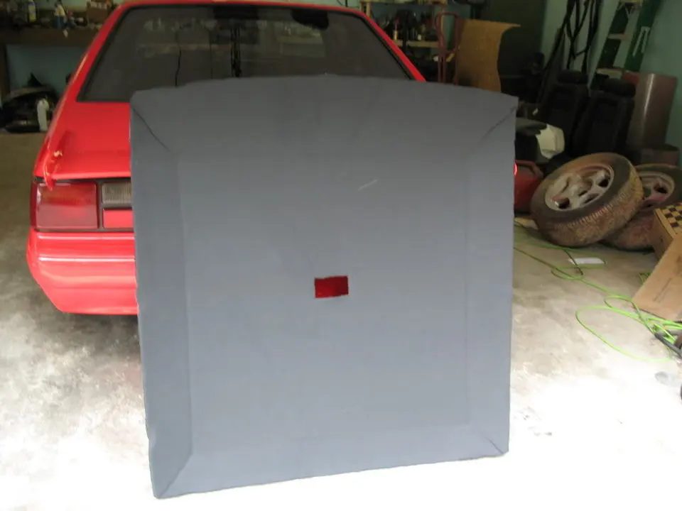

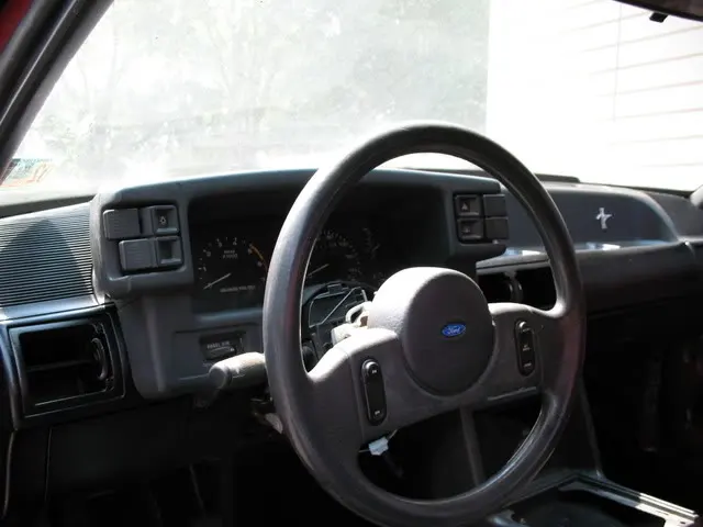

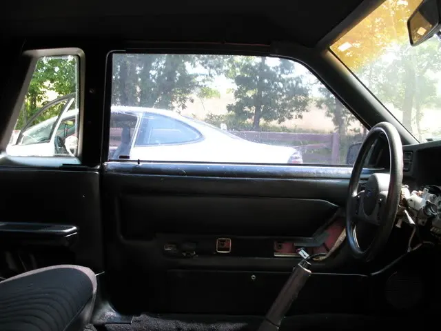

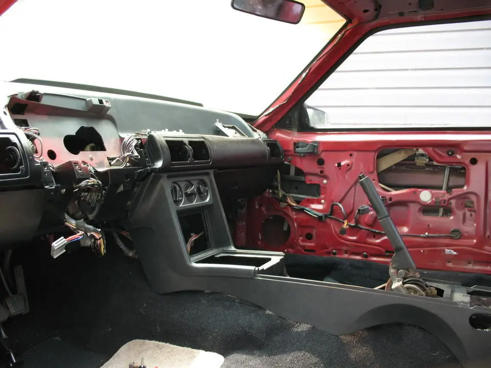

headliner redone in black
new carpet in and dash and all going back in

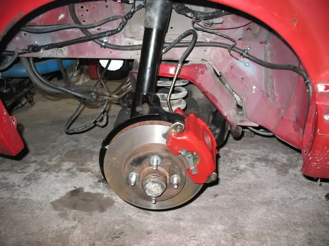

car rollin again with 8.8 in gt rear springs , 410s, lakewood 50/50s, southside lca, dble adj upper

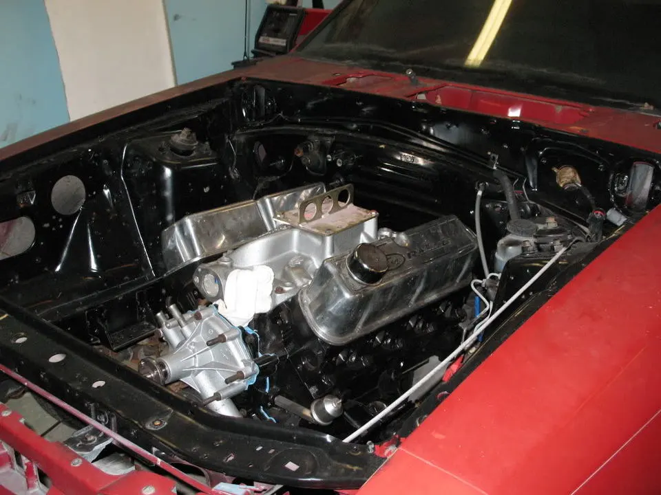

engine bay cleaned up and quick coat of paint till i paint the car over the winter it will all be filled in

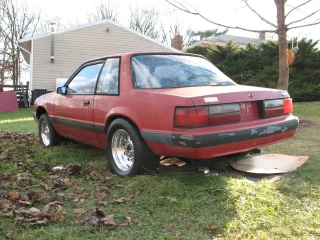

put the wheels on and tried the hood on

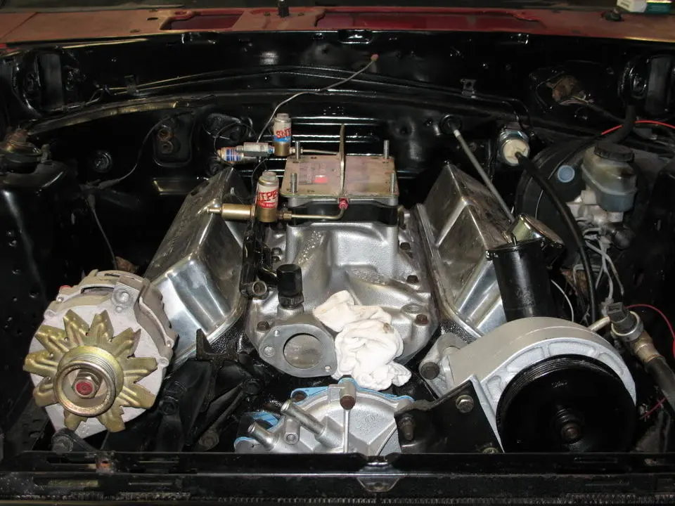

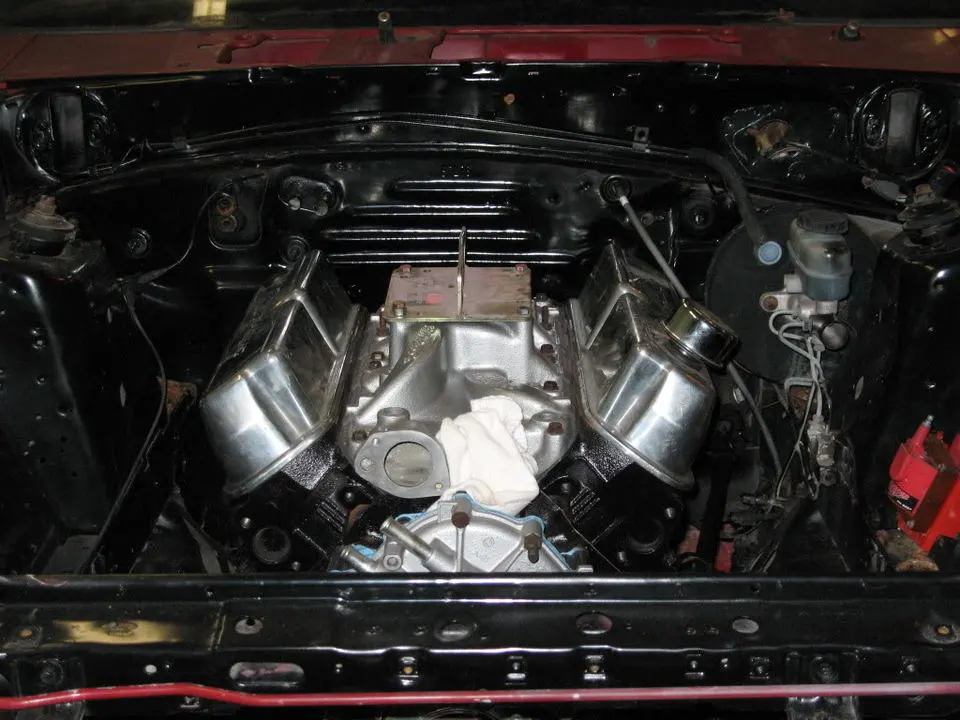

finally got the car out of the cold and dropped in the motor and tranny

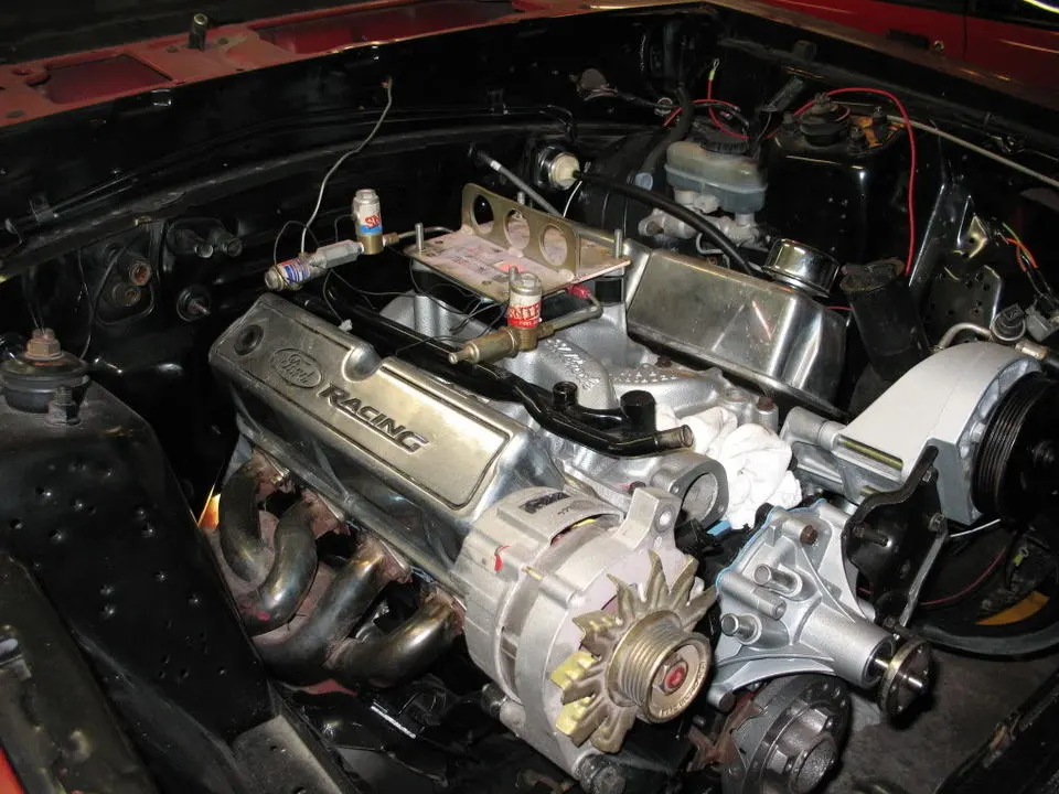

90 stock bottem end re ringed and bearings
e 303 cam
gt 40 irons froma 95 cobra home ported
eddy performer rpm intake
700 holley dp
clip of it idling
pic of the old 4cyl junk
89 gt spindles , new rack and tie rods, stange 10 way struts, all new rubber hoses
car setting back down again 4cyl springs one coil cut

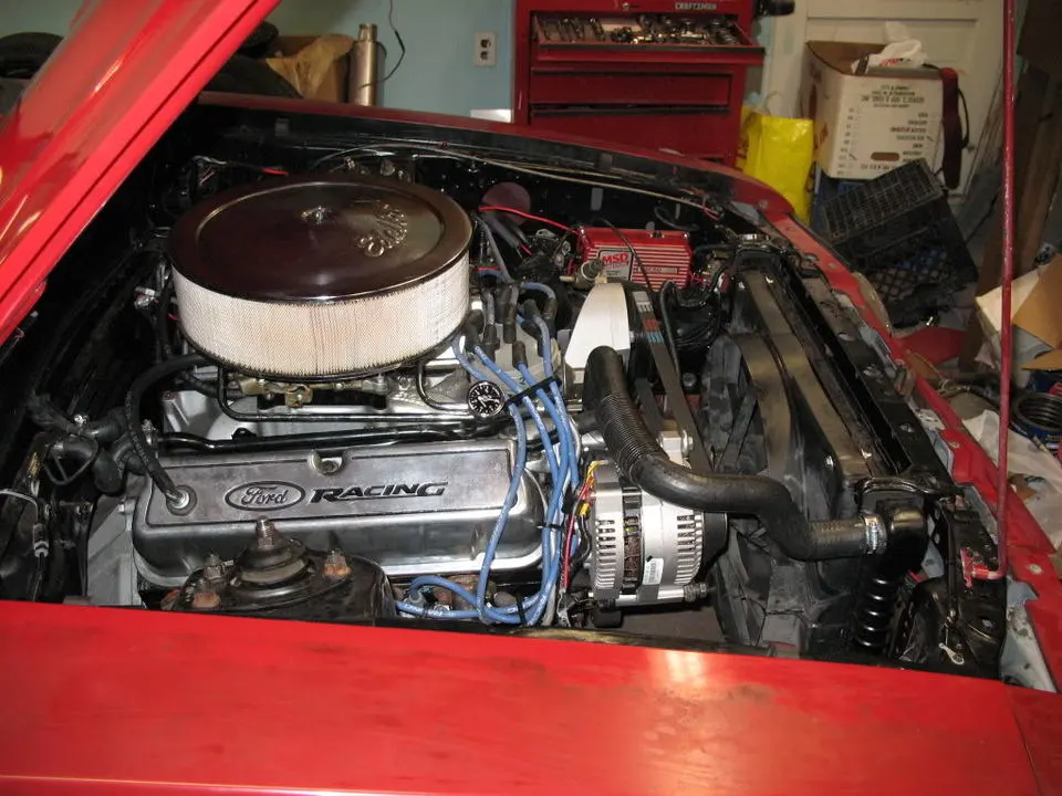

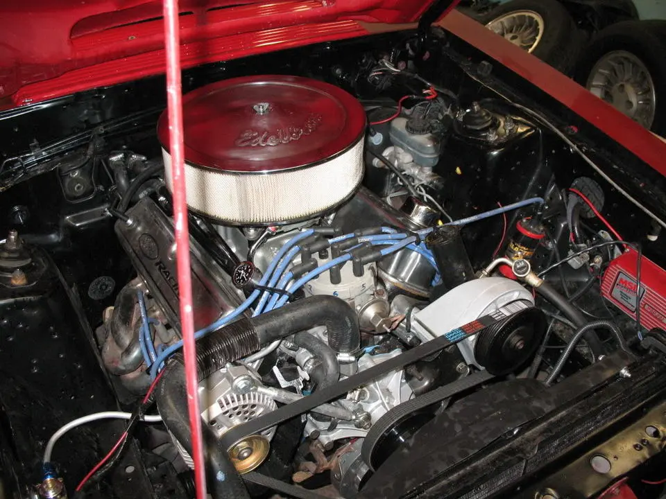

need to update some engine pics, went with 3g alternator and mark8 fan
took it out ont the road for the first time seems nice
i will update over the weekend thanks guys and like to hear your feedback
project notch rocket update

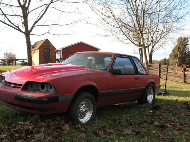

not a huge update finally got the drive the car. took it to have it ligned up and inspected. some motor shots it still needs cleaned up , put the hood on now ill start on the body and finish up the odd and interior stuff

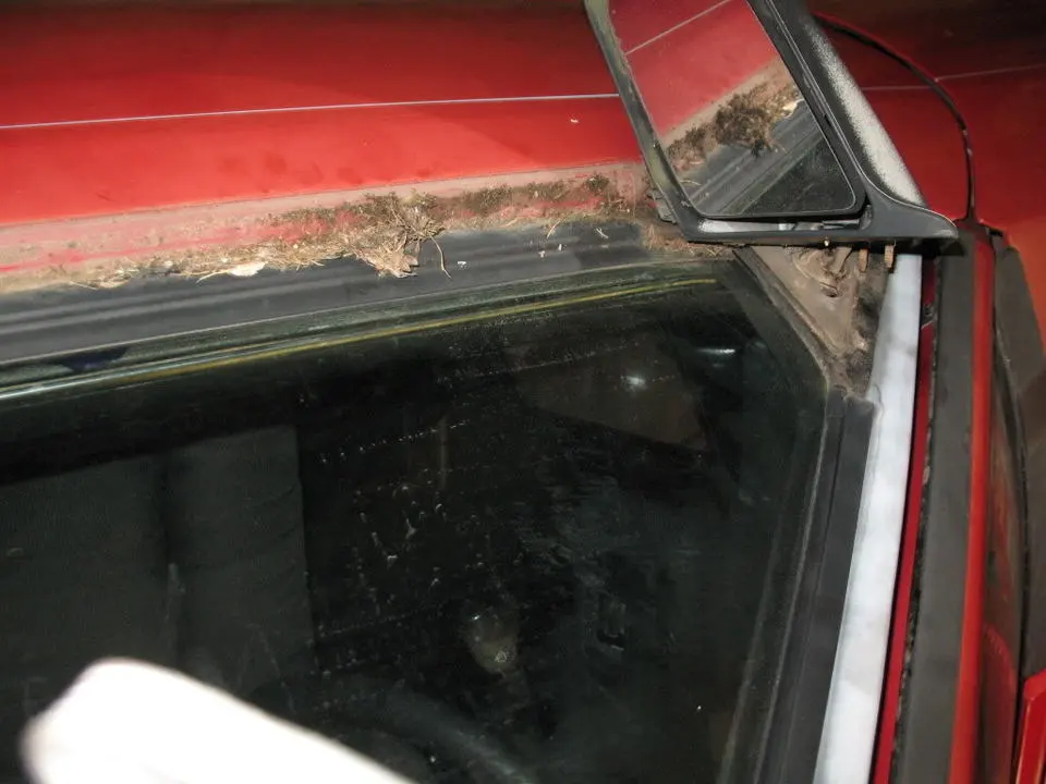

gonna put some new trim on and clean the mirrors what a mess i found behind them
ill keep u posted
Good thing you found that mess behine the moldings. Everytime you washed the car, that crap would come out and ruin your wash job. You should have seen the load of pine needles behind my car and under the hood.
sorry guys havent been on in a while, i broke my ankle during summer and didnt get much done on the car so now im back to working on it
the specs on the motor are:
90 stock bottem end new rings and bearings
95 cobra gt40 iron heads home ported
trick flow valve spring upgrade
e303 cam
holley 650 double pumper
i got to run it once last year at the track, no tune and on nitto drag radials
went 13.1 @107.5mph with a 1.99 60ft so theres alot left
im switching to longtubes and going to t5z trans and aluminum driveshaft
also installing sub frame connectors, reinforcing the torque boxes, and changing up the rear suspension . my goal is to run high 11s on the motor and it can be done
i will also be painting the car , over the winter so stay tuned guys
glad to be back
