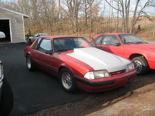

new update
well the trans is out and gone , also the shorty headers and h pipe little update
ran out of jack stands lol
my dads car were both missing trans
since i was on last time 4 months ago , is old the 15x8s and went to 15x10 with 6.5 backspace they tens but i keep them clean lol
headers gone
t5z just rebuilt with astro parts
lakewood blow proof bell and astro extended clutch fork
mac longtubes and h pipe and ford racing aluminum driveshaft
stay tuned its all goin in this week

ok finally the thread is not worthless lol heres some pic updates
quick fuel q 650 carb , its nice still getting use to tuning it
3inch cowl , i traded the cobra r for
summit sport seats , there pretty nice
that takes care of the winter stuff i did besides new plug wires
