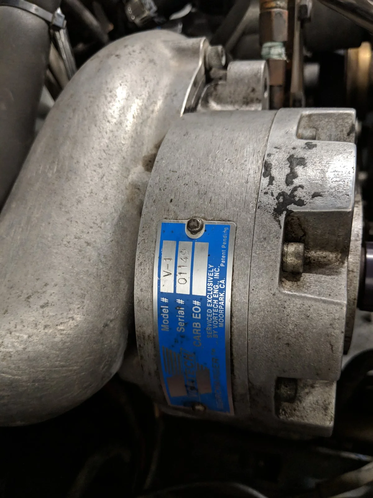

I am helping my father in law restore his 1992 LX. He is the original owner! And, it's only got about 21k miles. Unfortunately, it sat idle for about 10-15 years. It has a Vortech supercharger installed, and at the time that was done, a shop called Houston Turbo did all the work. Apparently it has over 400 hp to the rear wheels.

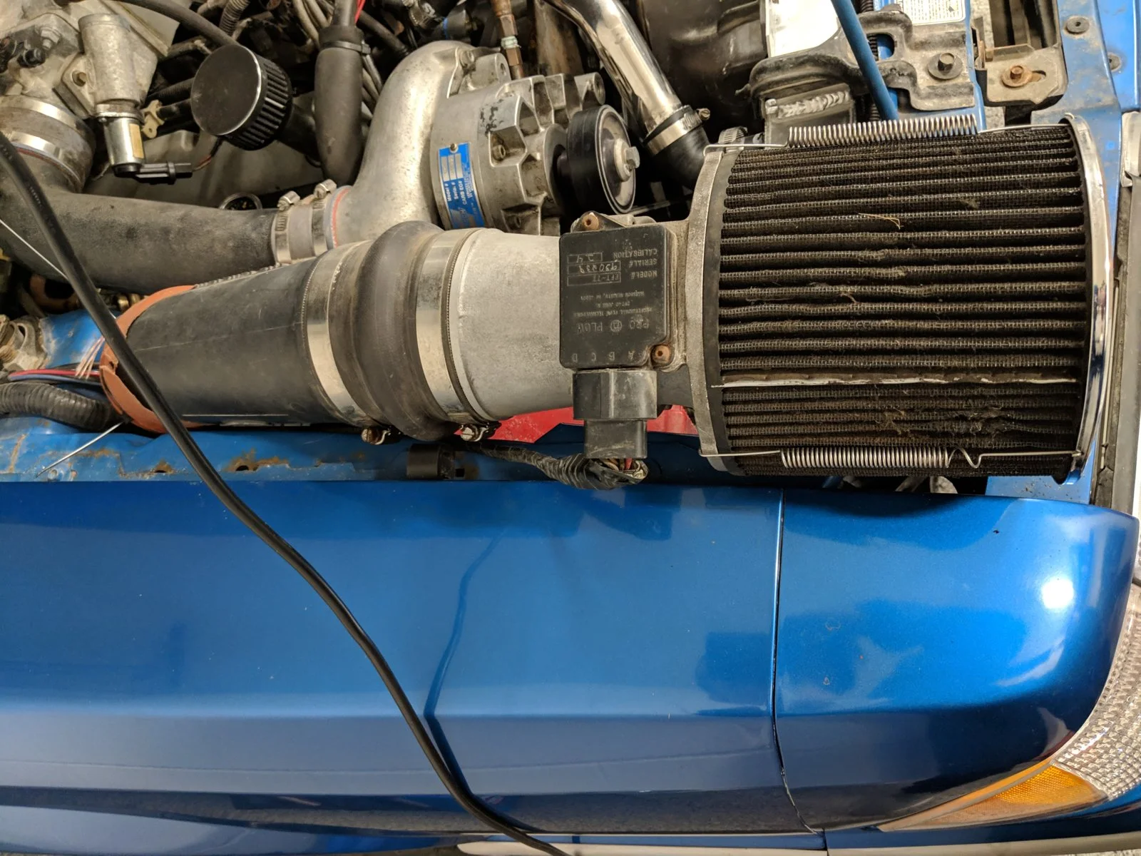

Got under the car to check out the air intake. This thing looked home brewed. We were look at this after I pulled the code 66. No signal from the MAF. Turns out, the MAF sensor was unplugged and we don't know how long it has been unplugged.
We plugged it in, and sure enough the CEL went away. BUT, and a huge BUTT, the car was not idling properly whenever the MAF was plugged back in.
The MAF sensor is from Pro Flow. Model is a PTF-77. Serial number is 930239. And the calibration is 24.
I was reading up on this company and their models couldn't find anything that matched our mustang setup to what it's showing in the companys pictures.

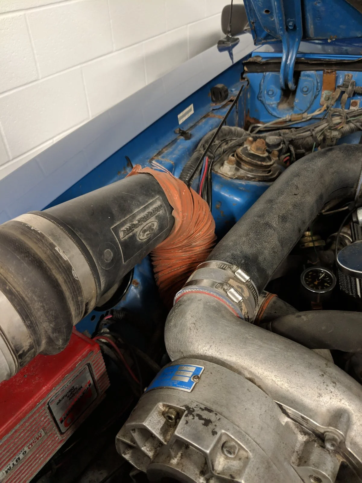

The intake is also in terrible shape. Turns out there was a loose fitting section of the intake. So much that it was pulling unmetered air through. We fixed that and it still idled poorly.
My biggest concern is to figure out why is put together like this. Because it's supercharged I know everything we change here is going to affect how the car runs which is going to require a retune. I would really like to figure out what intake and setup that ProM MAF is supposed to be using because there is a bastard sized filter on now and it's dirty.
We will consider buying the Anderson Vortech air intake setup and maybe buying a new pro m MAF with a new filter if all as fails and send it to a dyno. But we would like to avoid the dyno of possible.

I got something else to add: Have you ever seen a cylindrical shaped air filter put on a fox body? Both ends of this filter are open to atmosphere and you canbut either end onto the MAF housing and the other is covered by this silver cap. Here is the kicker, its held on with 3 coiled springs. This filter does not taper down at all. There is this seperate silver cap that has three holes around it where these coiled springs will hook through. then you push the silver cap onto the end of the filter to seal one end. Then you take the other end of the coiled spring and pull it, and it hooks onto the MAF housing. There is not a part number on this filter but it does say K&N.
The wrong air intake wouldnt cause a poor idle would it?

Definitely not the best intake set-up, like suggested try cleaning the maf.
Looks like you have a rail mounted fuel pressure gauge, take a look at the readings during idle.
Also I would try pulling codes to get a base line on where you're at.
Nothing like the whine of a V1 !
That air filter is one of the first cold air intake filters. They were made like that so several different filter elements could fit different cars. I'd put that thing on a shelf somewhere.
What color are your injectors ? I would think a supercharged 5.0 would want at least 30lb injectors. Blue are 24....red are 30...green is 42 ...orange is 19.
With the idle issue....did you drain the tank ? Old fuel could be causing some of the issue. You guys need to pull the computer so you can tell what tune company the PO was dealing with.
That MAF sensor would be better off replaced. Who knows how long it's been on there.
