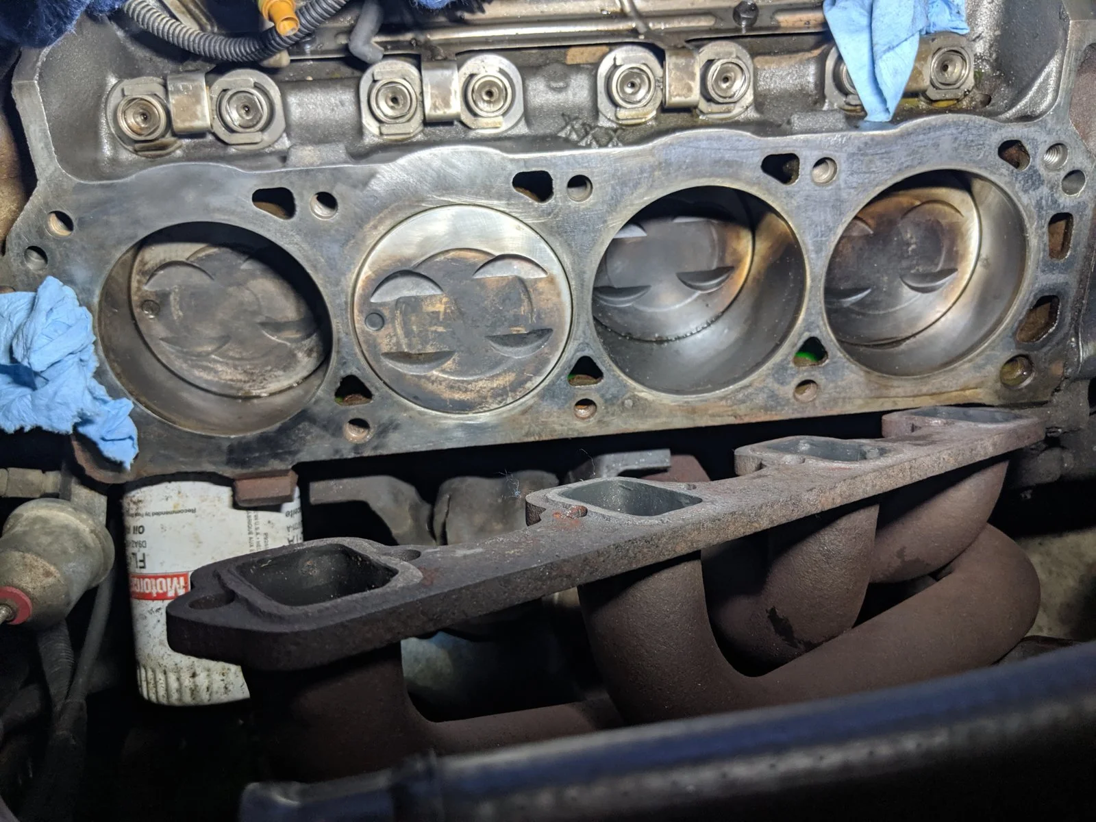

Well I'm pretty sure this one picture sums up what not to do lol
Grit in bores, and dirt, top of deck on cylinder five is roloc, top of six is razor blade and portion of roloc.
And 7 and 8 are straight razor blade.
If I were to do this all over again. I would pull the engine without question. Tape up all cylinder bores, water jackets all that jazz. Soak the deck in gasket cleaner for a few days then rub all this stuff off. Have some gasket cleaner coming tomorrow...I saw it YouTube and it's exactly what I was looking for. I needed something to soften the material on the deck and have the fluid cling to the deck and not run off or evaporate. I'll try gasket cleaner on the rest.
