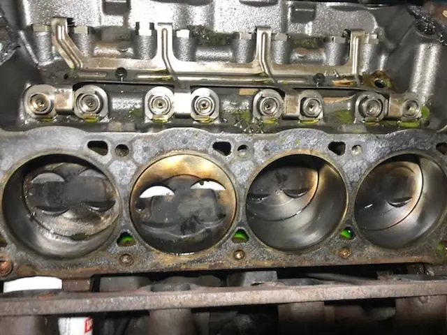

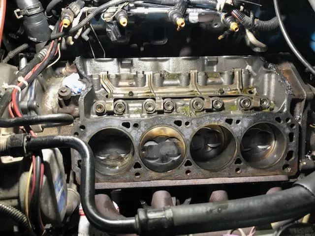

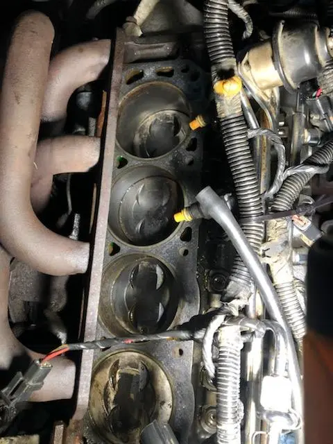

As of last night, we pulled the heads off. Cylinder 2 and 4 had tears on the gasket. But I am still kind of interested in how a antifreeze in the cylinder. The year happened on the top side the of cylinder bore.
I will get the pictures from father in law and pass them along.

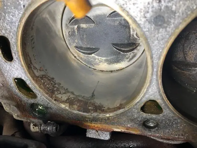

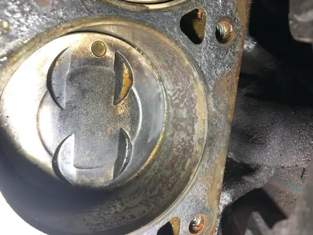

One concerning item on the short block is that there was a defect on cylinder #4 wall. It appeared to be scratch on the wall. You could not feel it with your bare finger. My uneducated guess is because of the antifreeze in that cylinder whenever we were cranking it to get cylinder 1 at TDC, there was rust between the cylinder seal and wall and it just gouged it when cranking.
So now that we have this out, I think we are going to replace the heater core.
We pulled the pipes that go to the heater core and it was extremely nasty. This ties back into my first prognosis with the mustang ac on and heat up , it was not very warm. Could this core be clogged? It was also not taking all the anti freeze that it needed like some antifreeze was stuck and was not coming out. And we tried very hard for weeks to burp it prior to the heads gasket blowing.
Also, it's really sad to pull that engine apart. NEVER EVER PUT REGULAR WATER IN THE COOLING SYSTEM. ONLY DISTILLED. I would really love to clean all the water jackets on the short block but I got no way of doing that.
This block has so much potential to run really well. It's just hampered because it say for so long in fluids that it shouldn't be sitting in.
Now time to throw stuff in the shopping cart.
Pictures attached. that scratch looks really bad :(
