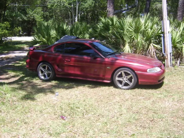

My 94:
I spent lots of time rebuilding the interior of this car last year, but upon really taking a closer look at the undercarriage I can see that it's all beat up pretty good. No rust, but it's just too much work to get the underside of the car looking straight and clean. Plus it has "another" issue I can't talk about.

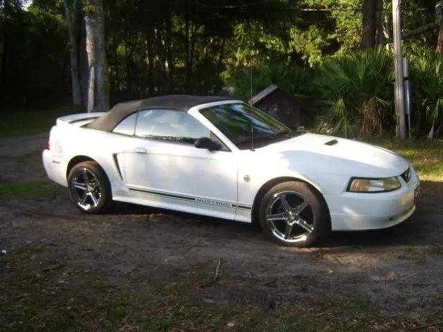

My new 99 V6:
I just picked this car up yesterday and the undercarriage looks brand new! No oil, grease or anything. It has a few cosmetic issues on the body, but for the price I paid I'll live with it. The interior is super clean aside from the front seats. And it just so happens I have 2 mint condition charcoal seats out of a 02 GT in my 94. So they'll be making their new home in the vert after all is said and done.
