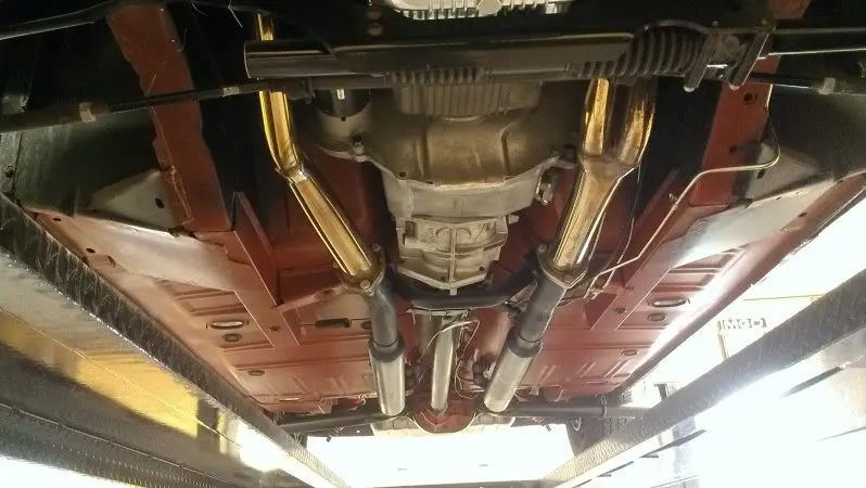

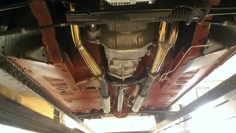

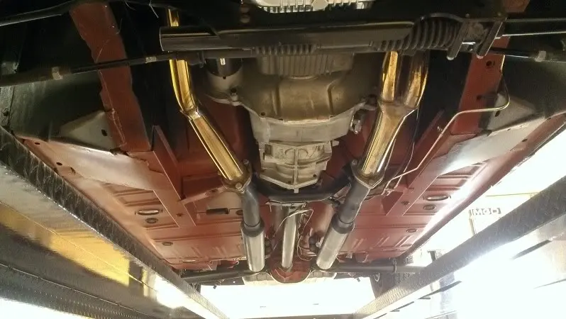

I hung mine from the seat belt bolts, I welded a small bracket onto the muffler body. All of the parts for the hangers were common auto parts store bits, I sliced one apart to make those weld on brackets.

Looks great underneath. Interesting there's no X pipe. I like the red oxide look underneath and am thinking of doing the same with mine so a timely pic!! What's the extra metal welded on angle to the underside of your front frame rail extensions. Is that to provide more torsional support for a high HP motor??

torque boxes. what all 65-66s need
Thanks for the kind words, it took me about 8 months to take it from goey and rusty to that.
(Here is the goo )
The angled flat plate are torque boxes. I added them to both sides just like the 68 cars had, makes a big difference when you connect the rockers to the front frame rails.
I opted out of an H pipe, the 65 shelby cars did not run em (Maybe some "R" cars) , so I did not bother. I could add one, but I dont see much point in it for a mild 289 street car.
