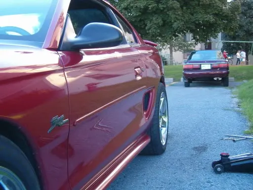

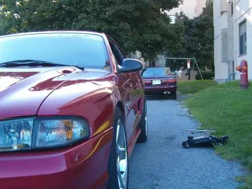

Yeah, put'em on tonight, tell me what you think. Pictures suck, will take better ones tomorrow with clean car and good rear shot
Without
With
These are huge...with 275's on it, I bought 1 3/4 inch spacers...don't know what i was thinking, and wasn't even going to put them on because i figured it would be too far out. But when i tried it tonight, it doesn't look bad at all.
Also, I was worried that at "takeoff", my car would squat. Fortunately, although it does squat a little, i lose traction well before the tires can rub on the inner wheel wells

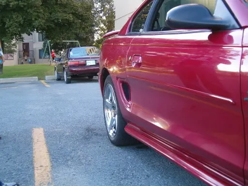

Anyway, side shot so you can see how both front and rear tires are flush with the wheel wells now
Mac-man said:
do you have caster camber plates on it? the wheels still seem to bow in just a bit. the front looks way better with spacers i might add.
The front has no spacers, that's just 275's on there :nice:
No caster camber plates, but for some reason, (don't know why) I'm not getting any uneven wear on my front tires. It's ever since i put on the 275's that it's stopped. I had 255's on the front before, and they wore out completely on the insides within 2 years....didn't like that. But no, these have no caster camber plates, but no issues without'em
