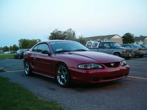

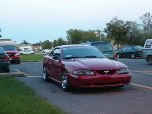

Here's some pics i took a little while ago when I went to pick up the girlfriend from work...and I finally realized, it's my camera that sucks...not me or the lighting. However, you can see the new stance...Pardon the quality :nonono:
One more
No rear shots, they were all too fuzzy....I need to take some pics in broad daylight
