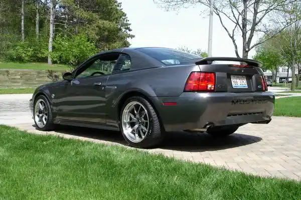

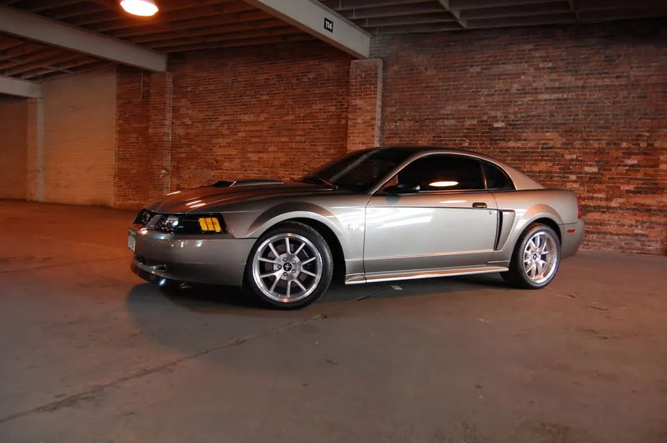

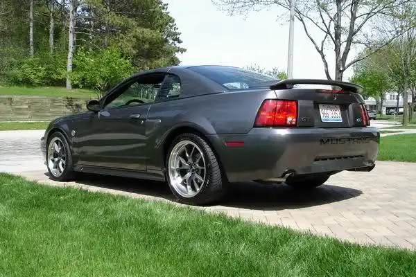

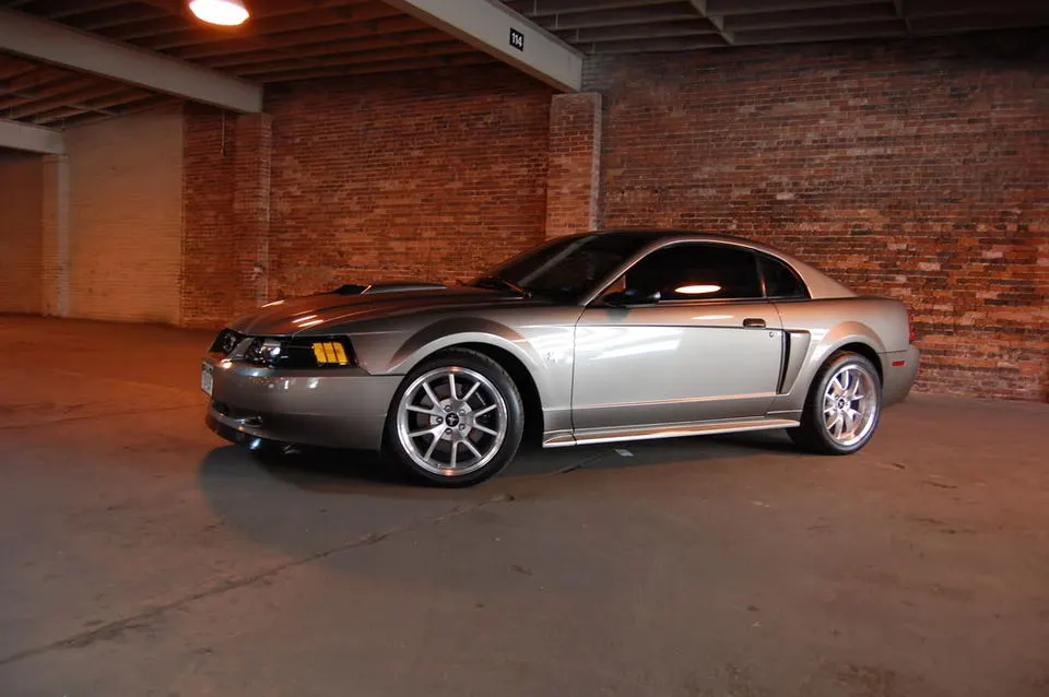

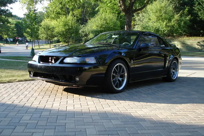

18x9 front 275/35 nitto NT555
18x10 reat 285/35 sumito HTR Z II
no rolling of fenders, no rubbing or cutting or rubber. i ran this combo on my GT and now on my cobra.

18's look really good on New Edge Mustangs. If have the money to spare for larger wheels and more expensive tires, I'd go for it. They won't rub as the people above me have shown you pics with that combo. I do like 315 17's too, so either way it will look sweet.

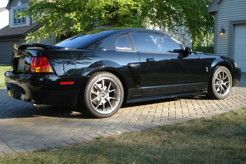

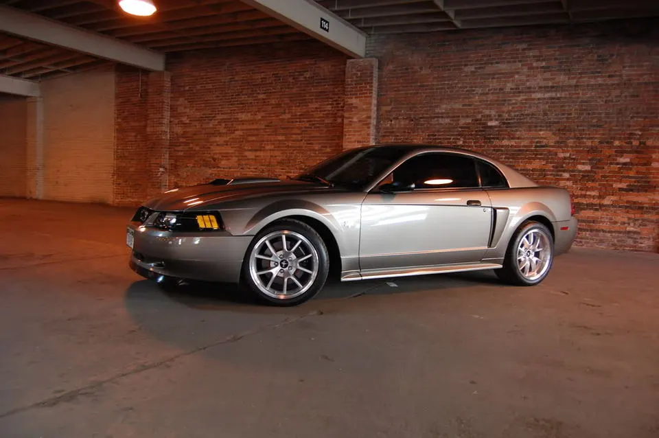

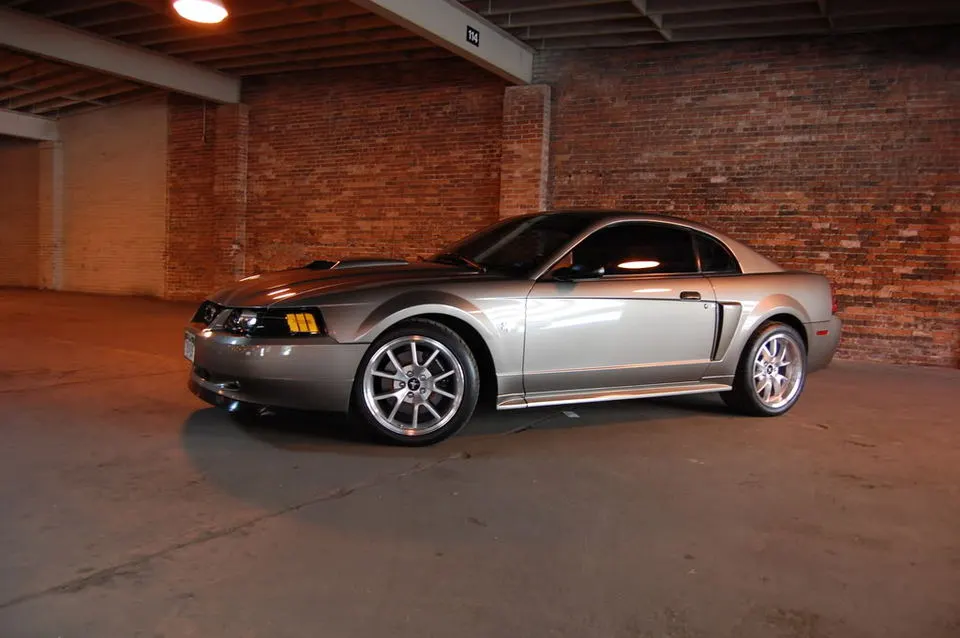

yep, the GT was dropped too.
speedo is fine with no modification. i drove past those "your speed is" signs all the time and it was always right on.
edit: oh yeah, those are eibach sportline springs on the GT, and my cobra has the H&R sport spring.

damn that looks sweet. same color as my car. i was gunna get black bullitts and i was thinkin anthracite fr-500's and those make a good case for them:nice: are those hypercoated or anthracite?
they are anthracite. i think they match the DSG much better than hypercoated and they are easier to take care of.
i really miss that car and the color. if i could of had a DSG 99-01 cobra that is what i would have gotten. someday i will get my cobra painted DSG though

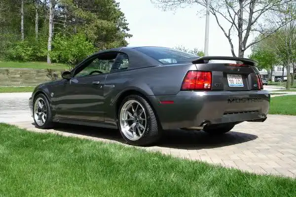

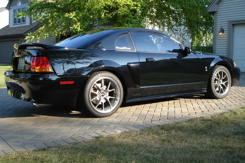

Just thought I would throw my tire combo in the mix. I'm running 255/40/18 and 295/35/18's. Most people will say not to go with the 255's on the front, but mine have been great with no rubbing issues at all. :nice: 18's are the way to go IMO.

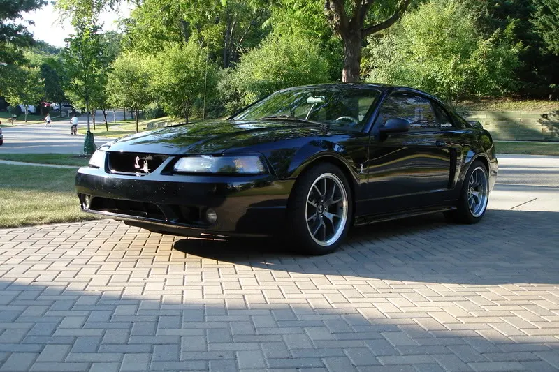

here my 18x10 and 18x9 combo with 1.5 drop
bottom pics kinda dark but tried to get a pic of width of tire from back
