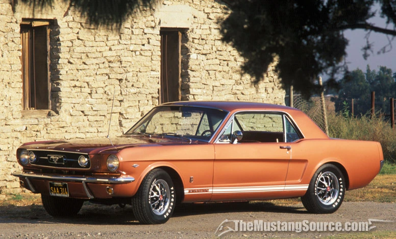

Your car may never have had the quarter chrome. If it was a GT, or came from the factory with the Tiffany stripe, there was no chrome. I'd rather have the stripe.

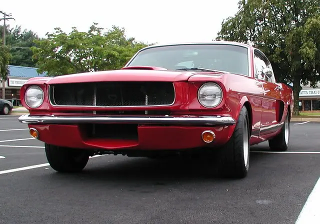

I looked closer and confirmed my suspicions that it has a different "apron?". Mine has this one.
It also has the original valence panel painted for the car so i could swap them no problem. Is there any functional purpose to using the aftermarket one or is it purely astetic? I think i like the original apron better because there is no grill for the opening so you're staring at radiator and metal beams. Plus the top lip is catching on a bold and making the inside of the opening look uneven.

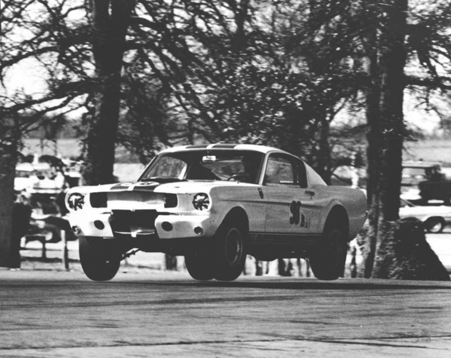

That's what i was thinking! Trying to look like the shelby. But mine's a notch back. I heard that the opening is supposed to cool off disk breaks? Anything on that? I still have drums so that doesn't matter.....yet!
No, the two round holes you don't have were for the brake ducts.
As for ducting air to the brakes, there were factory-installed ducts to cool the front and rear drum brakes on Corvettes. 66-70 Shelbys had cooling ducts to the rear drums.
