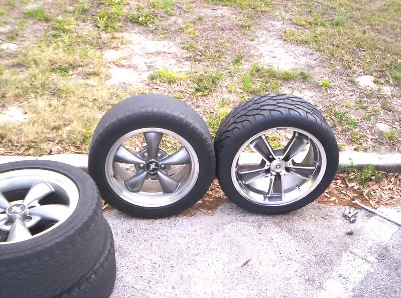

Found some pics. It's not perfectly clear by this picture but they are the same size even with different rim sizes.
