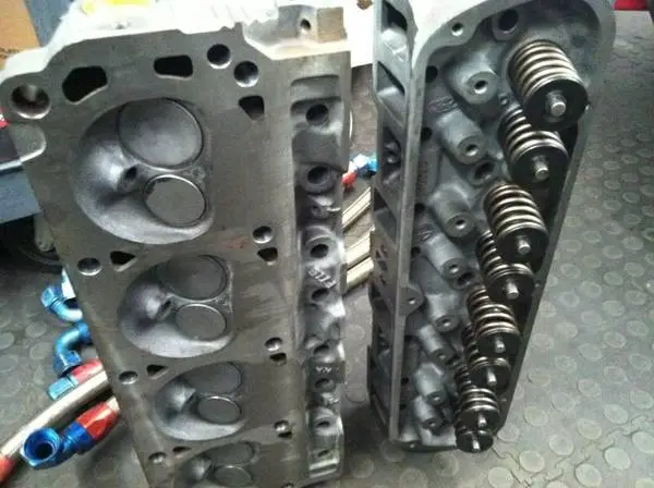

I did find a set of GT40P on local Craigslist. $275 and they look clean. Claims are no cracks and already have performance springs installed.
I'm wondering what the mark on the one exhaust valve is though. I sent a message and am awaiting response. Heres a pic of them.

If the springs were replaced with trick flow or any of the other higher lift springs then I would say its a great deal. I paid $300 for my gt40 heads, $130 for the trick flow upgrade kit, and another $50 to have them cleaned and checked for cracks. I lightly ported the intake/exhaust ports and lapped the valves myself. Of course for a little more you could get better heads but I was in the same boat, go for it.
Top valve on left? Looks like carbon that wasn't cleaned off the valve.
For $275 I'd buy them. Usually $200-250 is the range for heads right off the truck. Toss in aftermarket springs (find out what brand and specs) and that's a good deal.
The 4th bar is there. It doesn't continue down to the deck surface and the light glare hides it. Also, look at the spark plug hole. Comes in more straight rather than angled as on GT40.
These are P's.
