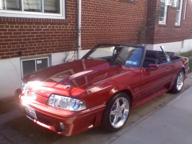

I have 17x9's all around on my 87 Gt. 245's out back and 235's in the front. They rub under full lock in the front so I am sure yours will if you plan to run 245's in the front on your stang. And my car is lowered and the fenders are not rolled.
17x9's with 245's front, 275's back, stock ride height. rubs the front extension just under full lock, rear is tight but a flipped quad makes enough clearance. doesnt look like ide have to roll the fender when i lower the car either, the quad is the closet thing to making it not fit.
