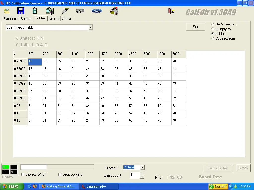

I am somewhat confused on how far I should take my spark tables. I have my base spark table set rather high at the higher end rpm's. I have around 40 at 5000. I can post an image of my table in a while. Should I have my timign set this high? I am not getting any pinging yet. I am running 9.5:1 compression too.
here is the table
Have you changed any of the other spark tables or just this one? I'm pretty sure the EEC uses the lowest values between the tables, someone correct me if I am wrong. To add to that I have no idea about spark so I shouldn't have posted.:rlaugh: I'm going to have my hands full getting a solid tune then i'll move on to spark...:nice:
Originally, I had the altitude spark the same as the base, the bdln all 55's, and the MBT to somewhat mimic the alt + base. Last night I changed all of these tables to 55. I have yet to try anything. I am sure I have way too much spark though.

I null out borderline, altitude, and mbt tables with 55 in all cells
and use only the base table.
In the base table I use the top or greatest load row for WOT conditions.
A rule of thumb is .............
Have maximum advance in by 2500 rpm and that amount will depend
upon the what the combo likes ... or if you hear ping ...
it don't like :rlaugh:
You will find the best WOT performance with maximum values in a range of
32 to 38 degrees.
Iron heads usually like less than Aluminum
When you arrive at your best value for WOT performance .........
Use that value in your tip_in_ retard scalar to kill it ;)
The most important thing to check for is ..........
what you call for in your base spark table is seen in your datalog
Then and only then you know for certain you got it like it should be :nice:
Don't forget ... Dizzy at 10 :)
and
DO NOT use the global adder thing :nono:
Grady
Thanks for your advice. I have killed those tables with 55's. I will have to do some experimenting. I have since back off the timing from the original values. I was talking to my dad and he expained how the workings of timing actually does. It was then I realized that 47 was probably too high. :rlaugh:
