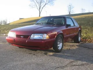

Apr 3, 2008
  • Apr 3, 2008
I have 16x8 Telstars with 5.0" backspacing, and with 255/60/16 MT drag radials they'll be about perfect once I get the rear dropped a bit. Not sure how the section width differs with tires you're looking at

Looks good but do you have any better pictures? Maybe these will work.

NKau
Dec 15, 2001
1,346
37
Jefferson, WI
Apr 3, 2008
  • Apr 3, 2008
I gather that you'd have some rubbing problems if your car was lower stock ride height with 275 series tires on those rims.
