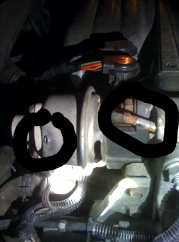

I've done well to analyze all of the veryuseful.com, and pictures of similar problems others have posted. The problem is though? Despite my best efforts, I cannot locate the source for the provided vacuum connection. The previous owner did well to f*%k a lot of the wiring and vacuum up, so much so that I am at a loss to resolve a lot of it. The vehicle started life as a 4 banger, so I'm sure that doesn't help much; his splice jobs and wiring were a joke, at best.
It would also seem that the nipple to my EGR valve is completely damaged?
The car's new nickname is "Captain ******* Drive-Bad."
Thanks to other posters that cleared up many of the other problems by analyzing their posts, and similar thanks to any help anyone else can provide!
I also just moved to Wichita, KS, so if you're anywhere close? let me know.
-Willens

The EGR is missing its vacuum connection. The throttle body is missing the aft water return to the heater feed tube or water port on the lower aft intake mainifold.
